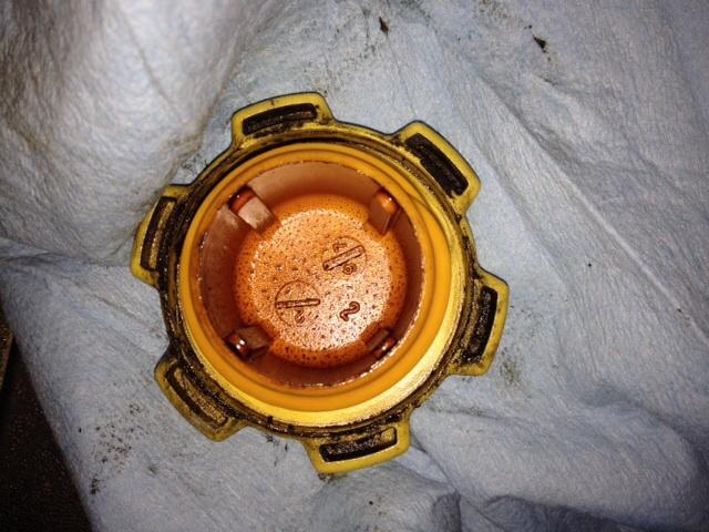

ocei77 Posted August 28, 2014 Share Posted August 28, 2014 +1^ to all of the above. There is a third alternative. Look inside the oil filler cap. It has a year of mfg in it. This is an item that is very seldom lost or replaced, though the possibility exists. O. Link to comment Share on other sites More sharing options...

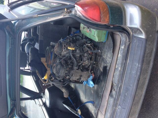

pginter96 Posted August 28, 2014 Author Share Posted August 28, 2014 (edited) So... '97? Should also mention that due to my lack of engine hoist its stuck in my Outback for a few days until I can borrow my buddy's. Surprisingly I got about 20 mpg hauling it around today. Feels like Im doing a wheelie everywhere... Well as you can see by the pic, its right on top of where the vin should be. Also, are oil pans the same on all years of EJ22? Want to get it covered up sooner than later. EDIT- Sorry non-mobile viewers, the pics are sideways when I upload them here. I cant figure out computers for the life of me, so... Sorry 'bout that.... Edited August 28, 2014 by pginter96 Link to comment Share on other sites More sharing options...
86BRATMAN Posted August 28, 2014 Share Posted August 28, 2014 (edited) You should be able to see the VIN stamping from the back seat area. It's on the side of the bellhousing, up a little from the bottom stud. That is definitely 96-98 though by the valve covers. The oil cap could be accurate in saying it's a 97/98 motor, or it could have been swapped at some point. Either way as far as gaskets and such go there is no difference in these years, and yes any ej22e oil pan will work. You can even use an ej25 oil pan as long as you swap the pickup tube and remember that it will hold about a half a quart more oil each change. Edited August 28, 2014 by 86BRATMAN Link to comment Share on other sites More sharing options...
pginter96 Posted August 28, 2014 Author Share Posted August 28, 2014 On 8/28/2014 at 2:16 AM, 86BRATMAN said: You should be able to see the VIN stamping from the back seat area. It's on the side of the bellhousing, up a little from the bottom stud. That is definitely 96-98 though by the valve covers. The oil cap could be accurate in saying it's a 97/98 motor, or it could have been swapped at some point. Either way as far as gaskets and such go there is no difference in these years, and yes any ej22e oil pan will work. You can even use an ej25 oil pan as long as you swap the pickup tube and remember that it will hold about a half a quart more oil each change. Awesome, thanks. I tried to get in there. Lifted the engine as much as I could (until a bolt went through the mat and deck lid underneath into the "smugglers area"). Saw some flat spaces but couldnt find a VIN. I would flip the engine upright but not without an oil pan. Link to comment Share on other sites More sharing options...

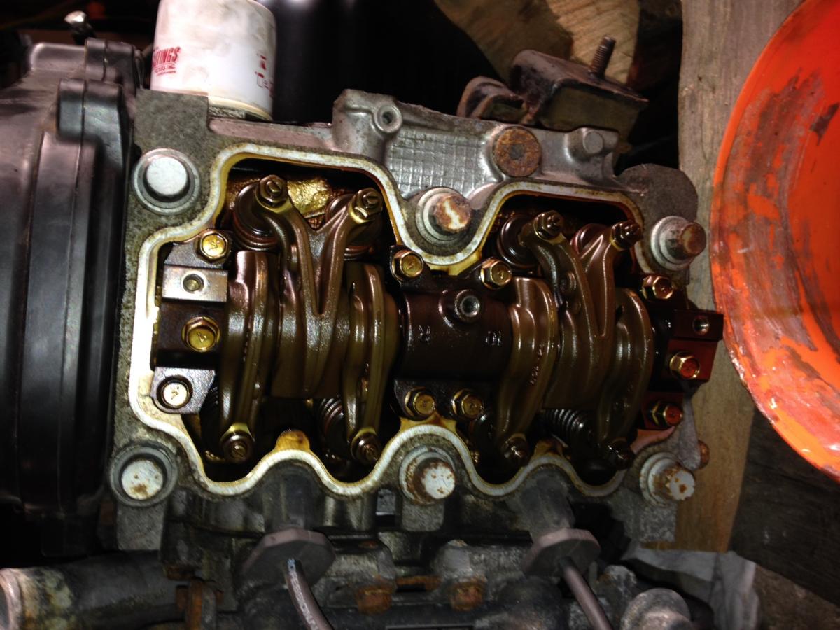

Fairtax4me Posted August 28, 2014 Share Posted August 28, 2014 Pull one of the valve covers and check it the lash adjusters. If it has hydraulic adjusters its a 96. 97-98 have screw type adjusters. Link to comment Share on other sites More sharing options...
pginter96 Posted October 7, 2014 Author Share Posted October 7, 2014 two flat spots on the passenger side of the block. no numbers... Link to comment Share on other sites More sharing options...
pginter96 Posted October 7, 2014 Author Share Posted October 7, 2014 screw type adjusters Link to comment Share on other sites More sharing options...

johnceggleston Posted October 8, 2014 Share Posted October 8, 2014 (edited) on the edge of the bell housing between the guide pin and the engine stand bolt. Quote two flat spots on the passenger side of the block. no numbers... Quote screw type adjusters 96 - 98 ej22 SOHC. with single port exhaust. Edited October 8, 2014 by johnceggleston Link to comment Share on other sites More sharing options...
