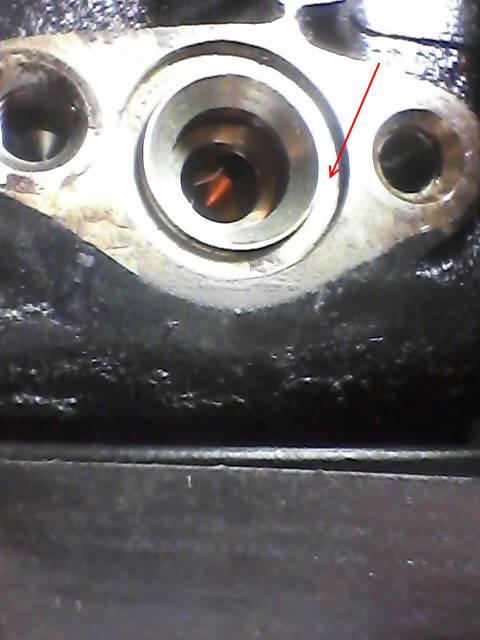

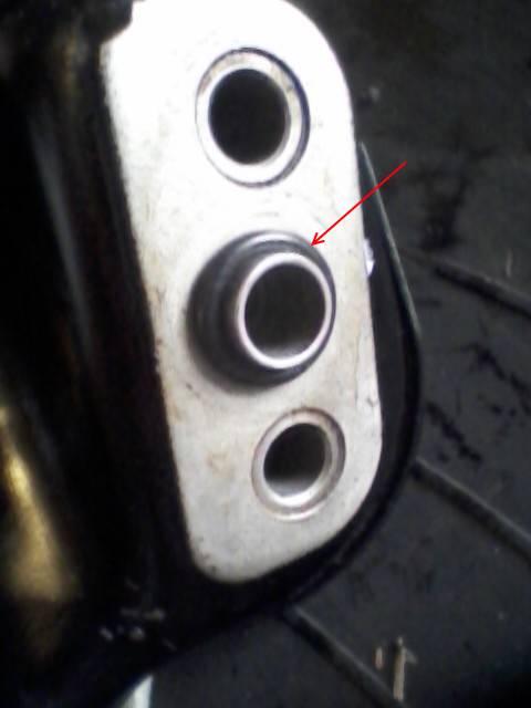

Now the o-ring seems to have a cone shape.  Is that a specific type of o- ring or is it just shaped that way from years of installation ?  Anyone know the specific size for replacement?
Also, it almost looks as though there are supposed to be 2 o-rings:
One around the nipple on the reservoir, which is where the original one was found:
And a second in a groove on the pump
Edited by Dee2
31263GA651 is a repair kit listing, likely NLA. The o rings are not listed individually either. Only time I get blank looks from Subaru parts is when I ask for PS O rings. Diagrams show seals just where you found them. Never sean triangular cross sections either. Think you guess correctly - mis shapen in service.I just use a seal, bearing supplier to make an educated guess on o rings

Triangular O-rings are just deformed over time due to the shape of where they are placed (same as the O rings into the A/C compressor). They start off round...
So I put in the o-rings, I put in two instead of just the one, I'll see how that works.  Hopefully,  this will solve my steering pump leaks, time will tell.  Took it out for a test drive and all seems good.  I'm calling this job done.

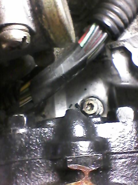

As a side note,  I had a wire bundle behind the pump that was covered in plastic corrugated tubing.  When I touched it crumbled like a cracker.  So I had to run to the store and get some new tubing so I could get it covered while it was exposed.  It's amazing how brittle some of this old plastic gets.
As always, thanks for the help, it made the job much easier.
