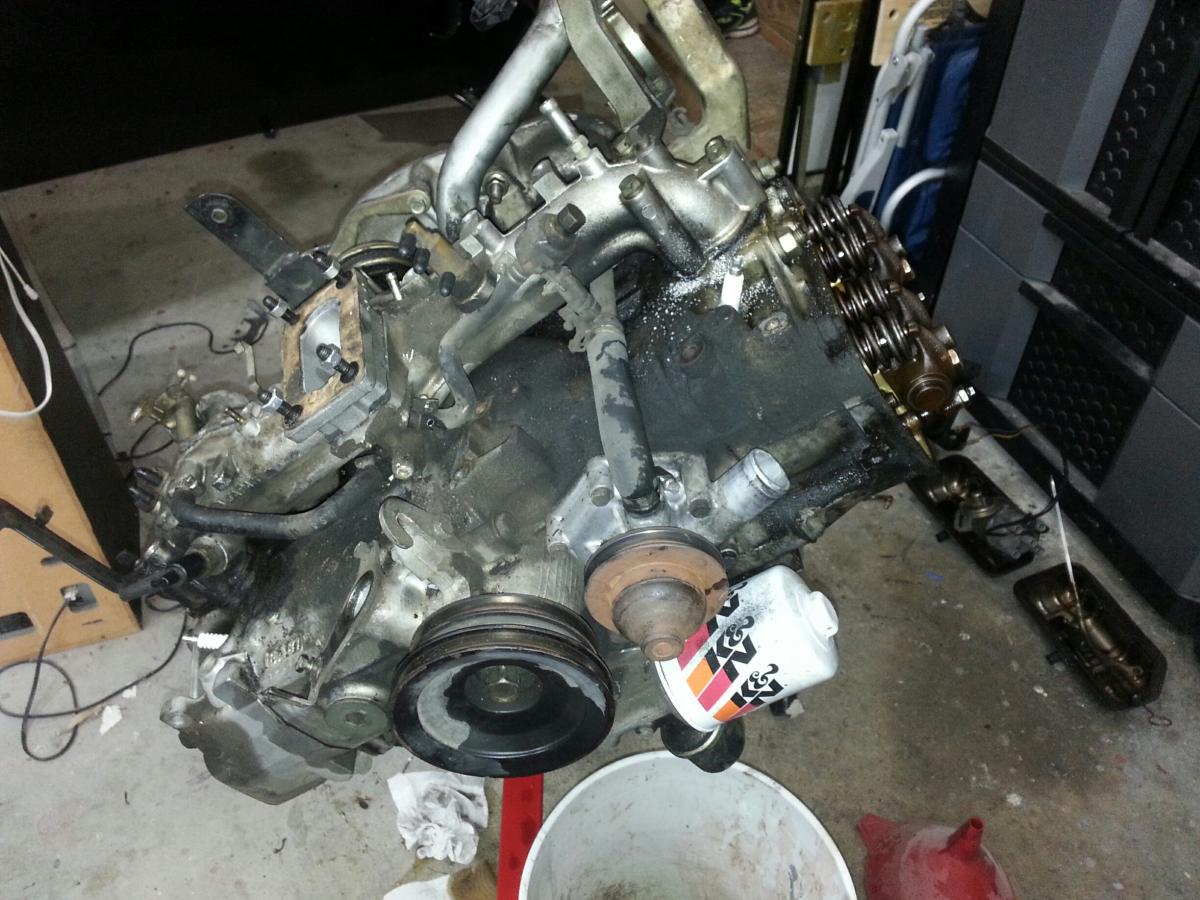

I bought the rust free BRAT out of CA a few months ago and while it ran good it would (as most EA81s do) run out of steam on the upper end thanks to the terrible carb. My plan was to do a weber swap until I had some more time to spare and do a nice build. I installed the weber and decided to clean up the brackets and in doing to an intake bolt snapped off, since that might leak I knew I had to extract it and having to extract it meant risking more bolts breaking off so I decided to just go ahead and pull the engine and do the build. The engine had 223k on the clock and it was greasy on the outside but clean and within specs/clearances on the inside.

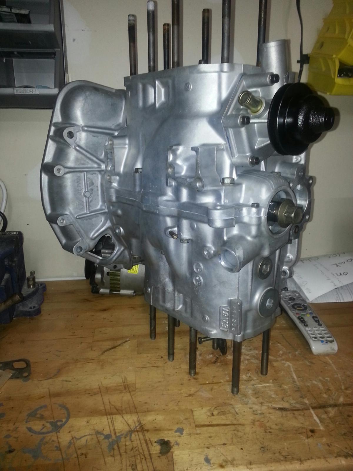

Cleanup after hot tanking was really helped by a soda blaster I picked up at harbor freight of all places. It is like having a magic eraser to get you back to factory fresh aluminum. After hunting around a bit for a hydro cam to regrind into a solid lifter cam and an EA82 intake manifold I am now into the re-assembly.

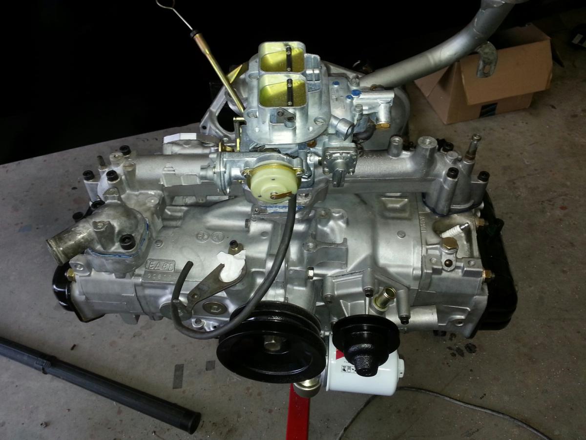

This is how it sits now, just need to do the PCV plumbing and filter, distributor, and a few minor odds and ends before installing. The truck is headed off to the paint shop next week to get showroom fresh, I decided to have them do the engine bay as well so I am gutting that totally and will lay in a new hidden harness, there is so little left anyway once you de-emissions the truck that it makes no real difference to go all the way.
The one thing I am torn on, is should I use the stock air cleaner and re-install the spare so that at first glance it looks all stock, or go with the bare look and the aircleaner that comes with the weber. I change my mind about twice a day.

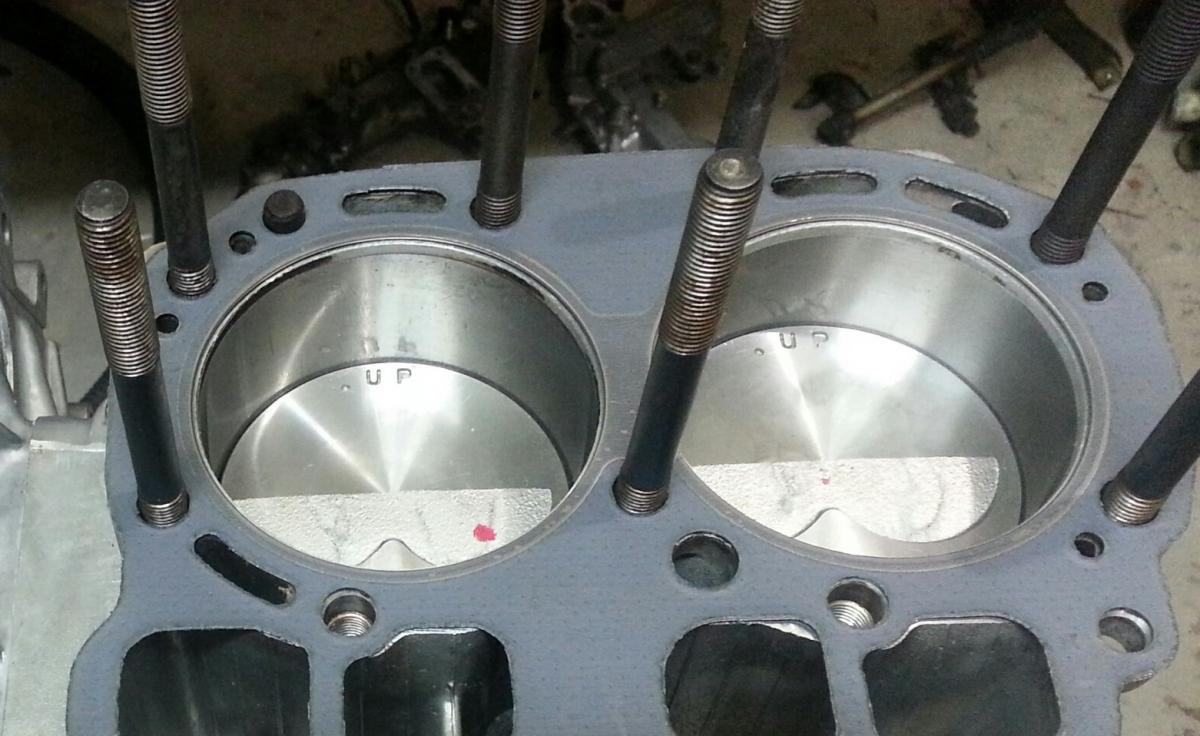

too late for pics of the EA82 spfi pistons ? tops, measures from pin to top when they were out? new? You must be able to dscribe the piston tops ? Not flat top?
One set of depression that look to clear valves, and at an angle, and no other deprtesion, or two separate depression 'sets' or shapes?
