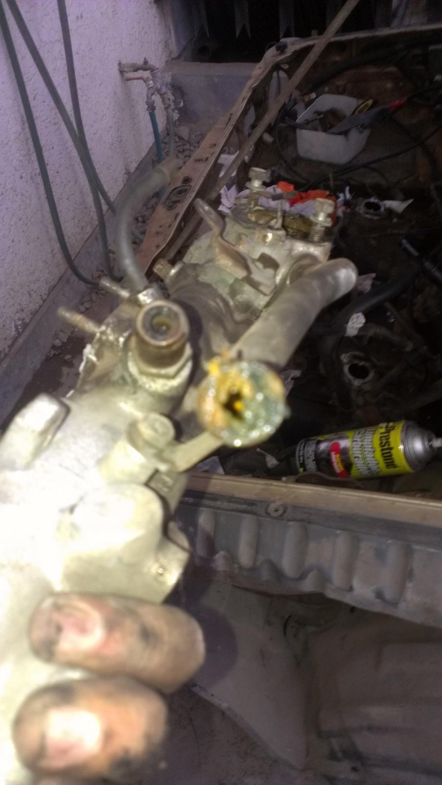

Tommy1b Posted October 13, 2014 Share Posted October 13, 2014 Maybe this is your problem ... Link to comment Share on other sites More sharing options...
Tommy1b Posted October 13, 2014 Share Posted October 13, 2014 Or This ..... Link to comment Share on other sites More sharing options...
