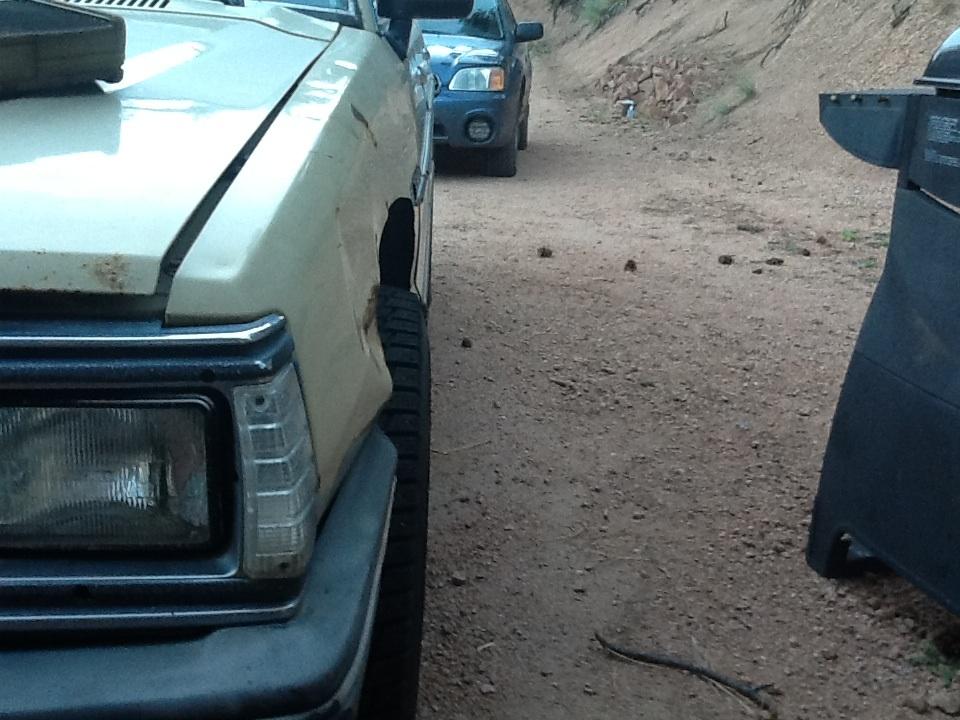

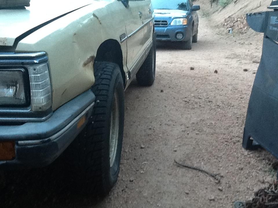

spazomatic Posted October 20, 2014 Share Posted October 20, 2014 (edited) Why sure! Just took these pics, and comparing them to your photos, it doesnt look like mine stick quite as far. Theyre 14s from a little isuzu pickup. They stick out far enough that i had to take 3" from the front fenders, and 1.5" from the rear. Edited October 20, 2014 by spazomatic Link to comment Share on other sites More sharing options...
spazomatic Posted October 20, 2014 Share Posted October 20, 2014 Heres another, looking straight down at it (obviously) Link to comment Share on other sites More sharing options...
dannycisneros Posted October 21, 2014 Author Share Posted October 21, 2014 Yeah those look just fine I don't like how mine stick out so far. I don't really even want them. Link to comment Share on other sites More sharing options...

Gloyale Posted October 22, 2014 Share Posted October 22, 2014 Why sure!image.jpgimage.jpg Just took these pics, and comparing them to your photos, it doesnt look like mine stick quite as far. Theyre 14s from a little isuzu pickup. They stick out far enough that i had to take 3" from the front fenders, and 1.5" from the rear. Yeah those look just fine I don't like how mine stick out so far. I don't really even want them. Remember, EA81 stock Wagon wheels had about 20mm deeper dish to them than the EA82 wagon wheels. So wheels that fit well on an EA81 (isuzu, Mitsi) will stick out about an inch more on EA82. "chevy" wheels and probably those aftermarkets you got Danny are the deepest off all. The nissan and toyoyas that I posted are the most "tucked" ones i have found. The Isuzu(chevy luv) and Misubishi wheels stick out a bit further. The white waong in the background of my second pic has Isuzu wheels, and they stick out a hair on EA82s but tuck well on EA81's Link to comment Share on other sites More sharing options...
dannycisneros Posted October 22, 2014 Author Share Posted October 22, 2014 I really like the ones on the white wagon in the background! I want to find something that doesn't stick out as far but I might just deal with it for now sadly since it seems I don't have much interest on these wheels. Link to comment Share on other sites More sharing options...
