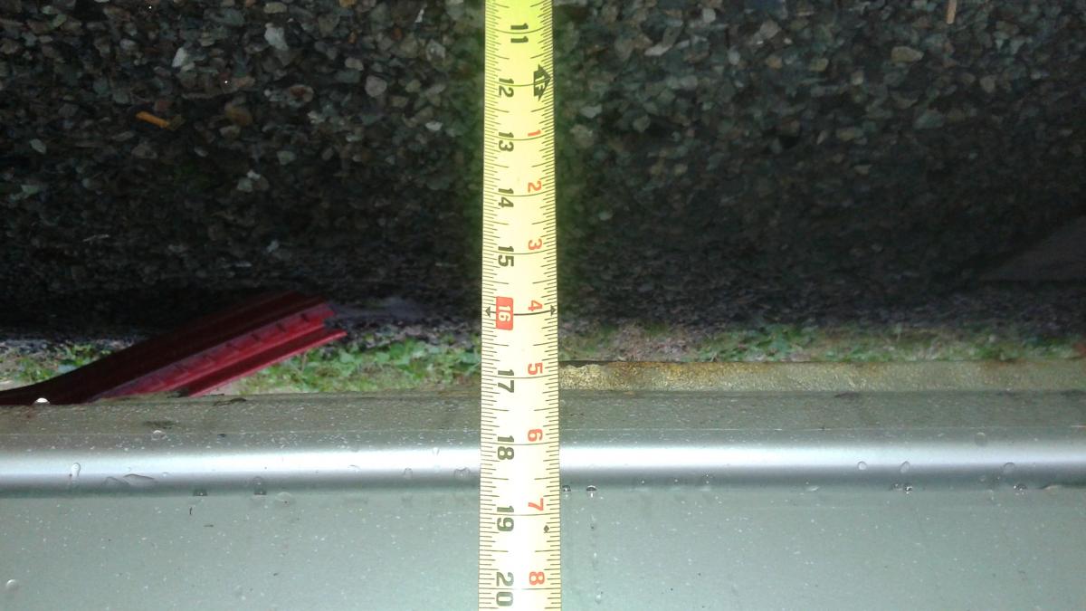

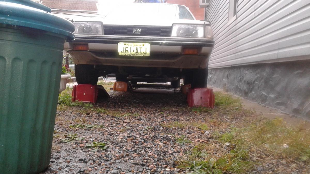

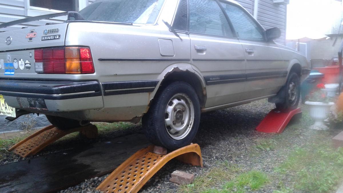

l75eya Posted November 1, 2014 Author Share Posted November 1, 2014 Up on ramps Link to comment Share on other sites More sharing options...
l75eya Posted November 1, 2014 Author Share Posted November 1, 2014 (edited) This should be enough space. Don't know why it's upside down. Almost a foot and a half. Edited November 1, 2014 by l75eya Link to comment Share on other sites More sharing options...

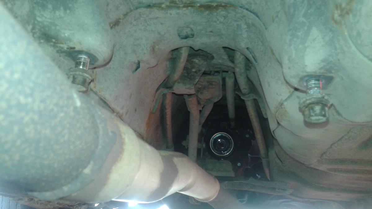

l75eya Posted November 2, 2014 Author Share Posted November 2, 2014 (edited) While it's fresh in my head,Drain transRemove four bolts attaching drive shaft to rear diffRemove two bolts on center carrier bearingSlide drive shaft outRemove roll pins from front axlesHop in the car and remove interior trim from shiftersRemove Phillips screws from inner bootSlide boot up and undo bolts for shifter linkagesDrop linkagesBack under the car remove bolts for trans pitch rod mount and shifter mountDrop exhaustRemove bellhousing bolts and shift the trans back and down and out! Be careful! Edited November 2, 2014 by l75eya Link to comment Share on other sites More sharing options...
l75eya Posted November 2, 2014 Author Share Posted November 2, 2014 (edited) Reserved. Edited November 2, 2014 by l75eya Link to comment Share on other sites More sharing options...

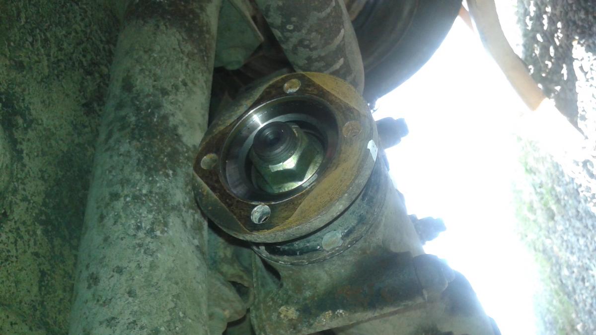

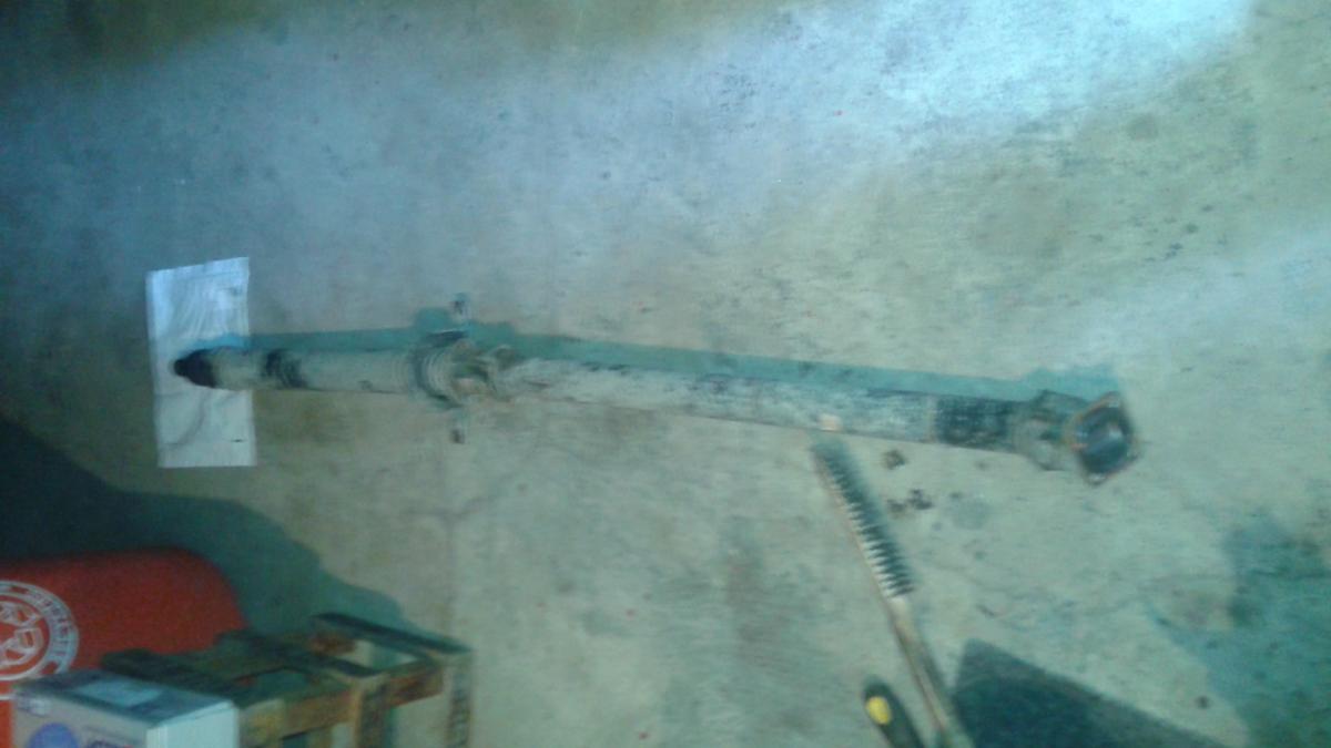

l75eya Posted November 2, 2014 Author Share Posted November 2, 2014 Drive shaft removed.Axles can remain attached to the wheels. Once the bellhousing is loose and you can shift the transmission around, you can remove the axles from the trans stubs entirely.Remove all interior trim around the shifters. Take off the phillips screws holding the rubber boot on and then undo the linkages.12MM bolts. After they are all removed you can climb under the car and unbolt the pitch rodSeparating.Finally. Link to comment Share on other sites More sharing options...

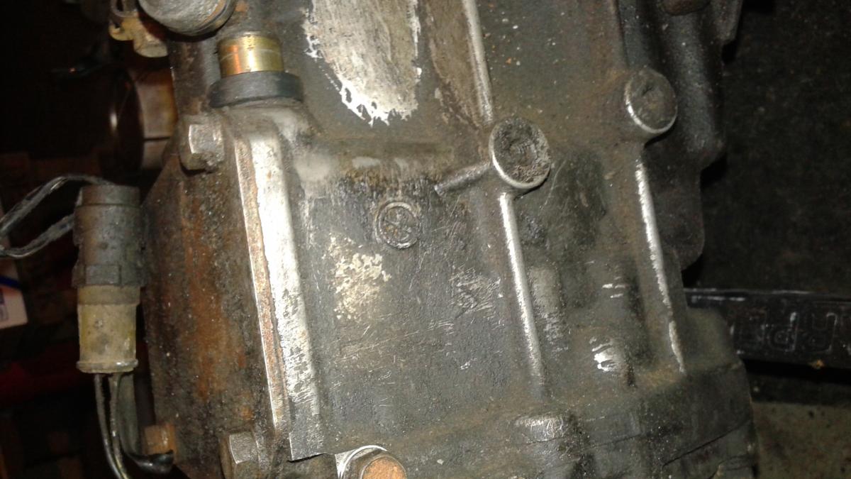

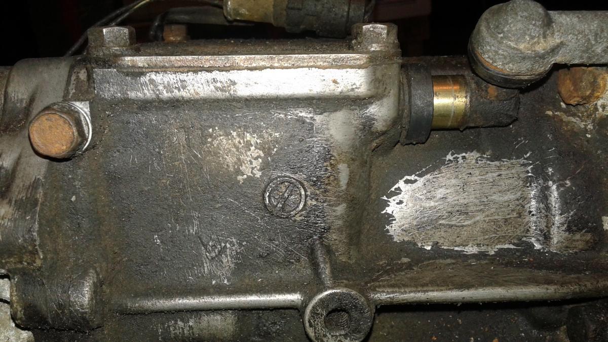

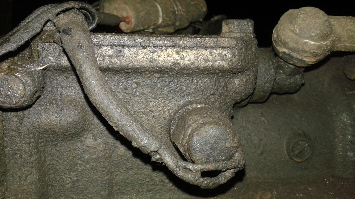

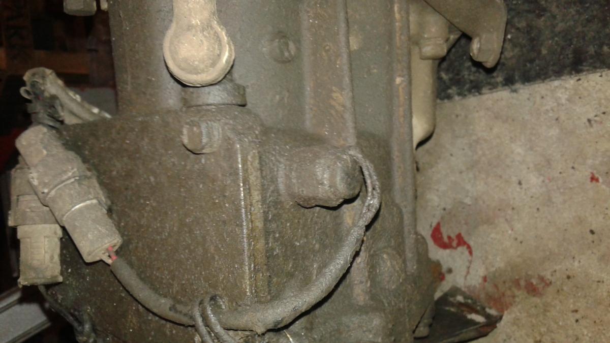

l75eya Posted November 3, 2014 Author Share Posted November 3, 2014 Can anybody explain why theres a difference between my dual range and the replacement? In the pictures, mine has the plug on the side. That same location on the replacement has no plug and what appears to be a circle with a cross through it like on a no smoking sign. Supwitdat? Link to comment Share on other sites More sharing options...
l75eya Posted November 3, 2014 Author Share Posted November 3, 2014 For what it's with mine is an 87 and the junkyard trans is out of an 85. Link to comment Share on other sites More sharing options...
Gloyale Posted November 3, 2014 Share Posted November 3, 2014 Yeah......that's the Hi/Lo light indicator switch. The 85 had the switch mounted to the D/R lever under the shifter console.... in 87....they changed and added the switch to the side of the trans....... In 88....they went SPFI and added a Nuetral switch to the trans as well.... so.....For U.S market, EA82 series....non-turbo Dual range subi trans this is the breakdown..... 85,86....2 switches.......Reverse, and 4wd 87 Fed.(carbed).....3 switches........Reverse, 4wd, Hi/Lo 87 Cali, and 88,89 all..(SPFI)......4 switches........Reverse, 4wd, Hi/Lo, and Nuetral 2 Link to comment Share on other sites More sharing options...
l75eya Posted November 3, 2014 Author Share Posted November 3, 2014 Thanks, G. Guess I'll try and figure out how to wire it up.. So the connections on the 85 are for the 4wd lights and reverse. The lever switch would illuminate the lo light? Link to comment Share on other sites More sharing options...
Gloyale Posted November 3, 2014 Share Posted November 3, 2014 Thanks, G. Guess I'll try and figure out how to wire it up.. So the connections on the 85 are for the 4wd lights and reverse. The lever switch would illuminate the lo light? Correct......the microswitch mounts to the D/R lever......IIRC...the microswitch is the same type as the one on the side of the Heater box for activating the A/C when the "vent" button is pushed. so maybe you could scavenge the one from your loyale? Mount it to the shifter......run the wires from the Trans connector into the cab to the microswitch. Link to comment Share on other sites More sharing options...
MR_Loyale Posted November 3, 2014 Share Posted November 3, 2014 Can anybody explain why theres a difference between my dual range and the replacement? In the pictures, mine has the plug on the side. That same location on the replacement has no plug and what appears to be a circle with a cross through it like on a no smoking sign. Supwitdat? That means you gotta stop smoking. Link to comment Share on other sites More sharing options...
