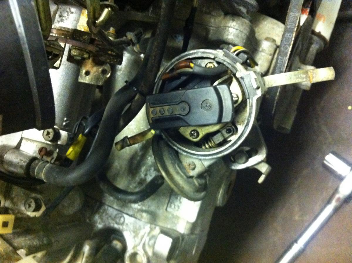

jono Posted October 30, 2014 Share Posted October 30, 2014 get #1 cylinder on TDC and then take a pic to show us where the rotor points - means have dizzy cap off please.What direction have you set the firing order around the cap ? Clock or anti clock ? Link to comment Share on other sites More sharing options...

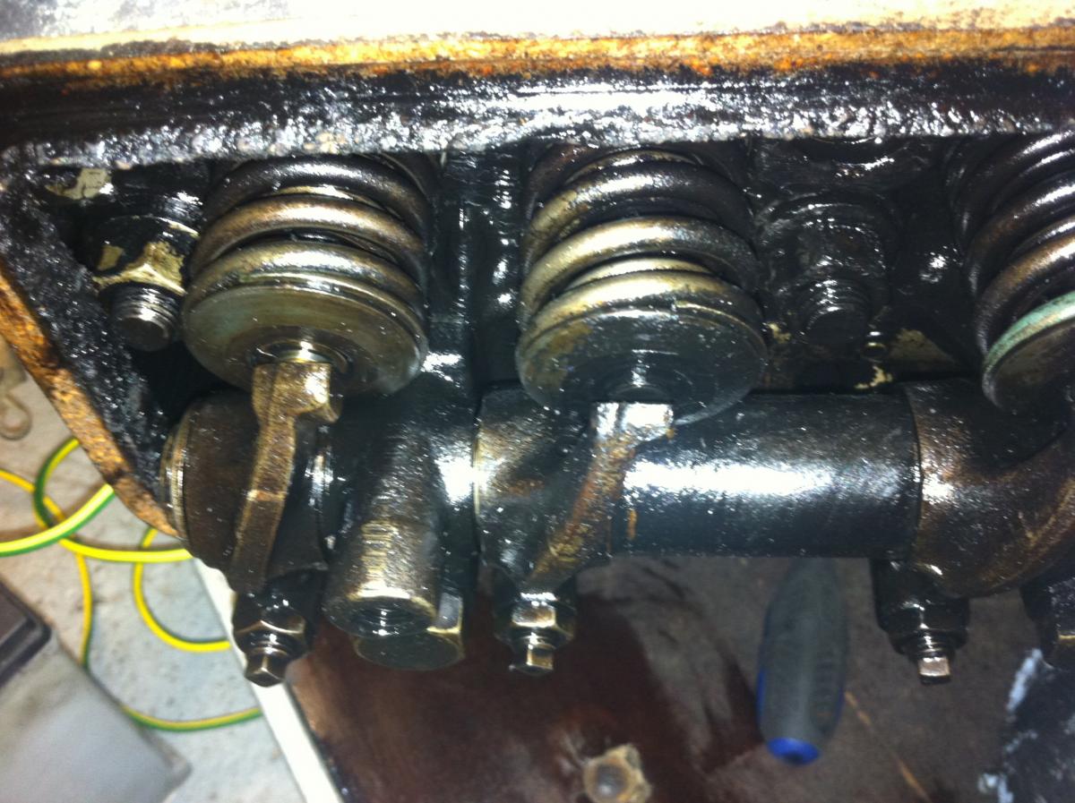

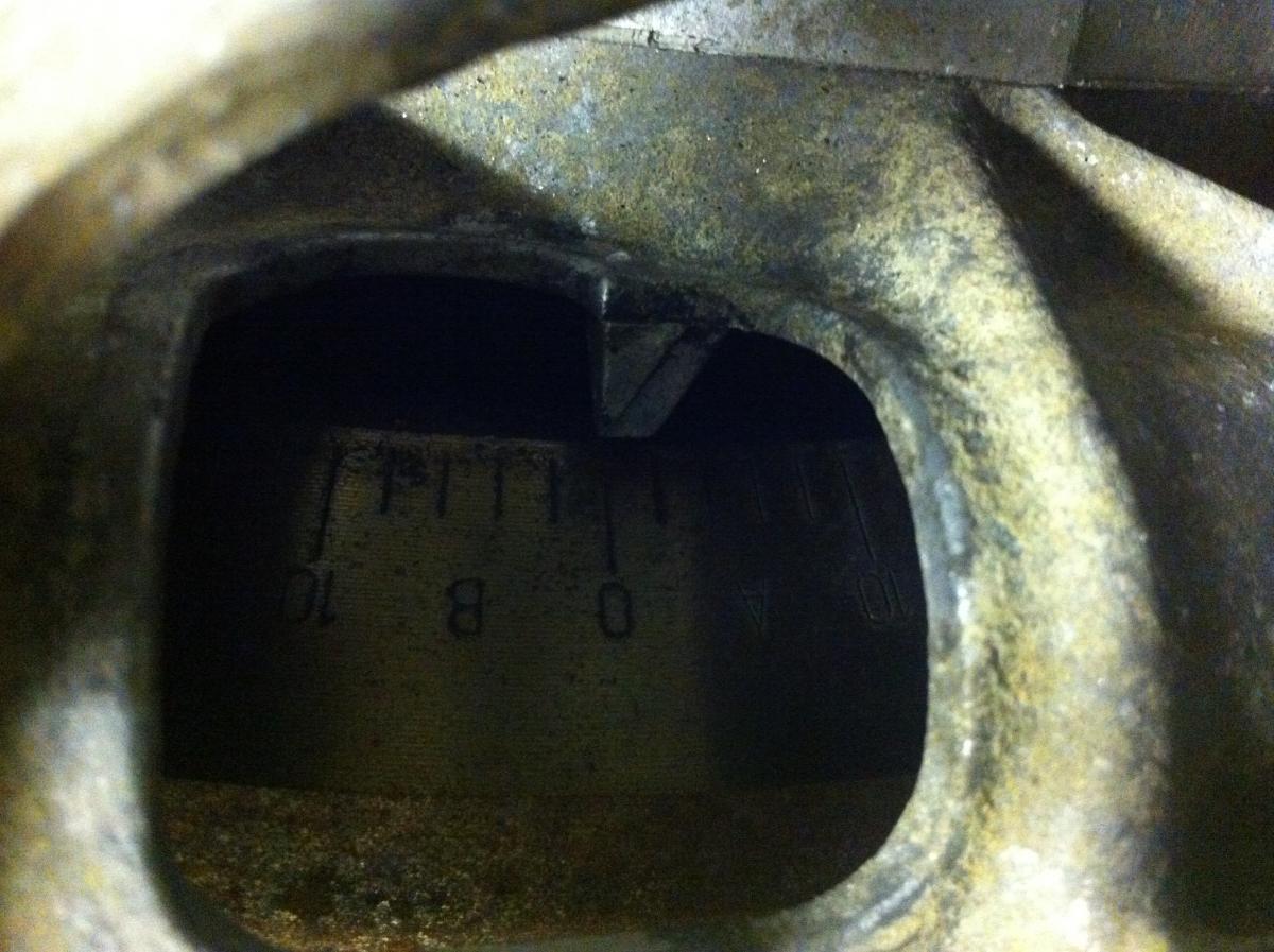

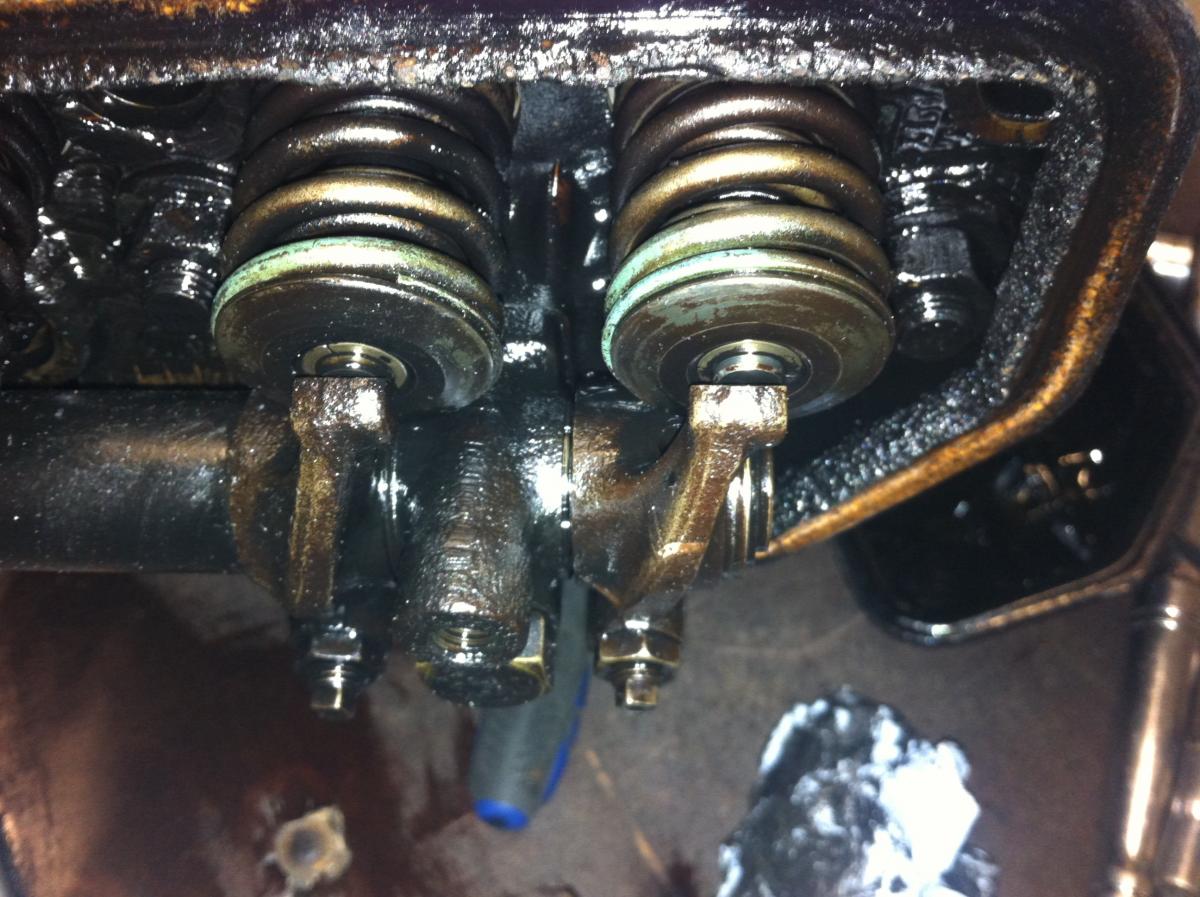

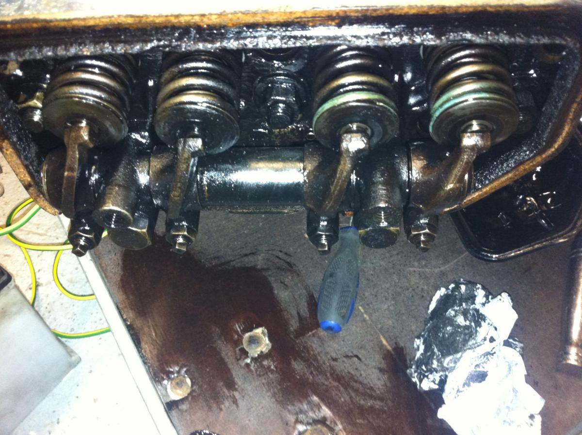

tucka786 Posted October 30, 2014 Author Share Posted October 30, 2014 I managed to get the engine to fire but not run even for a few seconds . Firing order is 1-3-2-4 counter clockwise . I have been using easy start in the carb. I have attached some pics of my ignition timing settings and of the valves . Link to comment Share on other sites More sharing options...
tucka786 Posted October 30, 2014 Author Share Posted October 30, 2014 Timing at flywheel Link to comment Share on other sites More sharing options...
tucka786 Posted October 30, 2014 Author Share Posted October 30, 2014 Timing Link to comment Share on other sites More sharing options...
tucka786 Posted October 30, 2014 Author Share Posted October 30, 2014 Rotor position at TDC Link to comment Share on other sites More sharing options...
tucka786 Posted October 30, 2014 Author Share Posted October 30, 2014 Position of valves at TDC for #1 and #3 cylinders Link to comment Share on other sites More sharing options...
tucka786 Posted October 30, 2014 Author Share Posted October 30, 2014 Valves for #1 Link to comment Share on other sites More sharing options...
tucka786 Posted October 30, 2014 Author Share Posted October 30, 2014 Valves for #3 Link to comment Share on other sites More sharing options...
tucka786 Posted October 30, 2014 Author Share Posted October 30, 2014 Pics of the valves are as they are at timing set at TDC. If something is not right I hope someone can chime in with some advice . Thanks. Link to comment Share on other sites More sharing options...

silverback Posted October 31, 2014 Share Posted October 31, 2014 With the #1 piston at TDC, on the compression stroke, the intake and exhaust valves will have clearance to the rocker arms.. Checked with feeler gauges and calibrated fingers.........( grab and wiggle ). Did you set/recheck the valve lash? The distributor rotor points to the #1 spot on the distributor cap. I always advise against starter fluid because it is an explosion in the cylinder, it is dry and flashes off lubricating oil, and is extremely hard on rings. 99.9% of people use too much. TDC is a reference point for checking settings. Change the timing for starting/running. I hope you have a good 'bench'. Link to comment Share on other sites More sharing options...
