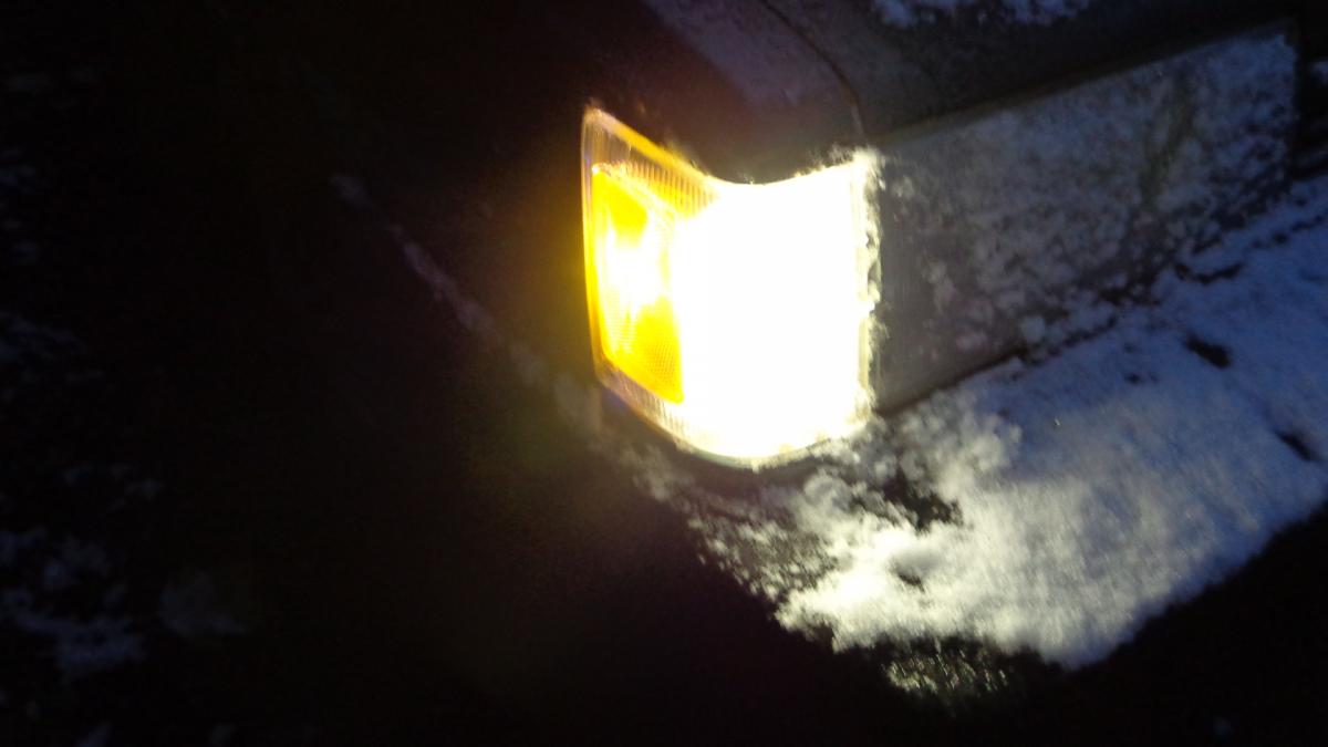

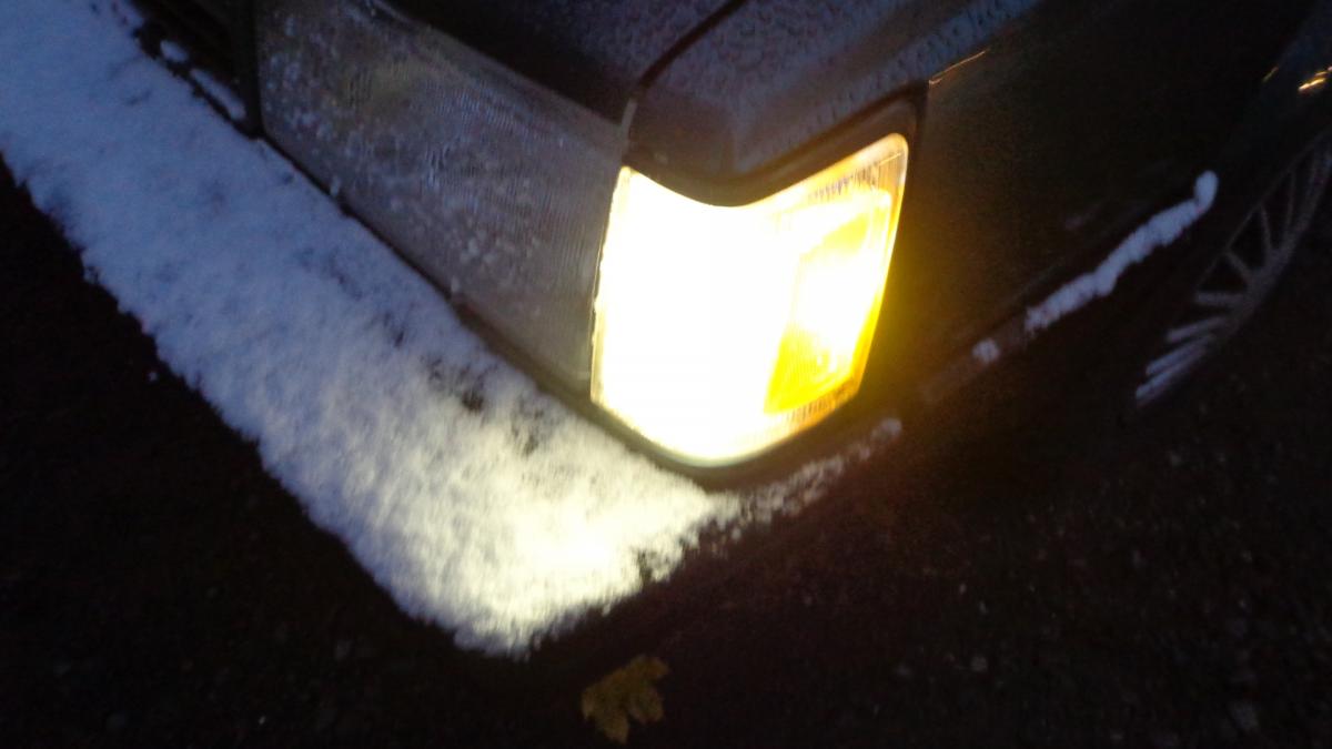

SubaruJawn Posted November 13, 2014 Author Share Posted November 13, 2014 LED upgrades. Front clearance lights and marker lights are now LED. Very Very Bright ! 1 Link to comment Share on other sites More sharing options...
tincan Posted November 14, 2014 Share Posted November 14, 2014 LED upgrades. Front clearance lights and marker lights are now LED. Very Very Bright ! Those are the only lamps in my car that aren't LED (well, minus dash, interior, and headlights) You guys got snow?! Link to comment Share on other sites More sharing options...
SubaruJawn Posted November 15, 2014 Author Share Posted November 15, 2014 Those are the only lamps in my car that aren't LED (well, minus dash, interior, and headlights) You guys got snow?! i am upgrading to LED at very slow rate. (step 1 of modernizing) yeah we got snow not a lot but its snow. Link to comment Share on other sites More sharing options...
tincan Posted November 15, 2014 Share Posted November 15, 2014 i am upgrading to LED at very slow rate. (step 1 of modernizing) yeah we got snow not a lot but its snow. It's not a bad idea to be honest. Just be sure you use bulbs that don't have the circuit boards exposed, as they get moisture in them and corrode easily. Just as well, for the turn signals, be forewarned that the relays in the car do not support these bulbs; the result is the blinkers flashing at a faster rate (as if you had a light out). Find some ballasts to correct it or simply ignore it. Link to comment Share on other sites More sharing options...
SubaruJawn Posted November 15, 2014 Author Share Posted November 15, 2014 It's not a bad idea to be honest. Just be sure you use bulbs that don't have the circuit boards exposed, as they get moisture in them and corrode easily. Just as well, for the turn signals, be forewarned that the relays in the car do not support these bulbs; the result is the blinkers flashing at a faster rate (as if you had a light out). Find some ballasts to correct it or simply ignore it. yeah use less electricity and are brighter, i get my LED from SuperBrightLEDs.com and the other 2 at walmart. i am aware of the Turn signals they have an L.E.D Flasher for my Loyale and i must make sure the bulbs are the same color as the lens. amber for turnsignals and red for brake lights. Link to comment Share on other sites More sharing options...

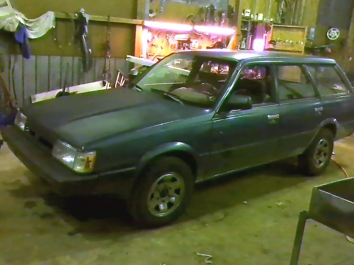

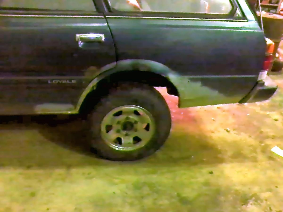

SubaruJawn Posted December 2, 2014 Author Share Posted December 2, 2014 Got some Rims for my Loyale. slowly yet surely getting hem to fit, sucks when you can only do work on the weekends. Preview: 1 Link to comment Share on other sites More sharing options...

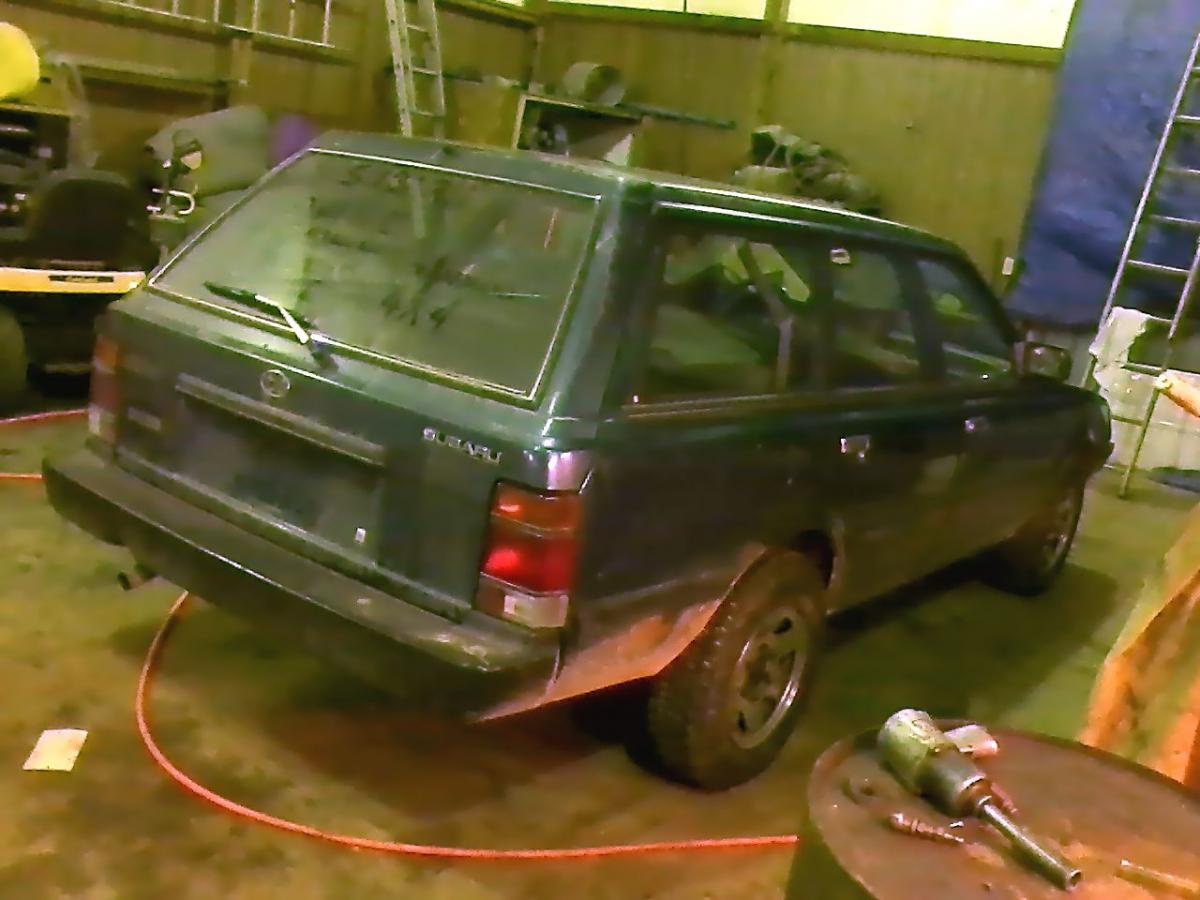

SubaruJawn Posted January 10, 2015 Author Share Posted January 10, 2015 All 4 Wheels Done, just need some Rubber... Link to comment Share on other sites More sharing options...

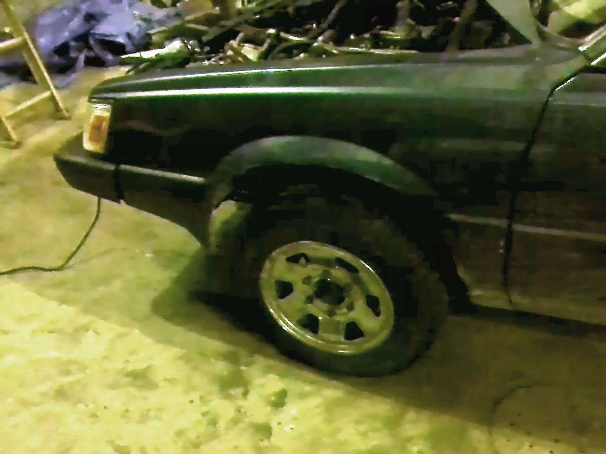

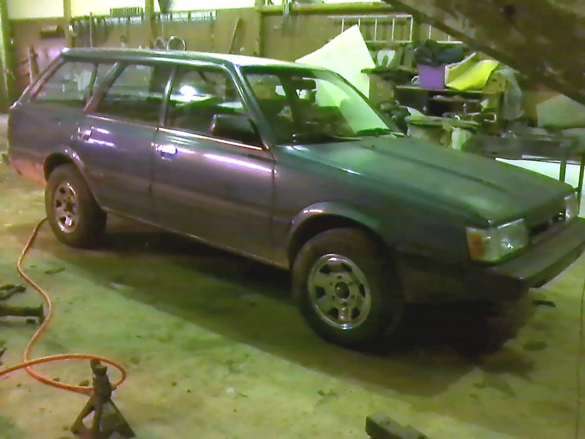

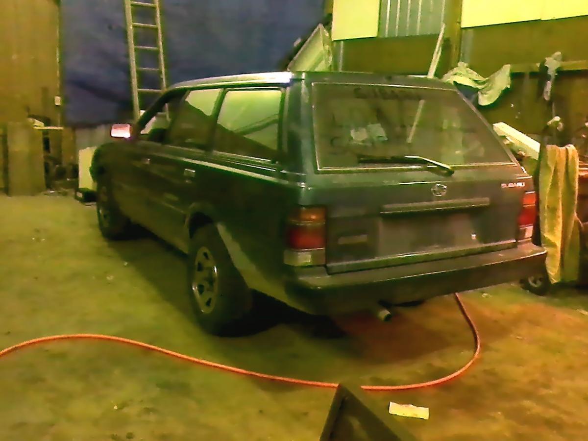

SubaruJawn Posted February 8, 2015 Author Share Posted February 8, 2015 Update Scubie is now sitting on all 4 14"s 6 lug nearly complete, stud need welded (out of gas in welder) missing 2 studs 1 Link to comment Share on other sites More sharing options...
