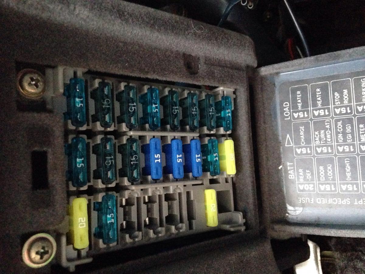

subiesteen1992 Posted November 10, 2014 Author Share Posted November 10, 2014 it is the 4th fuse down in the middle row that blows Link to comment Share on other sites More sharing options...
subiesteen1992 Posted November 10, 2014 Author Share Posted November 10, 2014 sorry about the pics being sideways idk why it did that Link to comment Share on other sites More sharing options...
subiesteen1992 Posted November 10, 2014 Author Share Posted November 10, 2014 On 11/10/2014 at 3:16 AM, Gloyale said: Turn signal and cigarette lighter not working may be unrelated....they are not on that circuit. But the blower relay and rear defrost relay are on fuse 12, along with A/C unit, height unit, Power window relay. The strange thing is that the on;y connection between the 1.25 Fusible link and the Circuit you mention is literally the IG. switch.....and that is before the fuse so short there wouldn't blow a fuse in the box. IDK......I think you have more than one issue But for the fuse blowing start out bychecking the relays below the radio in the center......try removing the Blower relay(white connector with RY and GW heavy gauge wires) and the Defrost relay(blue connector, also RY wire) just unplugged the relays and still blowing that damn fuse Link to comment Share on other sites More sharing options...
subiesteen1992 Posted November 10, 2014 Author Share Posted November 10, 2014 well I unplugged them if these are the relays lol Link to comment Share on other sites More sharing options...
Gloyale Posted November 11, 2014 Share Posted November 11, 2014 Well, that fuse is indeed the #12 one I was talking about. hmm....Gonna have to keep digging......I'll keep lookin through the FSM... Pretty much all the wire on that circuit is Red/Yellow.....so I'd look for relays that have Red/Yellow wire and pull them til you find it. Link to comment Share on other sites More sharing options...

Gloyale Posted November 13, 2014 Share Posted November 13, 2014 On 11/11/2014 at 8:47 PM, subiesteen1992 said: how exactly do you determine the number of the fuse? sorry if it's a stupid question but everyway I count the fuses I don't get 12....just trying to make sure we are on the same page haha. I grately appreciate you trying to help me out with this From your sideways picture above count left to right on the top row....1-8.....second row, 9,10, 11, 12 is the forth one in. Stop focusing on the FL........I know you are thinkin they are related....but they can't be. The FL gives power to the fuse......so even if the fuse blows....the FL is still giving power to one side of the fuse.......the Short is "downstream" from there.......on one of the curuits that is fed power by fuse 12. Here from the 86 FSM for XT.......is everything listed on the #12 circuit. Warning units, Rear defrost relay, Diode box, Trip computer, Blower relay, A/C max switch, Height control Unit, Switch box???, Speed warning, Mode control unit, Kickdown relay, Power window relay, Kickdown solenoid. Any of those things your car has, disconnect them. You can substitue a test light between the contacts of the fuse...it will glow until you pull the device causing the issue. Link to comment Share on other sites More sharing options...

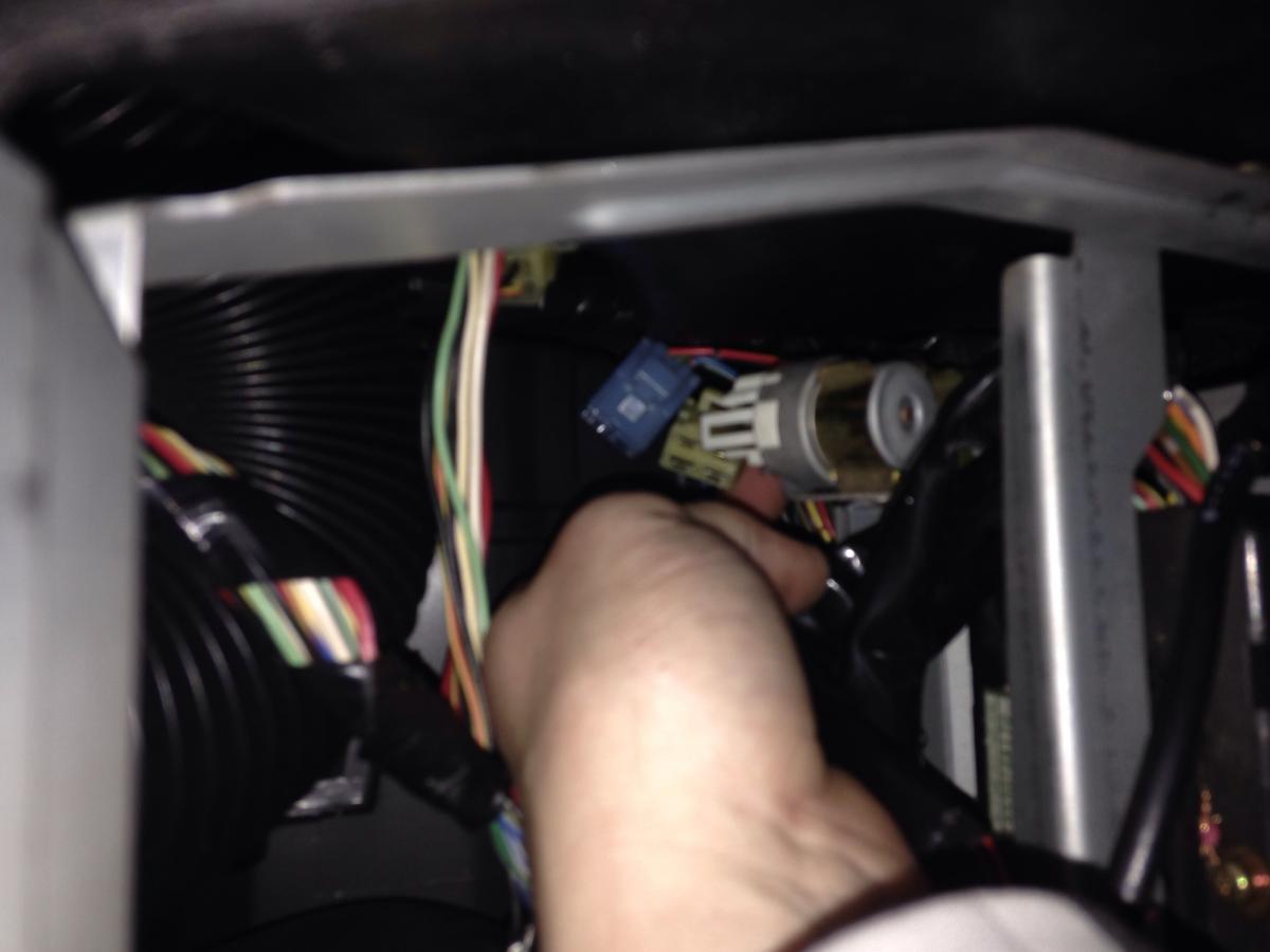

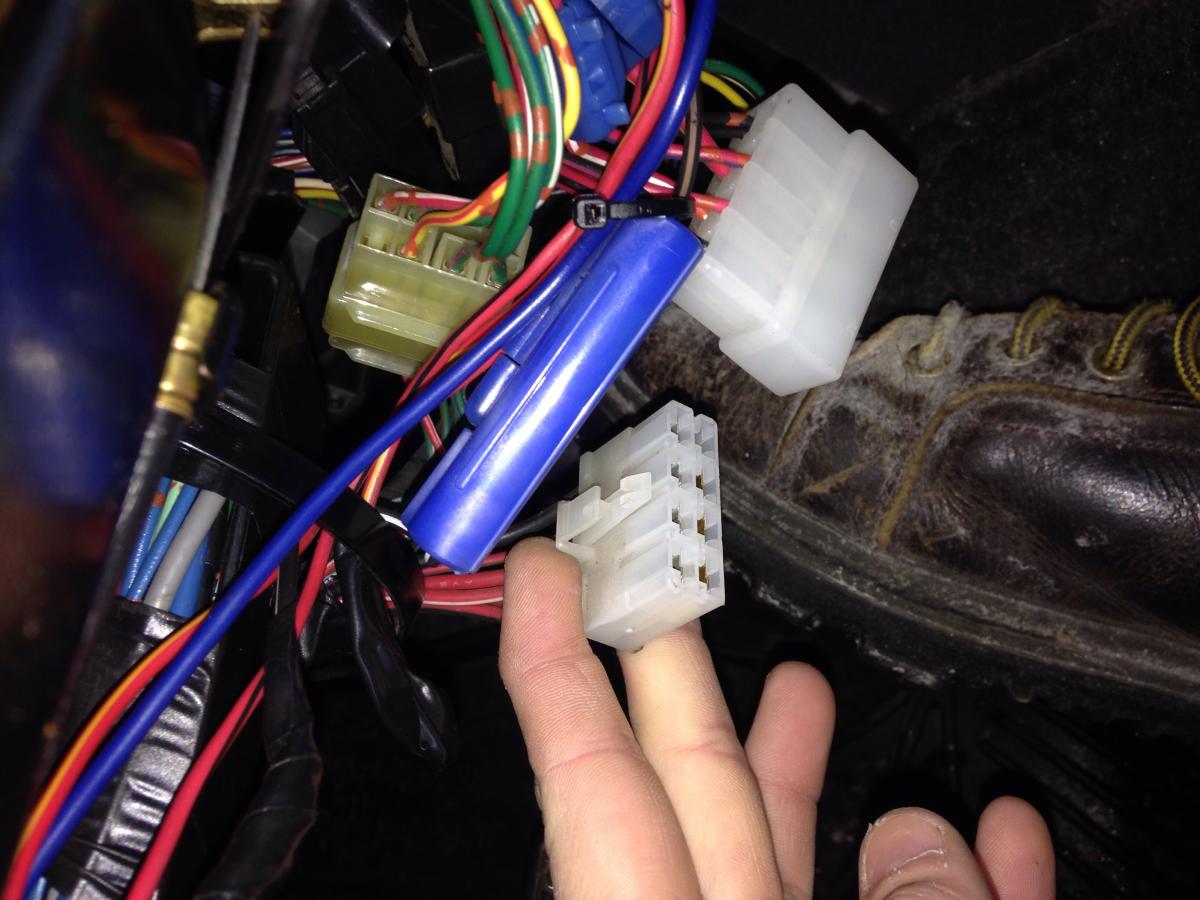

subiesteen1992 Posted November 14, 2014 Author Share Posted November 14, 2014 FOUND IT! unplugged this and now the fuse does not blow Link to comment Share on other sites More sharing options...
subiesteen1992 Posted November 14, 2014 Author Share Posted November 14, 2014 it's under the dash and runs up into the steering wheel Link to comment Share on other sites More sharing options...
Gloyale Posted November 16, 2014 Share Posted November 16, 2014 (edited) Well.....That's awesome. I still don't understand though.....that is Connector i77 with wires for the "passing switch" which is connected to both the Hi beam circuit and the Open/Retract headlight unit. Neither of those things is connected to fuse 12 ???? Are you sure you didn't just wiggle around some other connector? Edited November 16, 2014 by Gloyale Link to comment Share on other sites More sharing options...
