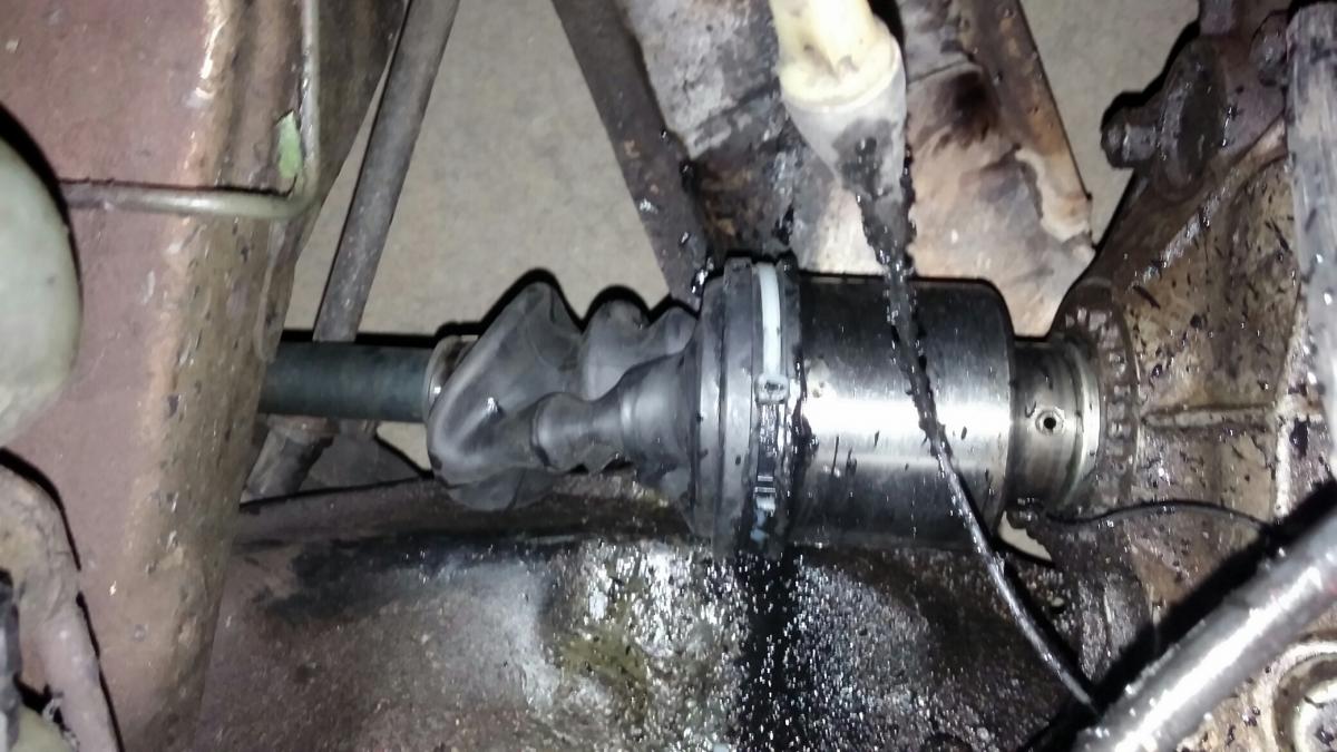

Dinky26 Posted November 10, 2014 Share Posted November 10, 2014 86 Brat,4 speed EA81. Why does my passenger side, inner CV boot keep vacuuming down and then throwing the geease out? What can I do to stop this process? Link to comment Share on other sites More sharing options...
somick Posted November 10, 2014 Share Posted November 10, 2014 I would let some air in. Try to use a tiny screw driver of something to let some air in. If it does not work you will have to loosen the band. Good luck, Sam Link to comment Share on other sites More sharing options...
rdweninger Posted November 10, 2014 Share Posted November 10, 2014 That is strange. When I re-boot, I always make sure to use a small screwdriver to let some air in before I band it. But you say yours 'keep' doing it? If the boots suck in (ie., air tight), then how does the grease get out? Link to comment Share on other sites More sharing options...
81EA81 Posted November 11, 2014 Share Posted November 11, 2014 Perhaps the the D.O.J overextended? Did you recently reboot the axle? Link to comment Share on other sites More sharing options...
Dinky26 Posted November 11, 2014 Author Share Posted November 11, 2014 Actually this the second time for doing it. First time it came from the factory (World Pack) CarQuest] and I replaced my failing one. So I tore the inner band off and zip tied it. Then it has done it again after being zip tied. Link to comment Share on other sites More sharing options...
Dinky26 Posted November 11, 2014 Author Share Posted November 11, 2014 I thinking about rezipping and putting in a straw from a WD40 can under the boot. Any foreseeable problems with this avenue? Link to comment Share on other sites More sharing options...
Gloyale Posted November 11, 2014 Share Posted November 11, 2014 You need real clamps. The zipties are letting air out when it warms and expands.....then it seals well enough under vacuum as it cools down. You need to squeeze most of the air out with the joint compressed to about 2/3 in.........then clamp it tightly with a proper CV clamp The boot should be slightly "sucked in" when cold....the air and grease inside expand when hot. Possible you have too much grease in there too. Link to comment Share on other sites More sharing options...
Dinky26 Posted November 11, 2014 Author Share Posted November 11, 2014 It started this process with a real clamp, and the drivers side is done the same way no problems. I guess this is a justified new tool purchase for a cv clamp tool. Link to comment Share on other sites More sharing options...
Dinky26 Posted November 11, 2014 Author Share Posted November 11, 2014 Okay, done with the appropriate band and tool. We'll see how long it stays right. Link to comment Share on other sites More sharing options...
