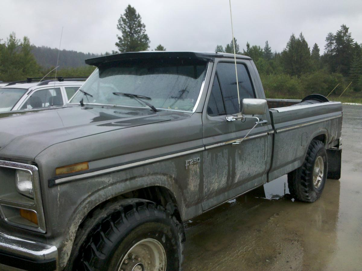

BoostedBoxer421 Posted November 17, 2014 Share Posted November 17, 2014 I have a 1985 ford f250 with a 300 bored .60 over and the timing marks on the harmonic balancer do not relate to TDC on the number 1 cylinder. The marks are aligned with TDC on number 5. How can this be? Link to comment Share on other sites More sharing options...
