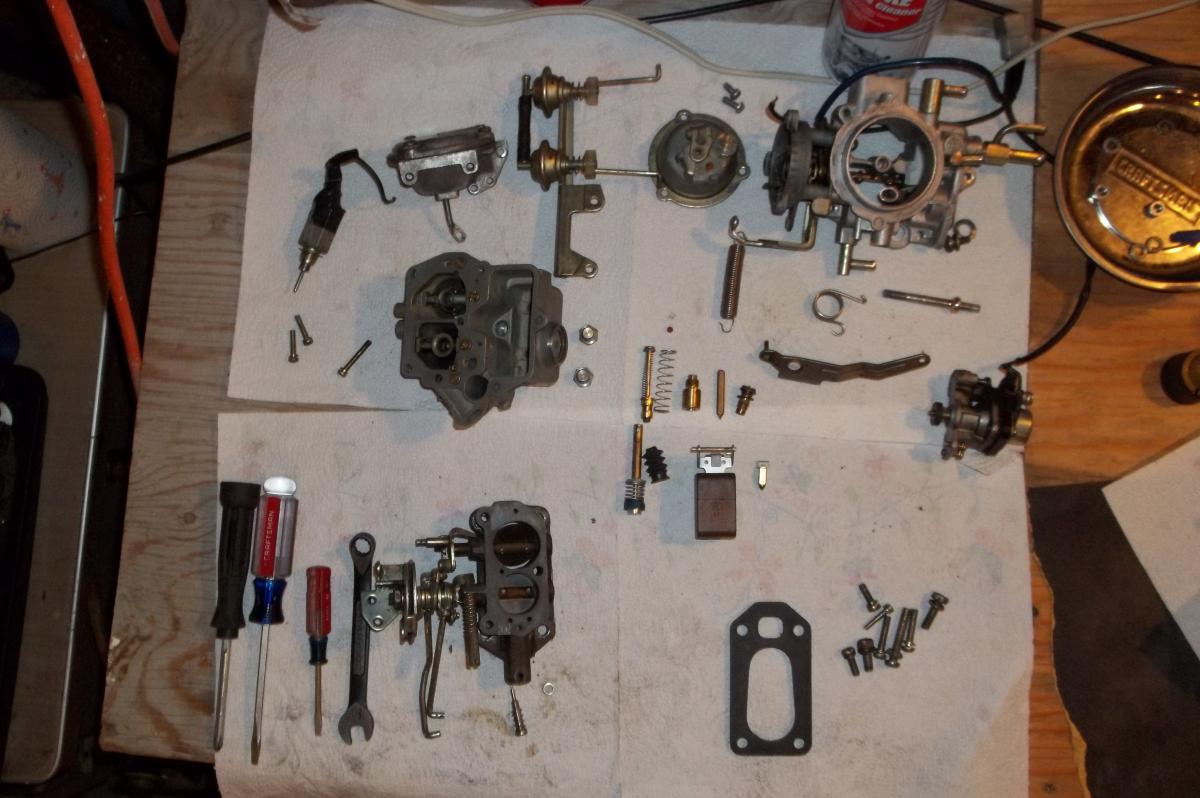

Sapper 157 Posted June 9, 2016 Author Share Posted June 9, 2016 (edited) Sooooo, anyways... Ive been a little busy Plan to do: Clutch Replace Oil Pump (old one cracked) Degrease Major carbuerator rebuild Reseal Water pump PCV valve Reseal EGR New oil filler tube seal Front main seal Rear main seal Coat newer valve cover gaskets in RTV Oil pan gasket (with RTV) New v-belt New radiator New OEM thermostat New cooling hoses New fuel hoses Fine tune valves New Cap and rotor What am I missing? Lol Edited June 9, 2016 by Sapper 157 Link to comment Share on other sites More sharing options...

Sapper 157 Posted June 11, 2016 Author Share Posted June 11, 2016 Carb is all disassembled, just waiting on the rebuild kit now. The new oil pump came today, OEM straight from Fuji Heavy Industries! Link to comment Share on other sites More sharing options...

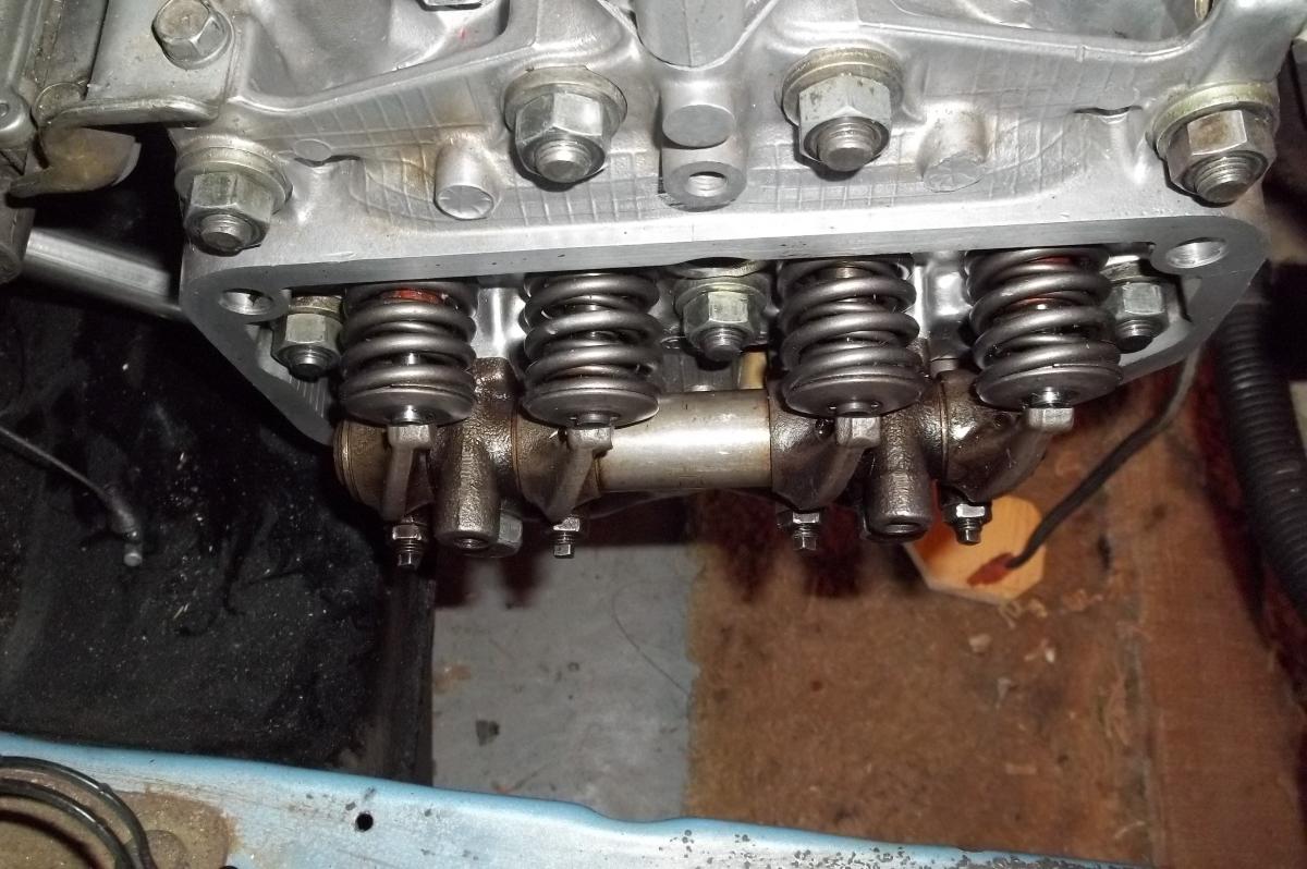

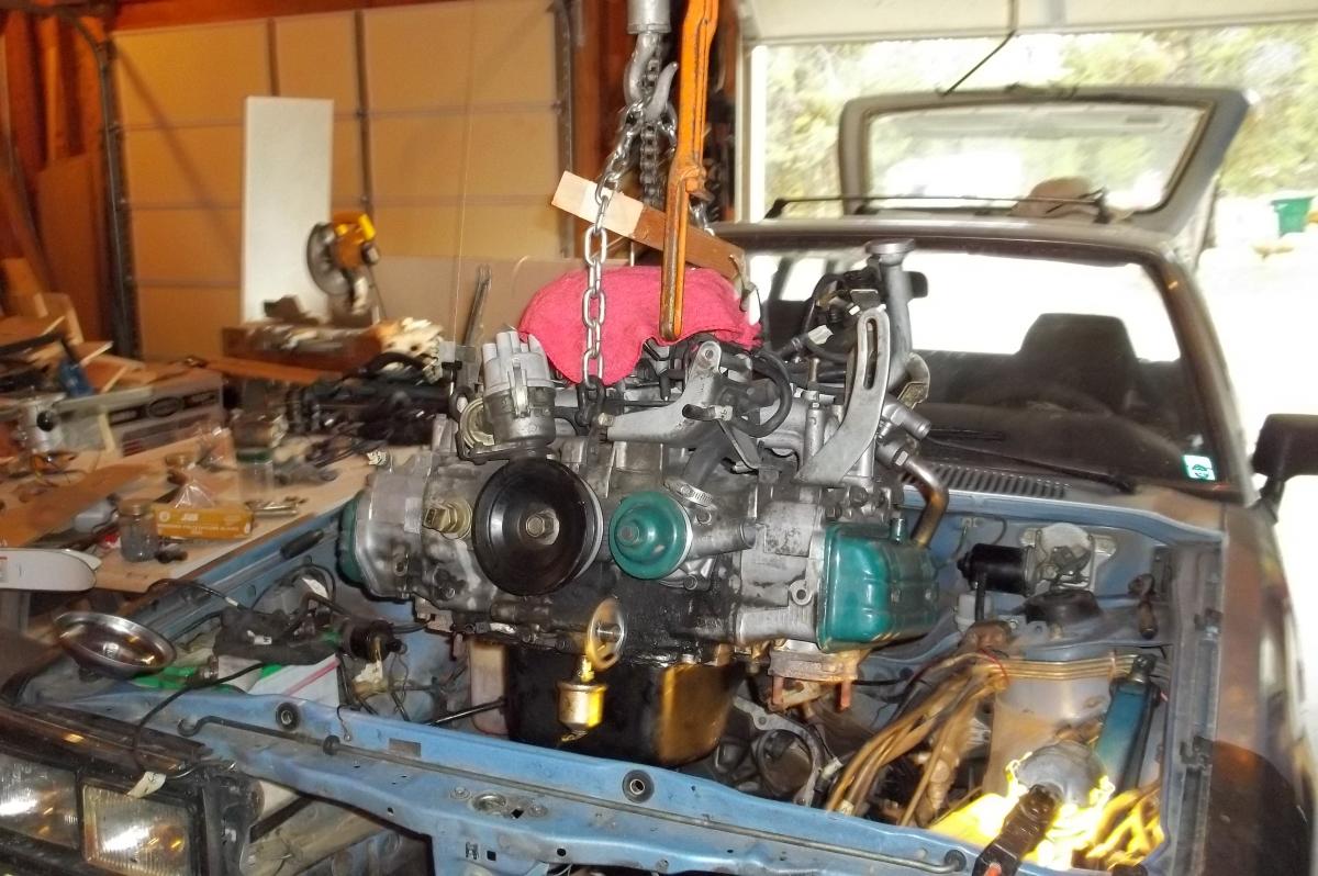

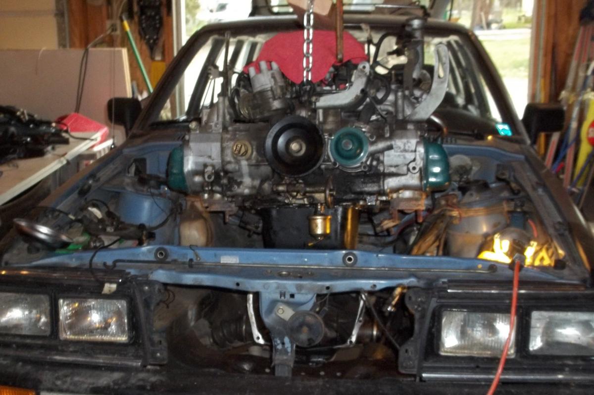

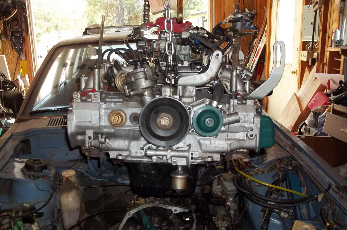

Sapper 157 Posted July 24, 2016 Author Share Posted July 24, 2016 (edited) Almost done! Engine is in, hooked up and almost ready to go. Had quite a few issues with the rocker arms and pushrods, but thanks to CrazyEights, all that is taken care of now... I still need to fill the antifreeze and triple check all connections, but once when that is done, then all that is left to do is get a new pitching stopper rod at a pick n pull. Crazyeights rocker arm all snug and valves adjusted: Edited July 24, 2016 by Sapper 157 Link to comment Share on other sites More sharing options...

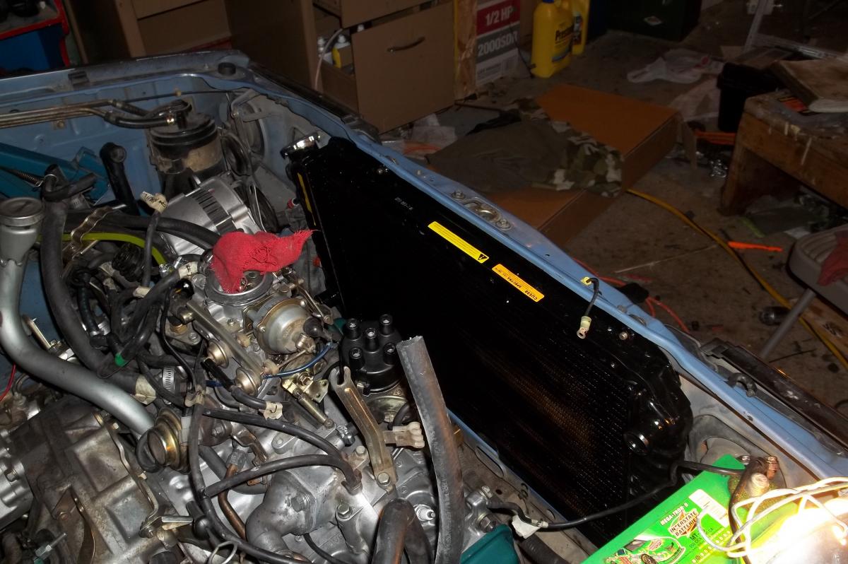

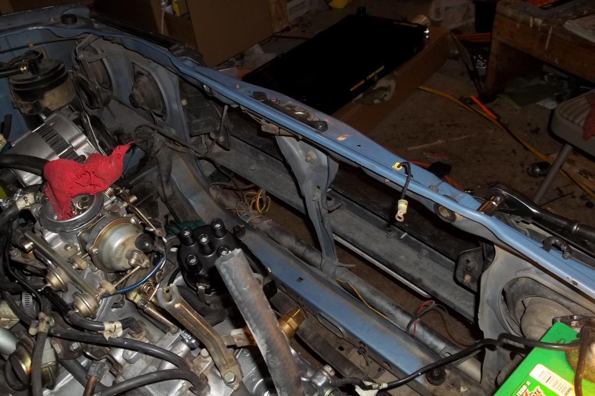

Sapper 157 Posted July 24, 2016 Author Share Posted July 24, 2016 No radiator: New Radiator: Link to comment Share on other sites More sharing options...

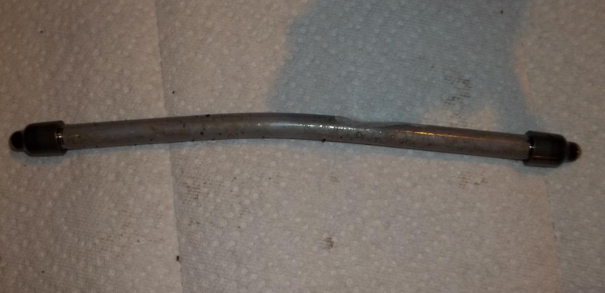

Sapper 157 Posted July 24, 2016 Author Share Posted July 24, 2016 The worst of the bad pushrods: Link to comment Share on other sites More sharing options...
BratWarrior Posted July 24, 2016 Share Posted July 24, 2016 What is the gold thing in place of the hex plug to the left of the crank pulley? Block heater? Link to comment Share on other sites More sharing options...
Sapper 157 Posted July 24, 2016 Author Share Posted July 24, 2016 What is the gold thing in place of the hex plug to the left of the crank pulley? Block heater? yup. Aftermarket block heater... It doesnt work right now though, I need a new cord Link to comment Share on other sites More sharing options...

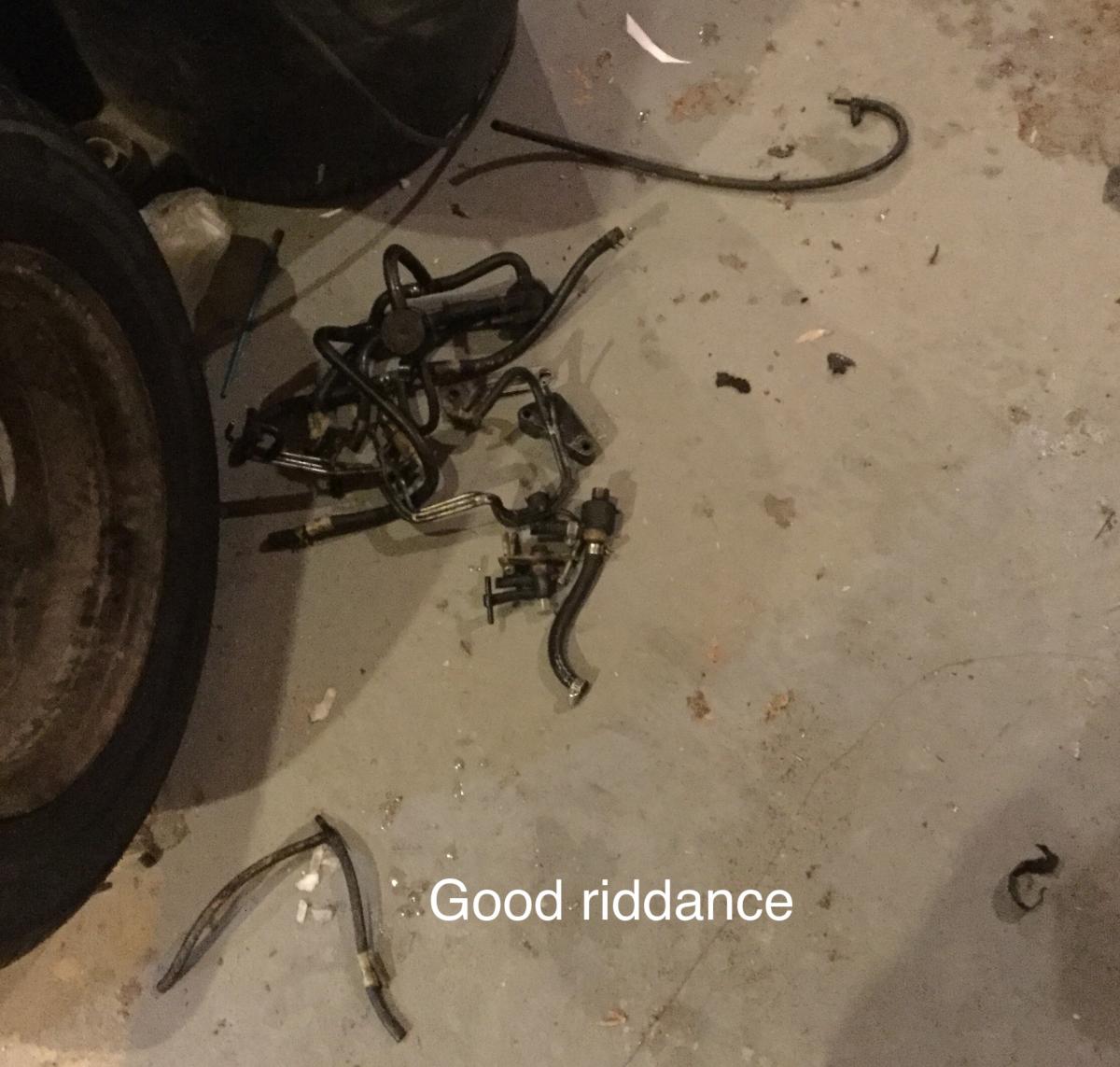

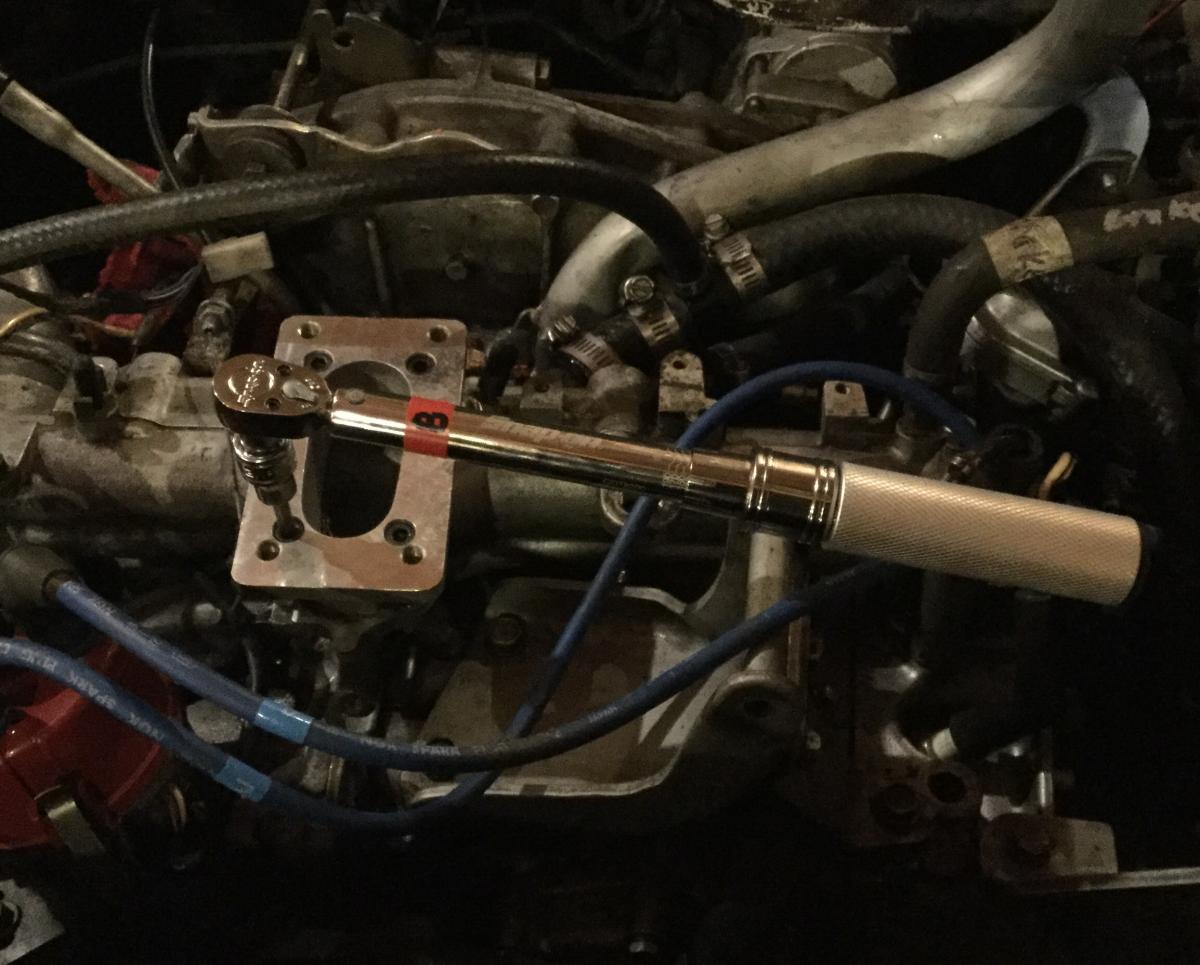

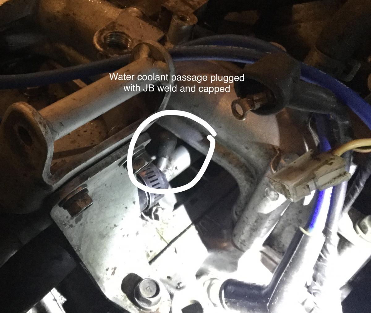

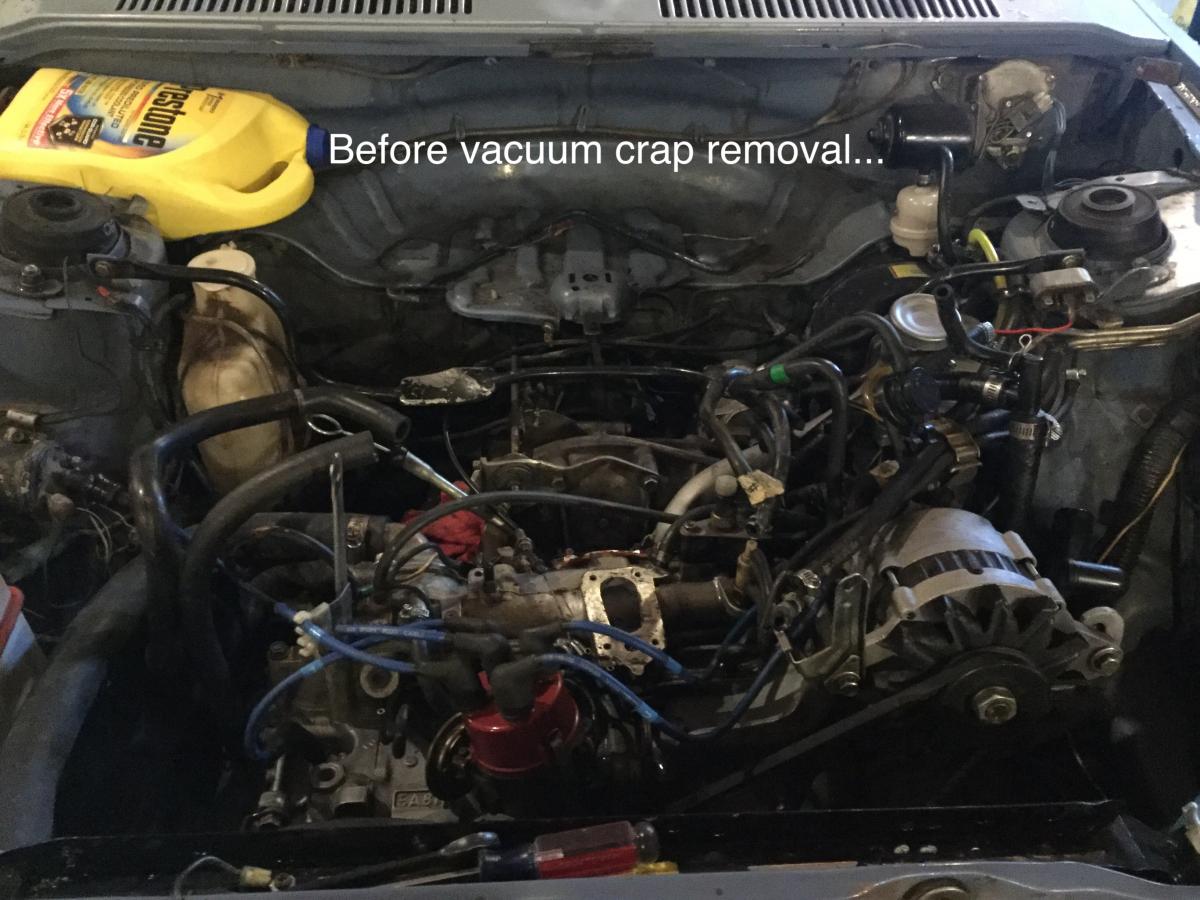

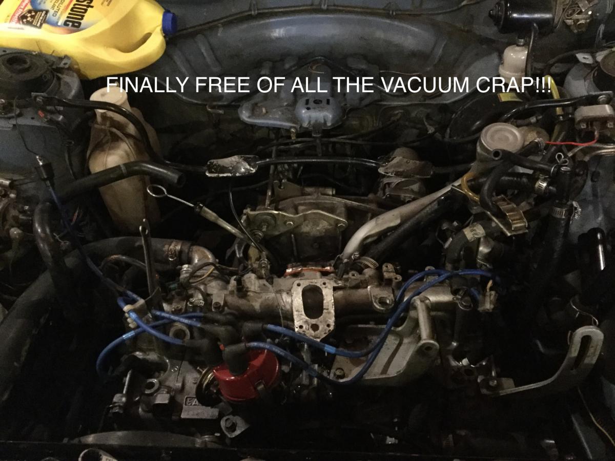

Sapper 157 Posted December 16, 2016 Author Share Posted December 16, 2016 Weber swap is fully underway.... here's some pics of what I have done so far... Link to comment Share on other sites More sharing options...

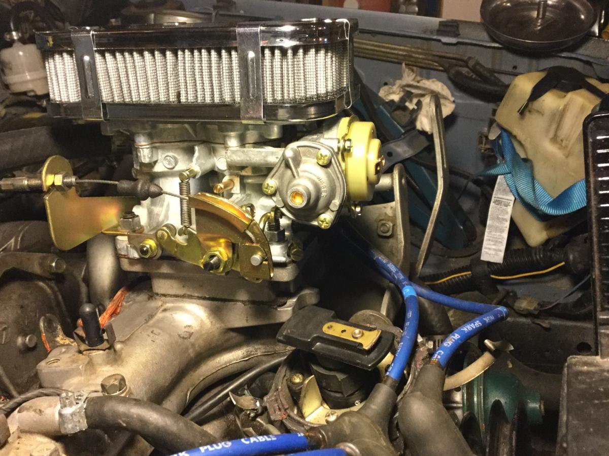

Sapper 157 Posted December 19, 2016 Author Share Posted December 19, 2016 (edited) Weber is finally on! Just got to figure out what to do with the stupid ASV system. Edited December 19, 2016 by Sapper 157 Link to comment Share on other sites More sharing options...
Sapper 157 Posted January 6, 2017 Author Share Posted January 6, 2017 (edited) Figured I do a quick update. So the ASV system is deleted, got the new throttle cable in, ( old one broke when I tried to move it to its new location ) started it up and it runs great! Feels so good to have a steady idle again! I'm pulling a solid 16 inches vacuum so that's good. The only thing I have left to figure out is get my brakes all taken care of and then my baby should be on the road again. Edited January 23, 2017 by Sapper 157 Link to comment Share on other sites More sharing options...
