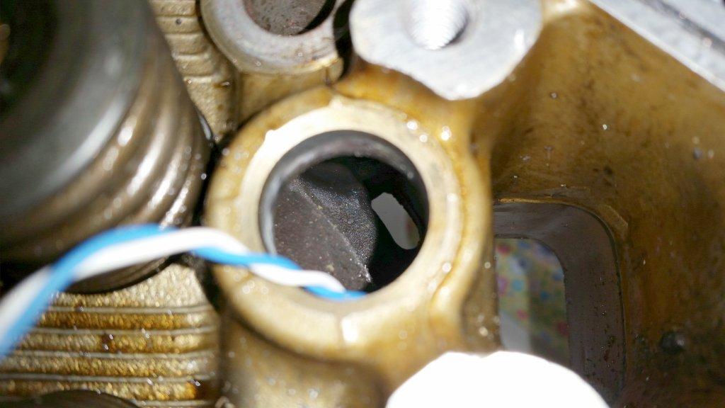

DaveT Posted December 18, 2014 Share Posted December 18, 2014 The plugs I am writing about are not external. They are in the space under the rocker covers. Quote Link to comment Share on other sites More sharing options...
mikaleda Posted December 18, 2014 Share Posted December 18, 2014 I've never seen any kind of soft plug under a valve cover, could you post some pics? They don't sound like a freeze plug to me but it wouldn't be the first time Subaru has thrown a curve ball at me. Quote Link to comment Share on other sites More sharing options...
Gloyale Posted December 18, 2014 Share Posted December 18, 2014 Freeze plugs are in certain spots in the block so that in case the coolant is the freeze it gives the coolant a place to expand to without cracking the block. It makes no sense that a freeze plug would EVER cause oil to mix with coolant. Freeze plugs are on the outside of the motor, they cause external leaks only There are 3 plugs in EA heads.....all of them are under the valve cover. IF any one of them leaks it WILL result in coolant dumping into the oil pan. But they won't cause a leak into the intake directly. But moist, mixed blow-by gases could be sucked in through the PCV Quote Link to comment Share on other sites More sharing options...
mikaleda Posted December 18, 2014 Share Posted December 18, 2014 There are 3 plugs in EA heads.....all of them are under the valve cover. IF any one of them leaks it WILL result in coolant dumping into the oil pan. But they won't cause a leak into the intake directly. But moist, mixed blow-by gases could be sucked in through the PCV They must have only done this in the ea motors. I know for a fact neither of my ej22s have this. I have never seen this on any motor before, and I don't see the point in having freeze plugs in this location Quote Link to comment Share on other sites More sharing options...

DaveT Posted December 19, 2014 Share Posted December 19, 2014 Here are pictures. Close up looking into plug hole. The wires are powering an LED to help see inside. EA82 head, one Freeze out plug removed: 1 Quote Link to comment Share on other sites More sharing options...

Gloyale Posted December 19, 2014 Share Posted December 19, 2014 They must have only done this in the ea motors. I know for a fact neither of my ej22s have this. I have never seen this on any motor before, and I don't see the point in having freeze plugs in this location They really aren't there for freeze protection. That's what proper antifreeze is for. They are there because they need to be to have somewhere for the casting sand to be removed. That's there actual purpose on every engines. EJ22 have similar ports in them, under the cam.......but for EJ they have been tapped and capped with hex plugs instead of press in. The "freeze plug" name is a misnomer and came about because of the totally secondary effect having these plugs can have of "saving" an engine from freezing. 2 Quote Link to comment Share on other sites More sharing options...
