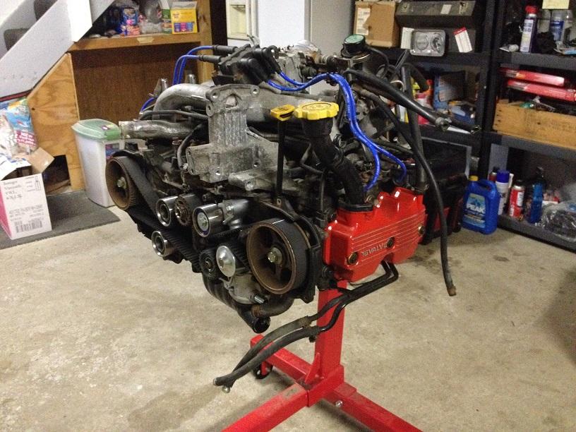

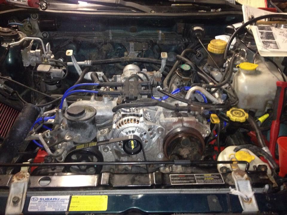

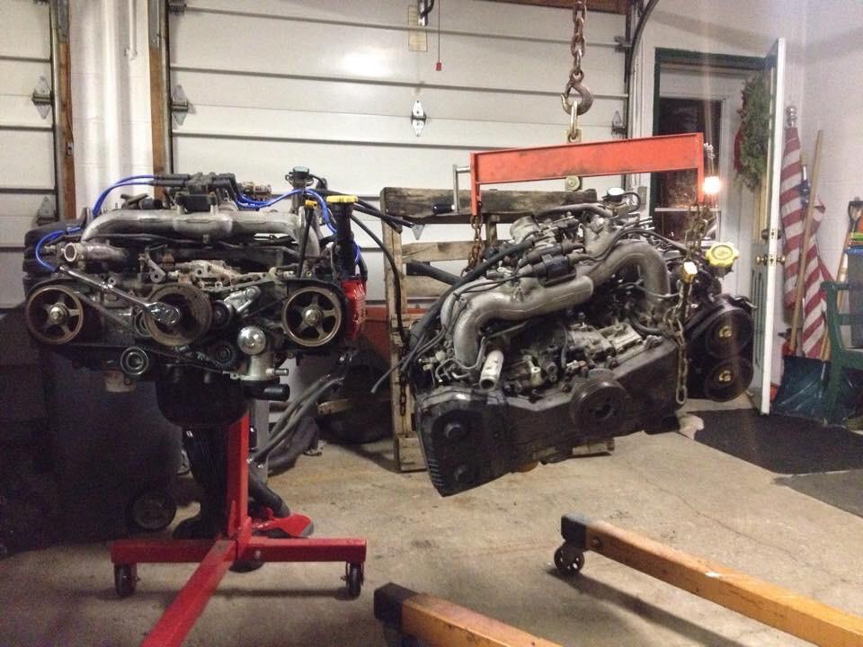

pginter96 Posted December 17, 2014 Share Posted December 17, 2014 (edited) UPDATE: Its been a while since the swap, I added an interesting discovery about the EJ25 in a reply on the second page if anyone is interested. Hey everyone! As swap time moves nearer, I decided to move the thread from "EJ22 Build- Discussion, Suggestions, and Advice for a First-Timer" to here, in hopes to neaten things up and confirm that I'm not building some crazy turbo-frankenmotor-stroker, just a plain old EJ22E with fancy painted valve covers. Im still putting the finishing touches on the motor itself, I still need to find an intact center timing belt cover and a harmonic balancer, along with a small collection of nuts, bolts, coolant hoses, and vacuum lines. Not to mention the UEL headers... (Its a race car! ) The swap is still a week out, maybe more depending on parts. the EJ25D is starting to overheat pretty regularly now. Ill add coolant to the radiator and burp it later today, as if that'll make a difference. -EDIT- took maybe a quart, so its not leaking from anywhere, just air caveating in the water pump... So until then, Ill pester you with my questions! -In terms of registration and insurance, what should I say, if anything? I seriously doubt anyone from the DMV or USAA is going to be able to look under the hood and tell the two engines apart, or even really know what a boxer is! -Anyone know where I can find timing belt covers? every one in the junkyard is smashed, apart from a phase II EJ222, but, ya know why that wont work... I threw the original one out, and if it had a part number on it, either I'm blind or it was destroyed. -EDIT- apparently the EJ25 one will work -What sort of break-in procedures should I be aware of? I plan on running Mobile 1 synthetic (SEE EDIT), however I've heard that its best to break-in with conventional to help things seat, and change it after the first 50-100 miles. The engine hasn't run in at least a year. -EDIT- I'll just be running CONVENTIONAL OIL. My Chrysler teacher works for a local Subaru dealer (yep, he quit a dodge dealer to work for Subaru) and has told me horror stories about what happens to these engines if you use zinc-free oil, such as Mobile 1. And apparently since this is a roller motor, there really isn't a "break in" other than cooking the moisture out of it. He said the best thing I could do is start it and let it idle for about an hour, then change the oil and filter. (obviously if it starts clacking away shut 'er down and throw an oil pressure gauge on). He's also said that of all the motor pulls he's done, Subarus are the easiest. the worst part is the two studs/bolts that must be removed on the top of the engine. Surprised to see its only like 3 pages in the service info... -Coolant passages... they're all crusty. Should I be concerned and run a garden hose through there to clean them out or will they self clean when coolant starts to move? Thanks! Sorry if my questions are pretty basic and annoying, but I'm 18 and don't have many other financially viable options and need this car to get to college and work. I paid $4,000 for this car and its practically worthless as it sits, so I cant sell it for a better car 'cause no one will buy a car with bad head gaskets for $4,000. Edited March 24, 2015 by pginter96 Link to comment Share on other sites More sharing options...

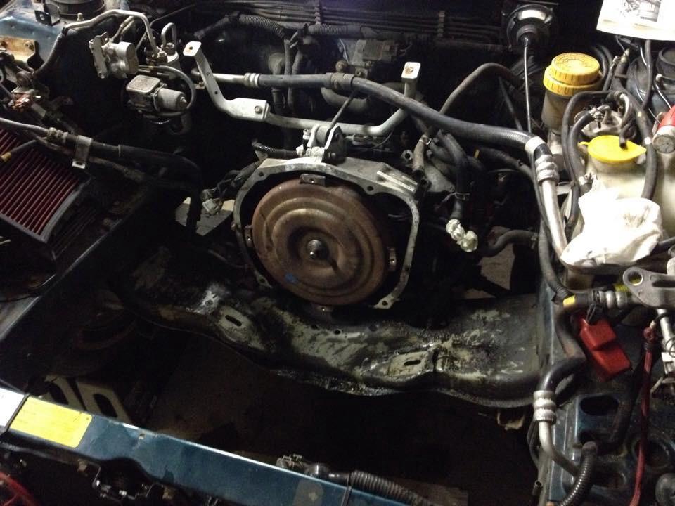

AdventureSubaru Posted December 18, 2014 Share Posted December 18, 2014 Yep. Same part. At 100k plus, I'd stick with conventional oil. For the torque converter, have the "pitch rod stopper/Dog Bone/upper trans mount disconnected and jack the trans up before pulling the motor. If so, the torque converter should stay seated. You can measure from the back of the starter hole. Should be 1/8 of an inch between the bellhousing and torque converter. If the converter comes out with the motor, slide it back in. (make sure the metal tube is attached to the back of it) Hold the nub in the center to keep it level while rotating it clockwise. There are 3 different little clunks before it is seated 100%. Link to comment Share on other sites More sharing options...

idosubaru Posted December 20, 2014 Share Posted December 20, 2014 there's a great thread on here with pictures/measurements/references as to what is really close but not seated and what is actually fully seated. simply put it's this: the flexplate and torque converter DO NOT touch when the engine and trans are pulled together. the torque converter bolts actually pull the TC slightly out of the trans to pull it flush to the flexplate. so based on that same illustration - you can simply measure the difference: 1. distance between flexplate and bellhousing mating surface on engine 2. distance between torque conveter flexplate mounting surface and mounting surface of bellhousing on transmission. if the numbers add up such that they'll touch - it's not fully seated. i have never added that way - it's just an illustration and a definitive test you could do for a first timer unfamiliar with Subarus wanting to get it right before they drop the engine into the car. Link to comment Share on other sites More sharing options...

pginter96 Posted December 31, 2014 Author Share Posted December 31, 2014 (edited) EJ22 is in! No difficulties. The only thing that worried me is that when (before) I went to install the flexplate-to-torque converter bolts, I spun the engine and the torque converter spun with it. Then when I went around to the starter hole and the torque converter spun on its own, with no abnormal resistance. After that the engine and torque converter spun free of each other allowing me to put the bolts in. Im almost positive that it didnt shift with the engine removed. While installing the flexplate bolts, the flexplate and torque converter had a small gap between them. (Shoutout to Inferno Fabrications for the awesome headers) Edited December 31, 2014 by pginter96 Link to comment Share on other sites More sharing options...
