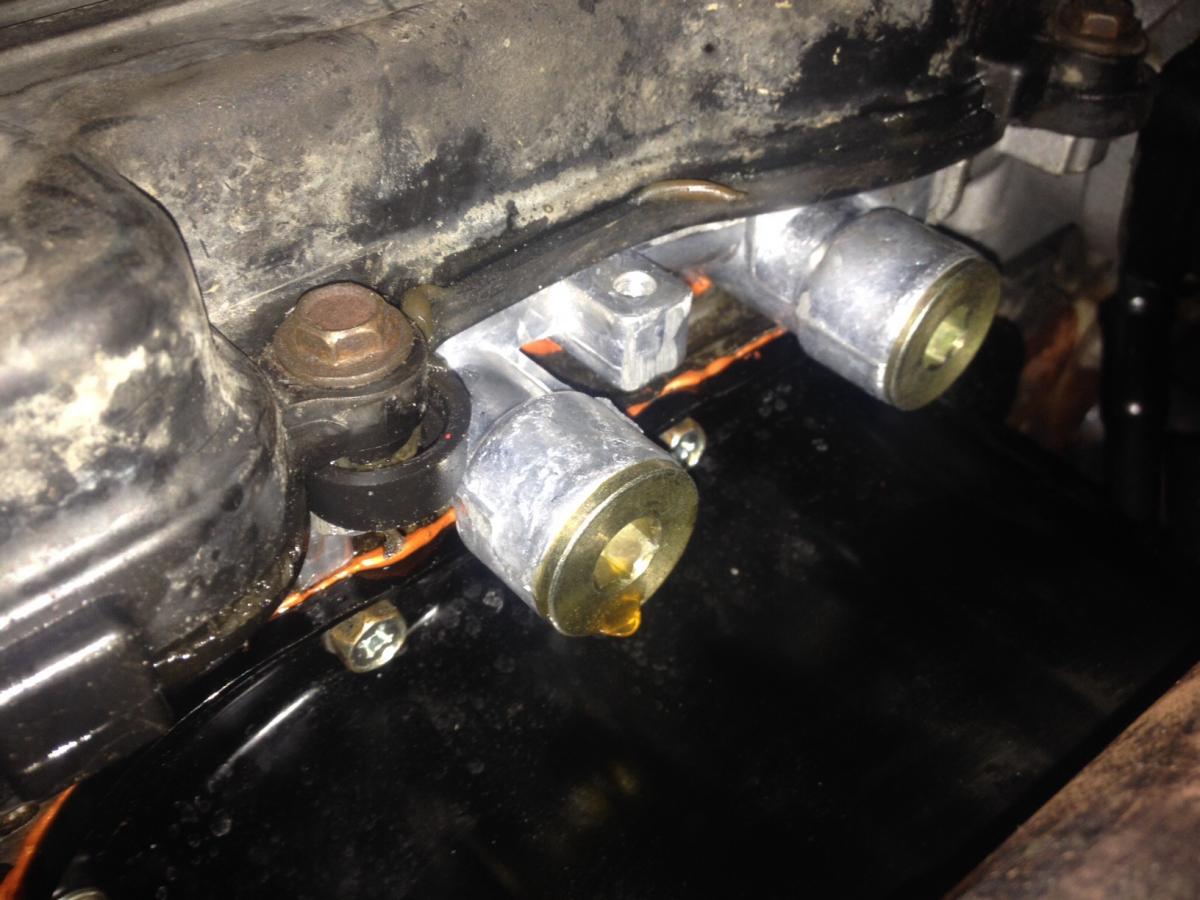

pginter96 Posted January 13, 2015 Author Share Posted January 13, 2015 Well I got the new oil pump on yesterday... And it leaks! 99.99999% sure thats its not my fault, it appeared to be leaking from the brass plug at the bottom, as opposed to the actual housing itself (about a drip every second or two at idle). took that brass plug off, and there was a mark around it where it was making contact with the pump housing, and there was a gap in it as if it werent sealing all the way. Hopefully a crush washer and some RTV will do the trick. Ill start it up later today when the RTV is cured and then we'll see if its just a cheap crappy part or if Im too stupid to seal it correctly Link to comment Share on other sites More sharing options...
pginter96 Posted January 13, 2015 Author Share Posted January 13, 2015 well the leak is fixed and all is supposedly well, but the knock didn't go away! Better get the 2.5 back together. And my exhaust just got a new, pretty bad leak on the test drive. One thing after another... I love this car, but I think it may be time to say goodbye and look at something newer. I'm running out of motivation to keep fixing this car every weekend Link to comment Share on other sites More sharing options...
