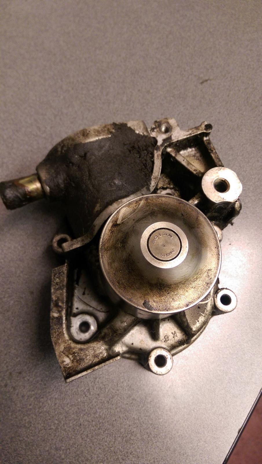

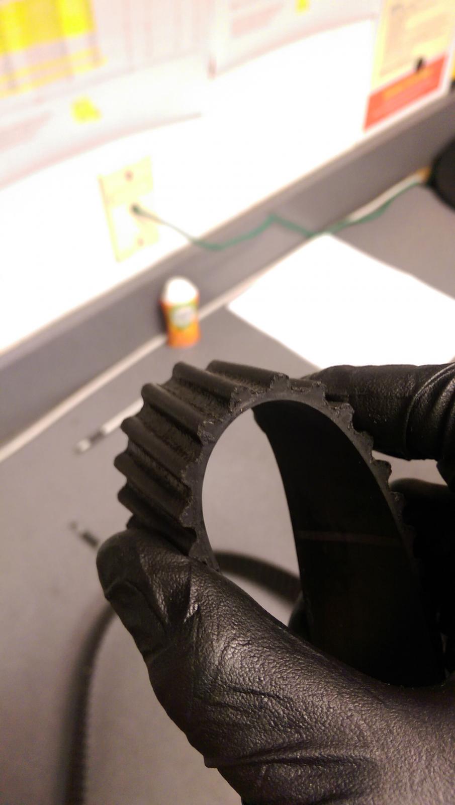

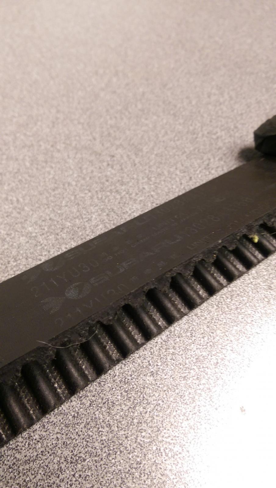

nicholi2789 Posted January 18, 2015 Author Share Posted January 18, 2015 Here are some of the old parts. Is it possible that this could be the original belt and water pump? The water pump especially looks original. I doubt they took it to dealership and had these parts replaced but it is possible. What do you think guys? 264,000 miles on a timing belt? Link to comment Share on other sites More sharing options...

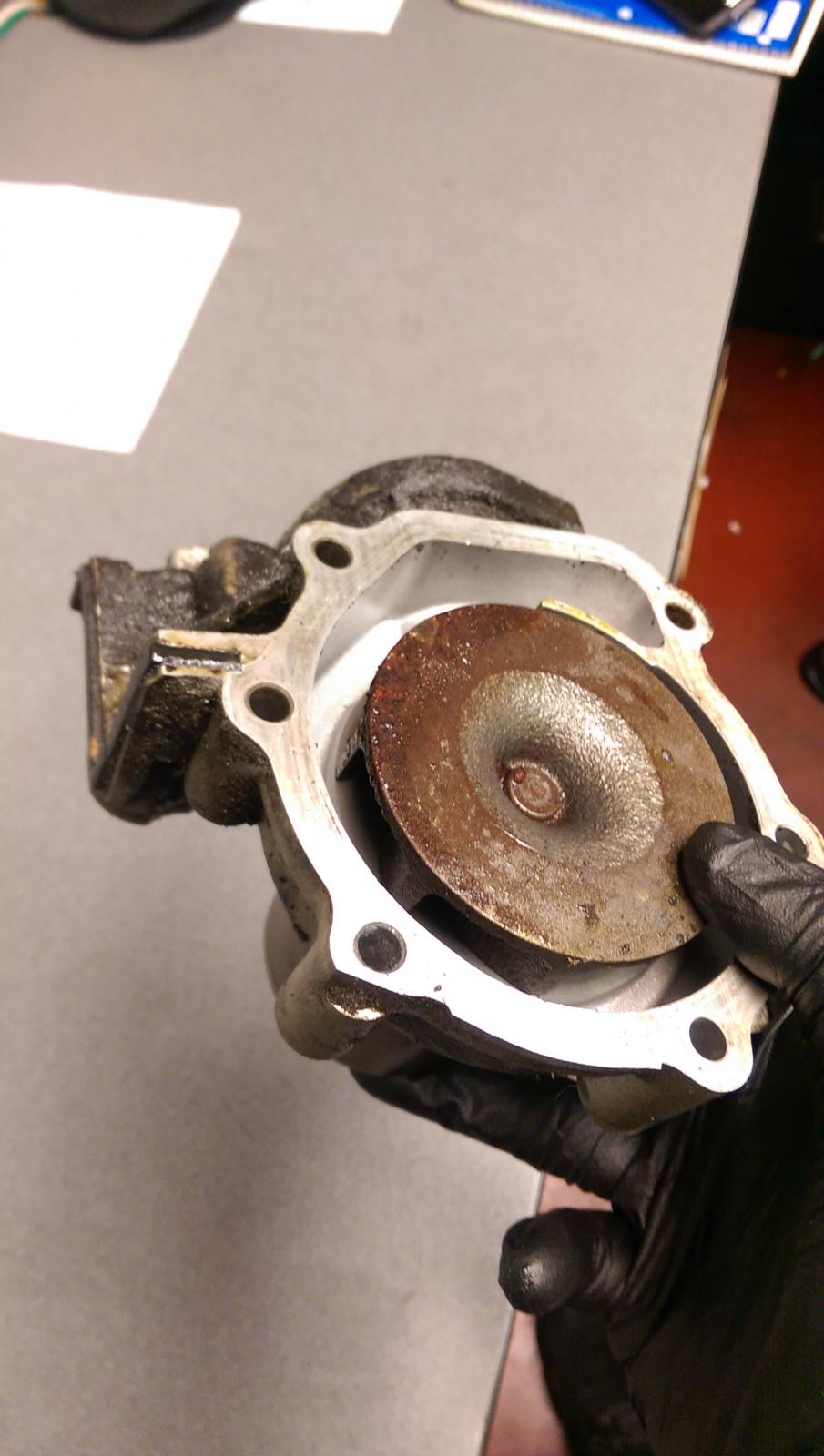

nicholi2789 Posted January 18, 2015 Author Share Posted January 18, 2015 (edited) And here is the water pump.. Edited January 18, 2015 by nicholi2789 Link to comment Share on other sites More sharing options...
heartless Posted January 18, 2015 Share Posted January 18, 2015 belt was more than likely replaced at some point, OEM belts are easy to get. Water pump could very well be the original - most dont get replaced on the first timing belt job Link to comment Share on other sites More sharing options...
nicholi2789 Posted January 18, 2015 Author Share Posted January 18, 2015 belt was more than likely replaced at some point, OEM belts are easy to get. Water pump could very well be the original - most dont get replaced on the first timing belt job Yeah the belt is definetely worn out but it's not as worn as you would think if it had that many miles. I noticed the newer water pumps have different fins on the inside. They look a little different. Link to comment Share on other sites More sharing options...
