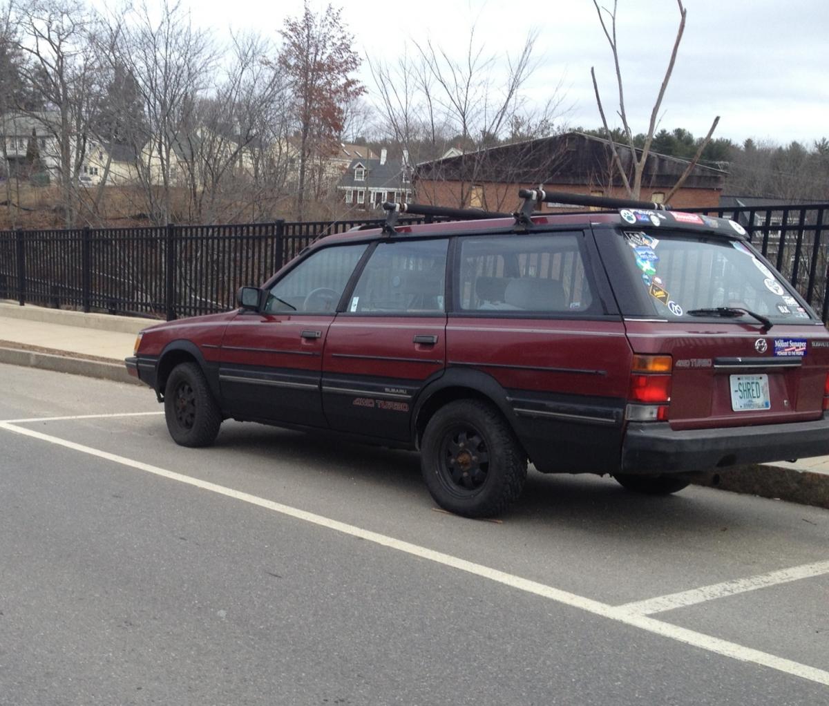

mr sarcastic Posted January 14, 2015 Share Posted January 14, 2015 I've had this car for over a year now, and I went through last winter with this issue and I don't feel like doing that again. The issue is, my heat is barely warm when on defrost, or bi-level. But on AC its toasty hot. So I have to play a game when driving, defrost for a bit to clear the windshield then AC to warm the wife. The can is an 87 gl-10. I've done a couple coolant flushes, putting the hose to the radiator and heater core to make sure they're clear. The heater core was somewhat clogged, and after I cleared it it was a tad warmer, not enough to please the wife. My question is, would this more likely be a heater core issue or flapper issue? Does the AC pull air by a different part of the core then the defrost, defrost part could be a cold spot on the core? Or is a flapper probably hung up or out of adjustment? Pic cause everyone likes pictures. Link to comment Share on other sites More sharing options...
