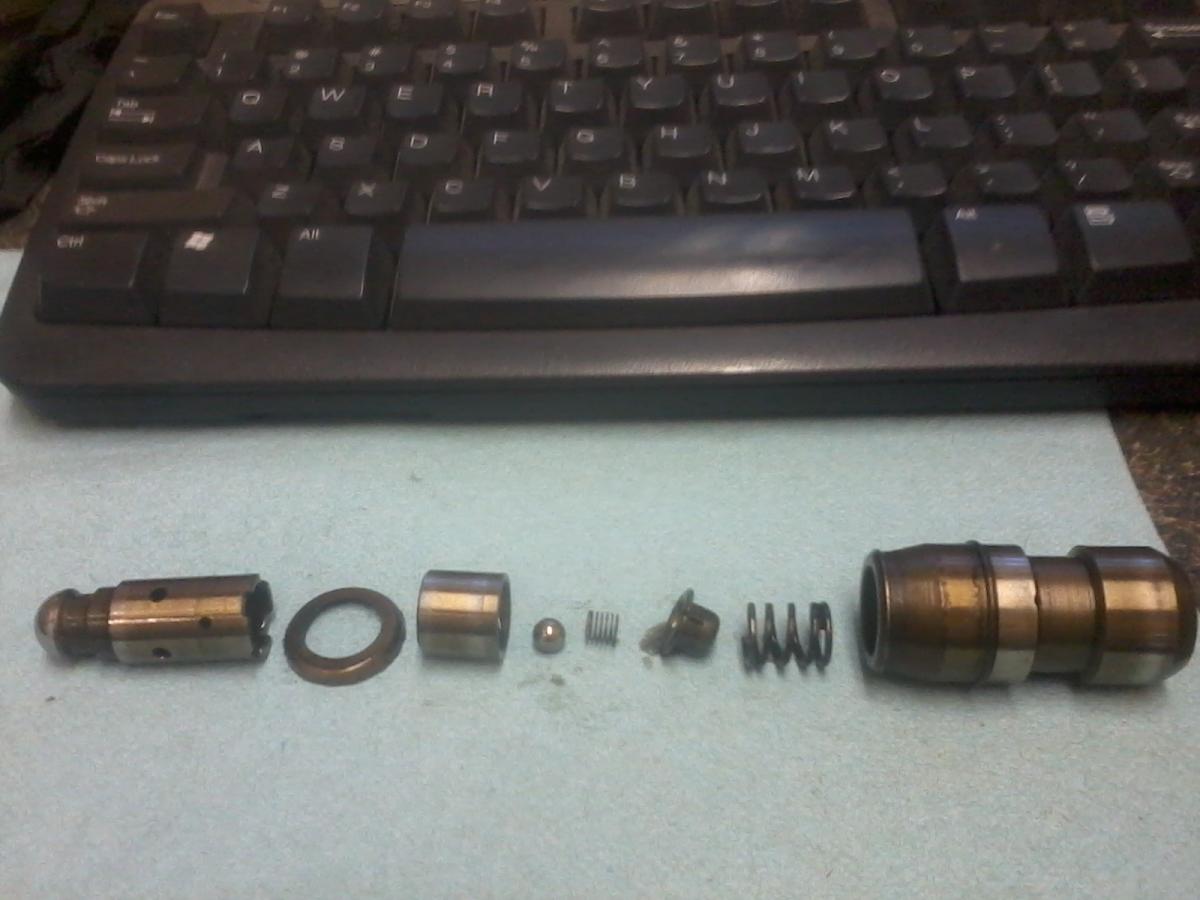

subarusaver Posted January 22, 2015 Share Posted January 22, 2015 Just in case you are interested, It is possible to disassemble the old lifters ALL THE WAY and clean them good , re assemble them and re install them. I did that recently with an entire set of lifters on my ea 82 along with the oil pump re seal,and the engine is quiet as a mouse...Hope that helps.. 1 Link to comment Share on other sites More sharing options...
Crazyeights Posted January 22, 2015 Share Posted January 22, 2015 Do you have to mess with the factory "crimped" area on the top of the lifter? What holds it together ,snap ring? Link to comment Share on other sites More sharing options...

subarusaver Posted January 23, 2015 Share Posted January 23, 2015 (edited) On 1/22/2015 at 3:54 AM, Crazyeights said: Do you have to mess with the factory "crimped" area on the top of the lifter? What holds it together ,snap ring? The ring around the lifter is a stop ring (as I understand it) You do need to pry the cap off the lifter.A small screwdriver works really good, go around a little bit at a time until you get it loose.I will attempt to post a picture here of a disassembled lifter.Hope this helps. Edited January 23, 2015 by subarusaver 1 Link to comment Share on other sites More sharing options...
