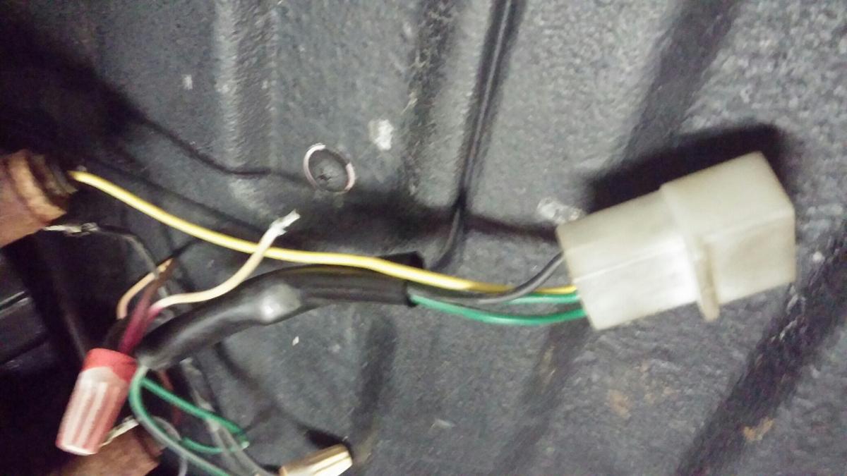

Dinky26 Posted January 20, 2015 Author Share Posted January 20, 2015 I wiggled all the wires individually as described above with no change. Upon further testing, the hazard option works fine with key in off position, in on position it flashes back and forth between turn and other half of brake light in the middle with a real slight burn on the back up bulb, turn the key off and it goes back to turn bulb correctly. I have also switched tail lights from side to side with same result. Any idea how to fix a plug with broken wire such as this, not the same taillight as I'm having issues with either. Link to comment Share on other sites More sharing options...

ihscout54 Posted January 20, 2015 Share Posted January 20, 2015 "Any idea how to fix a plug with broken wire such as this, not the same taillight as I'm having issues with either." Whats the deal with the wire nuts, was that a repair or do you have trailer lights? Its time to dust off the soldering iron and heat shrink. Wire nuts are not a trust worthy connection. Link to comment Share on other sites More sharing options...
Dinky26 Posted January 20, 2015 Author Share Posted January 20, 2015 "Any idea how to fix a plug with broken wire such as this, not the same taillight as I'm having issues with either." Whats the deal with the wire nuts, was that a repair or do you have trailer lights? Its time to dust off the soldering iron and heat shrink. Wire nuts are not a trust worthy connection. That light is actually an extra that I got with a bunch of parts I bought last year, if I can figure out how to fix that plug I would do the rest of the wiring correctly. Link to comment Share on other sites More sharing options...
ihscout54 Posted January 20, 2015 Share Posted January 20, 2015 Gotcha, the wire in the pic has come out of the connector? Its a pain but the terminal inside the connector can be removed with a small flat screw driver or pick. Then replaced or soldered etc. Since the harness is a mess anyways ide cut the harness off the busted light or get another at a j-yard, it doesent have to be a brat just find a similar connector and solder it for better results. Link to comment Share on other sites More sharing options...
Dinky26 Posted January 20, 2015 Author Share Posted January 20, 2015 Cool, hadn't thought about that avenue, at least I finally have LKQ to go to here in Wichita. Link to comment Share on other sites More sharing options...
