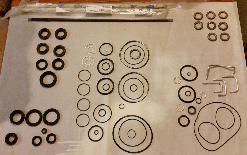

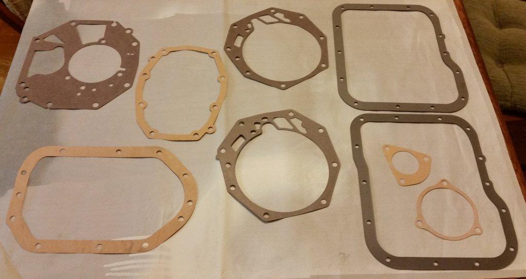

DaveT Posted June 13, 2015 Author Share Posted June 13, 2015 Gaskets for both styles of case All the seals, O-rings, Servo pipes, thrust bearings [the long shafts at the top are not part of the kit] When I ordered this, there were still about 8 left in stock.About the same number of oil pump drive shafts were left also. Servo pipes and some of the gaskets were no longer available separately. Quote Link to comment Share on other sites More sharing options...

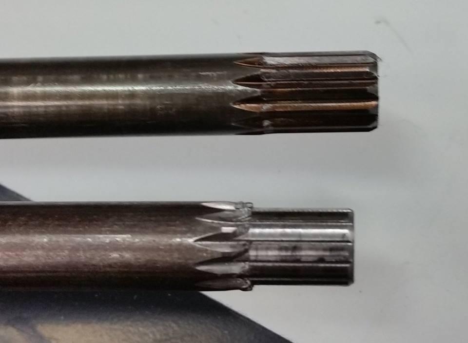

DaveT Posted November 24, 2015 Author Share Posted November 24, 2015 Pump drive shafts: Quote Link to comment Share on other sites More sharing options...
l75eya Posted November 24, 2015 Share Posted November 24, 2015 Woah! What the hell stripped them clear off? Quote Link to comment Share on other sites More sharing options...
DaveT Posted November 24, 2015 Author Share Posted November 24, 2015 It just quit. I was pulling out of a parking lot, not really flooring it, and the engine revved under no load. Absolutely no warning or other symptoms before it failed. Since then, I've looked at all but one of the 6 or so I have, and all but one is showing signs of wear on the pump end. The torque converter ends are fine. There is no slop in the pump in one transmission I disassembled to get familiar with the internals, yet it has the same wear indications [not stripped] The failed one had a bit over 200K miles. The one from my 86 has NO indication of wear on the splines, it looks like the new shafts I bought. It has around 200K on it also. I could not find any pieces of the missing splines either, much to my surprise. Quote Link to comment Share on other sites More sharing options...
maozebong Posted November 24, 2015 Share Posted November 24, 2015 other than pumping efforts, it could be possible one of those accumulator type of pistons for pressure regulation got stuck and is causing a "hydraulic hammering" to the oil pump gear. Quote Link to comment Share on other sites More sharing options...

DaveT Posted November 24, 2015 Author Share Posted November 24, 2015 Yes, I know about the magnetic drain plug. The pieces could not have moved far, if they came off at the time of failure, since the pump stopped turning at that time. There isn't really anywhere for the pieces to go if they did shear off intact - Quote Link to comment Share on other sites More sharing options...
DaveT Posted November 24, 2015 Author Share Posted November 24, 2015 If there is some failure mode that causes hammering ro occur, it wasn't noticeable while driving. The shaft is well under 1/2" diameter, so the force required to cause damage would be pretty small compared to those involved with moving the car. Quote Link to comment Share on other sites More sharing options...

Loyale 2.7 Turbo Posted November 25, 2015 Share Posted November 25, 2015 Weird Theory of Today: Could it be possible that the Shaft splines were somehow, "Grinded" slowly with time and use, and that the metal sheared became dust and fused with the ATF, blackening it? Quote Link to comment Share on other sites More sharing options...
DaveT Posted November 25, 2015 Author Share Posted November 25, 2015 The various ones I have show varying degrees of wear. None are to the point where the shearing off looks imminent. It does seem to me that they gradually wear away. They all have had a change or 2 at least of atf. Nothing unusual in the color. Quote Link to comment Share on other sites More sharing options...
