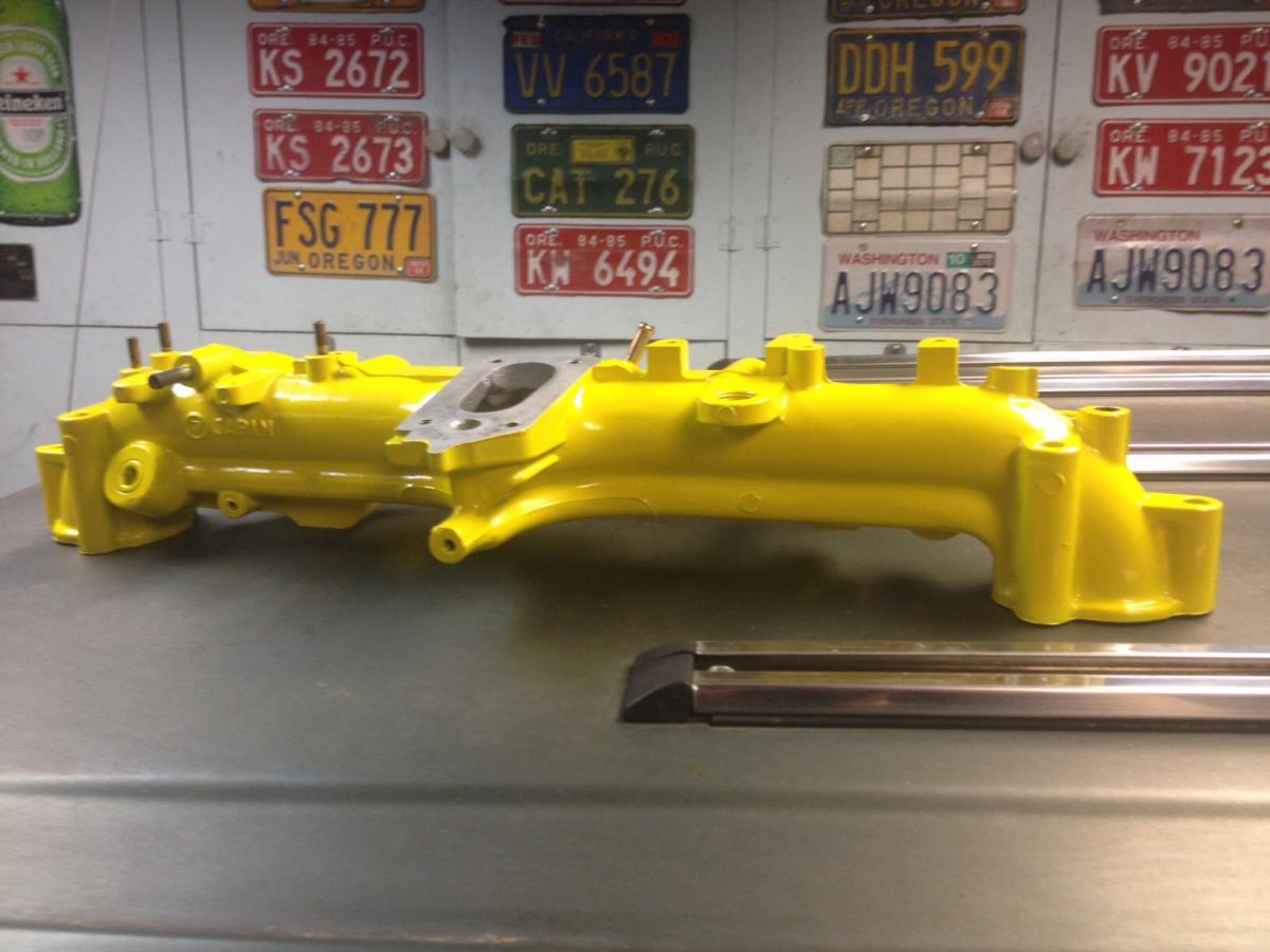

83hockeywagon Posted February 26, 2015 Author Share Posted February 26, 2015 Here is the manifold all painted up. Link to comment Share on other sites More sharing options...

Loyale 2.7 Turbo Posted March 19, 2015 Share Posted March 19, 2015 On 2/26/2015 at 4:55 AM, 83hockeywagon said: Here is the manifold all painted up. Yellow! ... ... my Choice of Colour. On 3/19/2015 at 4:50 AM, 83hockeywagon said: ...There is a great post on the board for an ea82 weber swap: http://www.ultimatesubaru.org/forum/topic/71510-ideas-on-swaping-a-weber-carb-on-ea82´s/ There are a lot of similarities to the ea81. It's a great place to start... I'm Glad that you found Useful information on my Writeup. Kind Regards. Link to comment Share on other sites More sharing options...
