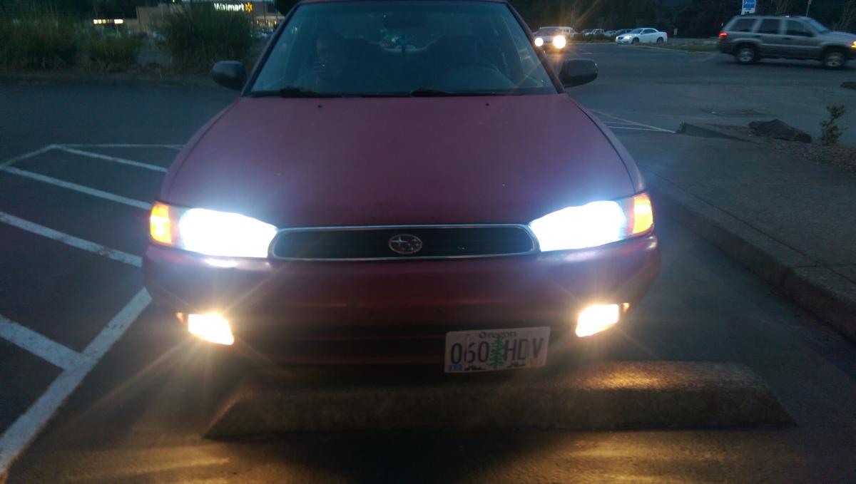

nicholi2789 Posted February 28, 2015 Share Posted February 28, 2015 In Oregon it is illegal to have your highbeams and foglights on at the same time. Still though it is nice to be able to have the choice to turn them on or off at will. On my 95 Legacy L it didn't have foglights installed but it had cutouts on the bumper for it. I went and bought a nice set of H3 style rectangular foglights and installed them myself. I wired it so I have a toggle switch under the steering wheel that operates independantly of the regular headlights. That way when I'm driving at night and I really want some serious lighting, I flip the foglights on with my highbeams. It's like spotlights. So bright. H3's are really bright little bulbs so I would never keep them on with my highbeams if other cars are around. One thing I would highly recommend if you just aren't happy with your headlight brightness is an HID kit. I know a lot of people are gonna flame me for saying this but whatever. I also wanted brighter headlights so I started looking into HID kits. I bought a full HID kit off Amazon that included the bulbs, ballasts, all necessary wiring, plus capacitors (reduces flickering) and a relay harness (protects factory wiring harness) for 60$. And it comes with a 2 year no spoob warranty. That's about what you would pay for two high quality Halogen bulbs from Autozone or something. I installed the Kit and those by themselves are 10X brighter than my stock halogens. Don't even need my fogs anymore, but if I flip them both on its crazy bright. Installing the kit was a breeze. Literally plug and play into the stock wiring. Took 15 minutes to install. I've had them installed for 2 weeks with no problems. A lot of people bitch about people with HIDs but I haven't had one person flash their lights at me since I installed them. I bought a 6000K H4 Bi-Xenon kit (make sure to get Bi-Xenon not Hi/Lo) and they are bright as hell and have that cool bluish tint to them, or if you don't like the blue order 4000 or 5000K bulbs. I Highly recommend HIDs. I am currently looking for some projector lens to furthur control my beams. Link to comment Share on other sites More sharing options...

nicholi2789 Posted February 28, 2015 Share Posted February 28, 2015 i wont go the hid route without projectors. i did that once on the bmw and hated the way the light came out of the stock halogen housing. my car is also a legacy l wagon witch did not have fogs from the factory i also installed them myself but i wired them like stock fog lights should be and used a subaru fog light switch. so the fogs only come on with the low beams. ive been thinking about rewiring them to be on anytime the headlights are on.Yeah i want a set of projector lens but they are extremely hard to find for this car. I did find a company that fabricates them tho. Honestly I don't see what the big deal is about projectors and hids. They are bright but not that bright. Nobody has flashed me at all. I woulda went the subaru stock foglight setup but these ones are better I think. Way brighter than the stock ones are. And I think they look cooler. I would however like to get them wired up so they turn off when the ignition is off but I'm not sure how to do it. I haven't looked into it that much tho truthfully. I've left them on for an hour plus and it didn't drain my battery. Which is weird. I think it's cause I have a 3 farad power cap on my stereo system. Link to comment Share on other sites More sharing options...
