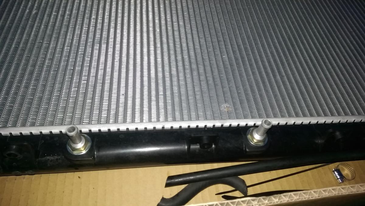

frustrated2 Posted February 21, 2015 Share Posted February 21, 2015 '95 EJ18, Manual, 210K I was replacing my radiator when I realized that the new one has two nipples on the bottom, facing the engine bay, that my old one does not have... at all... not even holes that have been plugged. What are these for? Can i just run some 3/8" heater hose to form a closed loop? Am I missing something here? Link to comment Share on other sites More sharing options...
danielzink Posted February 21, 2015 Share Posted February 21, 2015 Probably trans cooler lines... Pour some distilled water into the rad and see if it drains out the two nipples. If it doesn't - you're good to go. Cap 'em off or loop 'em. whatever. Dan Link to comment Share on other sites More sharing options...
Loyale 2.7 Turbo Posted February 21, 2015 Share Posted February 21, 2015 On 2/21/2015 at 9:32 PM, danielzink said: Probably trans cooler lines... Yes, newer Radiators comes with those pipes, intended for the Automatic Transmissions' Models. They sell the same radiator for Automatic or Manual trans models, because is easier to build only one style radiator, in case of manual transmission, you only ignore those pipes. Kind Regards. Link to comment Share on other sites More sharing options...
Fairtax4me Posted February 22, 2015 Share Posted February 22, 2015 Those are for the ATF cooler lines. All the new radiators come with them because its cheaper to make one radiator that fits both MT and AT cars. Also avoids returns when people try to put the MT radiator into the AT car and realize there's nowhere to hook up the ATF cooler lines. If it came with dust covers just put some silicone on them and stick em back on the ends of the nipples to keep dirt out. No coolant will get in there so no need to really seal it off. Just want to keep crud out to prevent corrosion inside. Link to comment Share on other sites More sharing options...
Loyale 2.7 Turbo Posted February 22, 2015 Share Posted February 22, 2015 On 2/22/2015 at 12:59 AM, Fairtax4me said: ... no need to really seal it off. Just want to keep crud out to prevent corrosion inside. Yes, what I've done in another cars where I worked, is to Loop together both pipes with a Hose. Kind Regards. Link to comment Share on other sites More sharing options...

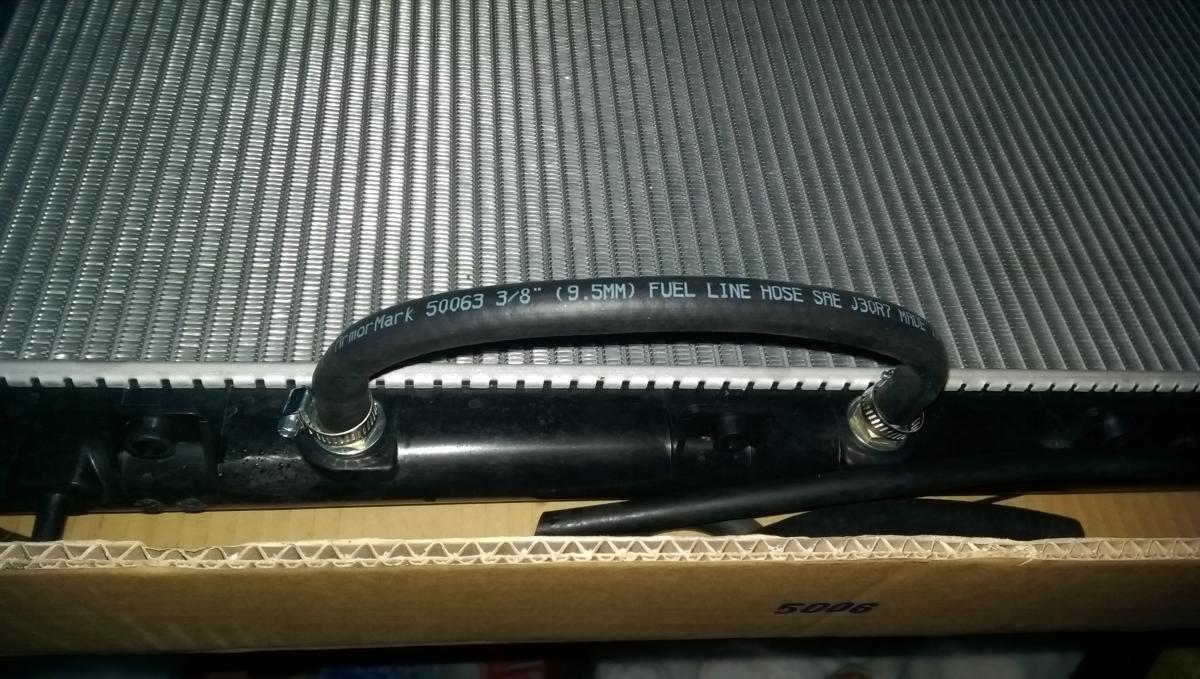

frustrated2 Posted February 22, 2015 Author Share Posted February 22, 2015 Thank you all for the input and advice. I didn't have the right size heater hose so I went with some extra fuel line that I had. 1 Link to comment Share on other sites More sharing options...
jp98 Posted February 22, 2015 Share Posted February 22, 2015 Why are you even putting a hose on it for? Unless it is connected to your transmission or something else with flowing fluid nothing will come out of it or go into it. I can understand capping the ends but the hose is unnecessary. Link to comment Share on other sites More sharing options...
Loyale 2.7 Turbo Posted February 23, 2015 Share Posted February 23, 2015 On 2/22/2015 at 7:58 PM, jp98 said: Why are you even putting a hose on it for? ... Is a easier / cheaper way to cap close the tips. Kind Regards. Link to comment Share on other sites More sharing options...
