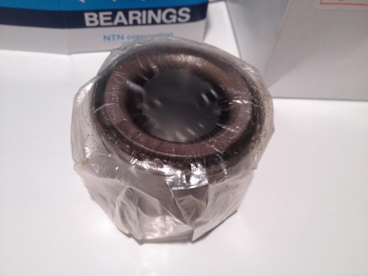

Luvn737s Posted February 27, 2015 Share Posted February 27, 2015 How do I pack such a large bearing? Link to comment Share on other sites More sharing options...
Fairtax4me Posted February 27, 2015 Share Posted February 27, 2015 Same way you pack any other bearing. You just have to do it from both sides. Pack some in, spin it a few times by hand, pack more in. Link to comment Share on other sites More sharing options...

Luvn737s Posted March 4, 2015 Author Share Posted March 4, 2015 The grease that came with it was only a preservative shipping grease, I bought a handy little packer since I would be packing bearings on an airplane once a year anyhow. I am very satisfied with the bearing kit from All Wheel Drive Auto. However, everyone says its traditionally the passenger side rear bearing on the old Foresters, but mine was the driver's side. Also, I re-learned to read the instructions when it comes to separating the axle shaft from the hub. Use a puller like it says, don't just whack it. 1000X easier! Link to comment Share on other sites More sharing options...
