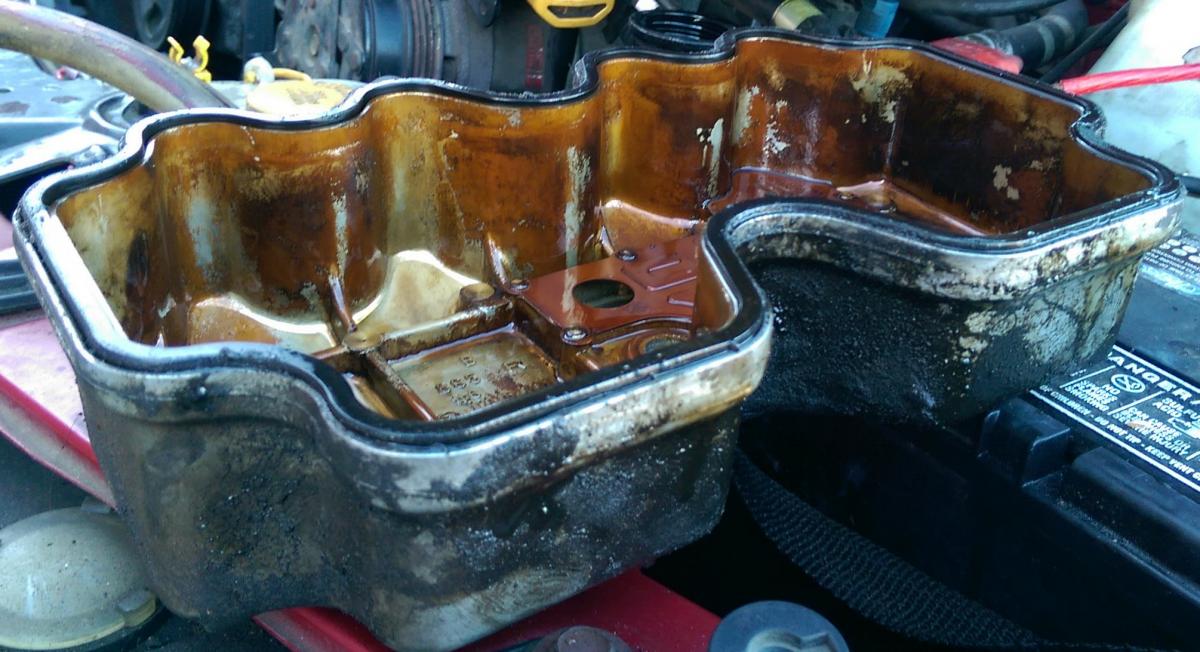

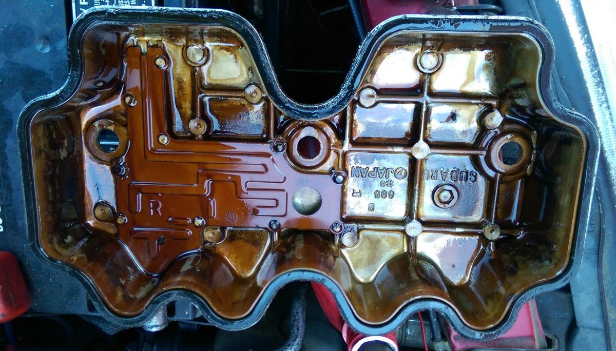

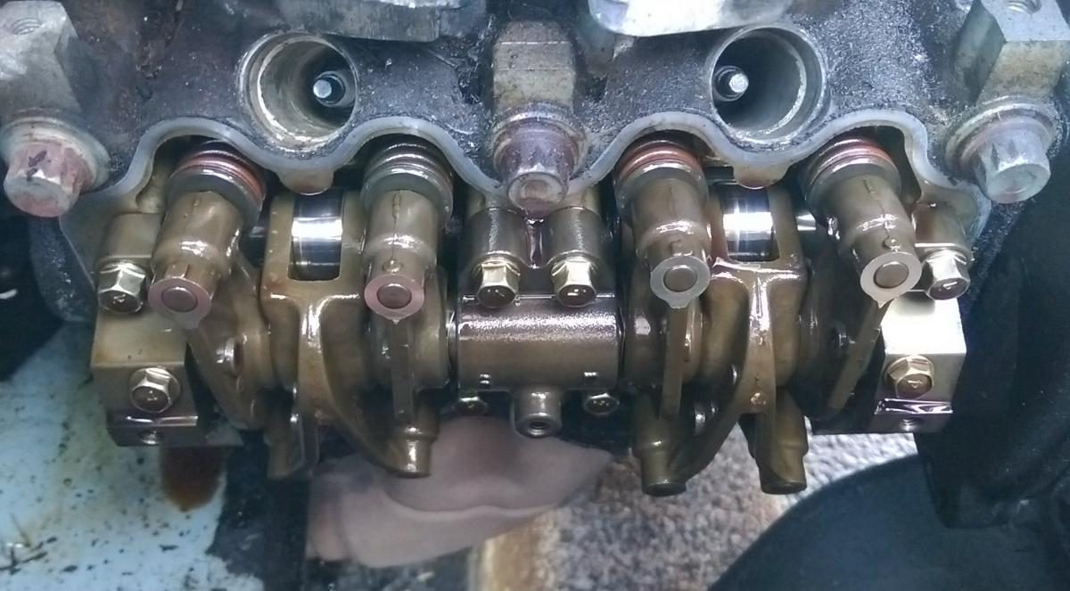

How did the inside of the engine look when you did the valve covers? Slightly brown is fine. If there's no major crusty buildup (like someone poured asphalt in the engine) then don't worry about the pickup tube.
Some light buildup/ crud is nothing to worry about, especially at 270k. Half quart of MMO in the oil will take care of most of that if you want it gone.

When I did the valve covers they weren't too rridiculously crusty. A little golden orange looking but not too bad I think. I cleaned them with brake cleaner anyways. And as far as MMO goes, someone suggested I use it a couple months back and since then I have put a quart in and ran it for the last 500 miles or so on the last two oil changes. I had to drain oil out to do it. I use Mobil1 high mileage synthetic 1040 now on my oil changes. Always have used high quality oil too. I'll see if I can get some better pictures of the pan. I think i have pictures of the inside of the valve cover gaskets before I cleaned them too.

Yeah you don't have anything to worry about as far as the pickup screen is concerned.
