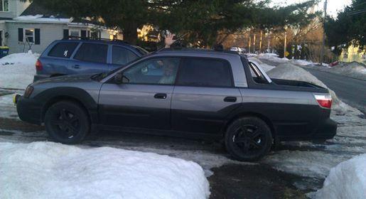

Just bought a 2005 Baja because I loved the look. Now I'm wondering what I can do about parts. It's got 150,000 miles on it and was bought from a "dealer" who got it at auction. I'm sure it's going to need something eventually, I'm just looking to find out what models and years have parts that I can match up.
Right now I'm looking for headlights and the sheild that covers the bottom of the car beneath the engine. Looks like someone removed it to change oil and never put it back.
