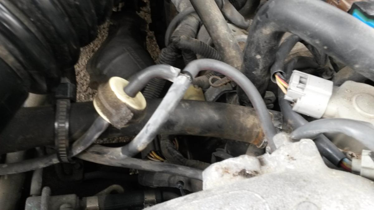

Ceramiclover Posted March 24, 2015 Author Share Posted March 24, 2015 (edited) The line on the passenger side was not very tight. and there was a hose going into the intake that was broken. What is this hose? It is right next to the Idle Air control Edited March 24, 2015 by Ceramiclover Link to comment Share on other sites More sharing options...
Fairtax4me Posted March 24, 2015 Share Posted March 24, 2015 The white cylinder is a small filter. That line goes to the MAP sensor on the passenger strut tower. The other line coming from the T goes to the fuel pressure regulator. Link to comment Share on other sites More sharing options...
Ceramiclover Posted March 24, 2015 Author Share Posted March 24, 2015 So they are just air lines? Would they have an effect on mpg? Wondering if it was looking lean from intake leak, so it enriched fuel. Link to comment Share on other sites More sharing options...
