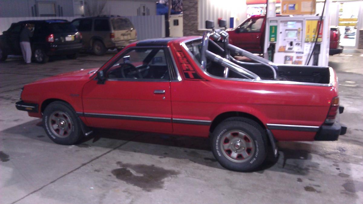

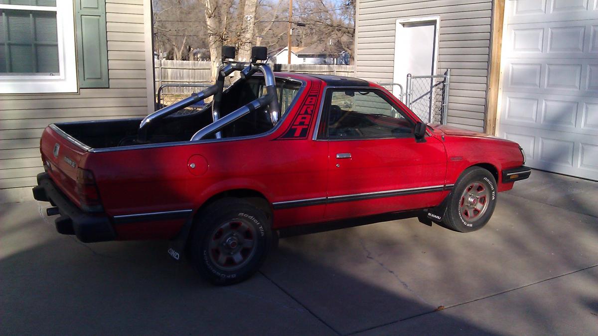

el_freddo Posted March 25, 2015 Share Posted March 25, 2015 "I'm El_Freddo, and this is my Brumby Story:" Ok, time I "came clean" about the Redback Brumby. This is how I picked her up about two years ago. AFAIK I'm the third owner: The previous owner was a bit of a talker/player. I went out to check her out as a bit of a tease for me, it was local enough for the drive - I've always wanted a targa top since Sunnie the Brumby that we got for my mother inlaw. I would've loved a blue one but beggers can't be choosers. The owner said a fella was coming up from Melbourne that weekend so I bid him good luck, he was asking too much for my liking. 6 weeks later it was still there so I made an offer - he still played a hard card so I told him to offer it to the other guy at the price he mentioned and I let it be. Less than 5 mins later he called me back and said deal.As you can see from the pic above there's some front guard damage, pity, it's pretty straight otherwise! The engine wasn't working - reckoned it just stopped one day on the way to work and has been sitting like this for 6 months. I thought blown HGs straight up - empty radiator and creamy oil told the story. In the tub it had a rubber mat that concealed some foundation sand/packing sand (the orange stuff) that had held the moisture and rusted the middle of the tray. The main areas where rust shows up were pretty decent which I was happy about.After getting her home she moved around the yard a few times before making it into the shed for some work. Family photo: First up was pulling the engine - pretty easy in these things! I had to entertain dad as a decoy for his surprise 65th - he sat and watched for most of it :/ Once on the stand we drained the "oil": Second bucket: ~15 litres of water and oil in total. Now thinking major head gasket and a possible engine replacement. Continued stripping the engine before jumping to conclusions though.Heads removed, such a pretty sight (not!). Never seen this before: This was the culprit - and the previous owner's story checked out at this point: That's a Welch plug that dropped out, dumping the entire contents of the radiator into the engine, stopping things pretty quickly I'd imagine! After getting busy with work and other things (4wd trips etc) Dad came up and put the long block back together for me while I was at work - this saved me loads of time! Once the engine was all back together I got it running - it blew a lot of blue smoke and I shat bricks. It was also running as rough as guts. Turned out that I needed to adjust the valve clearances better than I did - it was running on two cylinders, just. Once all 4 were back online it blew more blue smoke. Not happy Jan! This finally cleared up and ran without any smoke. Very stoked. One of the things we had to do was remove rust from the bore. This was a cheap build for a daily cruiser - so instead of a rebuild or even a hone and new rings we hedged our bets and went this way. No1 cylinder had a couple of small pits at the very top of the cylinder so we left it this way and ran with it.Now it was time to look at other parts of the vehicle. Redback got her name when I was working on the rear end pulling drive shafts off that had probably never been removed before. While hammering away a redback dropped out from behind one of the rear wheels. Sorted that one quickly! It wasn't the last - I think there were five all up from memory, so a name was born for this beast. The rear bearings were an unknown and seemed rumbly and one of the rear brakes was leaking. So after a small investment in parts: This was done: Rear end being worked on: Rear diff was out as well, swapped in for one that leaked less instead of swapping seals! Home made tool for bearing retainer nutremoval: All coming back together well: "New" rear drums were sourced from one of the parts bombs, the originals had a decent 2-3mm groove dug into them! The new ones barely looked like they'd been used!Then it was off to a mate's place for some detailing - 4 hours of degreaser and pressure washing! Only got a phone pic of that, it's not been uploaded At some point, either in the transit there or back I managed to get a stone chip in the windscreen, just a small one but right in thedriver's view. Again, stole a windscreen from a parts bomb. This one cleaned up very well - I was stoked. This also gave me the opportunity to replace the old hard windscreen rubber and tackle the rust that I knew was under the front right corner: Putting the windscreen back in - always fun. Had to look it up on ausubi as to how I did it last time on Sunnie the Brumby. Oncethat was read the windscreen was in within 20 minutes: A new heater hose above the water pump was sourced - I use another unit from a Toyota Camry, just trim to size: A few other things along the way and it was time for a roadworthy inspection: ^ I didn't like the original rims, different offset and to me they didn't look that great on this brumby. I also had a set of black sunnies in the shed with my snow tyres on them which easily swayed my decision. I reckon they look way better even if they're only 13 inch and don't fill the guards. So she didn't pass first go. A few excited rookie mistakes: 1/ Didn't fill the wash bottle 2/ Didn't bolt down the passenger's windscreen wiper arm, so that didn't move! 3/ Apparently I had a front indicator that was blown - I didn't find it on my check so dunno where they got that from. and 4/ worn front uni joint on the tail shaft. I fixed the other easy little issues straight up, had to order in the uni joint so got two and did them both at the same time. I also smashed my thumb pretty good doing this - only now is the damaged nail almost grown out about 6 months after the event!Once those things were sorted the RWC was issued and I was off to rego. Vicroads now make it nearly impossible to get an appointment! I was pissed that I didn't get one before the weekend, but got one Monday and had to take some time off work to do it - just frustrating! The blessing was that my birthday/christmas/birthday pressie rocked up in the mail at M&D's (home base for important mail!) - so I was able to use them during the rego process, saving me some extra coin on not needing new plates: At Vicroads just after rego was granted: Back at home: Used her for driving to work, loved it! Didn't have to worry about rain (I'd been on the scooter prior to this!)And of course, hanging with the family members: Since this pic Dad borrowed Redback for a few months. I missed the old girl, the scooter's fun but there's just something about abrumby, plus it can do over 55kmp/h without trying hard. It's easier to speed in that Ruby Scoo IMO.While Dad had her M&D headed overseas and I had a conference close to their place, so my wife and I crashed there and I drove to the conference in Redback. The issue that came up after frying a few alternators (dad went through this issue) was a severe lack of performance - the exhaust would become blocked at certain levels of acceleration. This got worse until I was stuck on the way to the conference travelling at 60km/h, and that was before hills! Not fun! Pulled another Y pipe from the parts bomb and that sorted it. This wasn't an ideal fit due to some spacers on my EA81 for the ERG system that wasn't on the earlier year parts bomb, but it works and Redback goes very well for an EA81!I've also got to fix the choke - dunno what's wrong with it but it doesn't work properly. The carb could probably do a with a rebuild too, she runs too rich overall for my liking. I've solved the slop in the gear stick with the classic slot and bolt arrangement: The Welch plugs were sorted by Dad's idea - massive grub screws/threaded plugs: They've worked a treat! I've been hunting for a bullbar - found one in Talem Bend, South Australia, got a mate to pick it up for me. So I need to roadtrip to the city of churches to pick that up soon. I've since found an ideal bar that fits the bill for what I want. If all goes well the first one purchased might end up on Sunnie the Brumby if it's better than the one already on her. I've also been tossing up the idea of a lift kit, but it really comes down the right price at the right time - I don't want to go allout like Ruby Scoo lift/tyres.One thing I would love to do is make the engine run with the stock L series MPFI system. I'm a true believer in EFI over carb setups. I don't know if I can do this due to space constraints without converting the auxiliaries to the EA82 setup - not an easy task unless you've got the EA81 turbo brackets and crank pulley.Also an AWD gearbox would be great. Will have to build one up and fit it in at some point. EA casing an EJ gearbox can be done without issue over here with a dual range gearbox.Cruise and remote central locking would be sweet and I'd like to add a neat little tacho, oil pressure and coolant temp on the steering column in a manner that doesn't cover the other gauges. It's just a case of time and money for those things - after all this is meant to be a cheap build!CheersBennie 4 Link to comment Share on other sites More sharing options...
Dinky26 Posted March 25, 2015 Share Posted March 25, 2015 Nice, very NICE! Reminds me of mine. Link to comment Share on other sites More sharing options...
