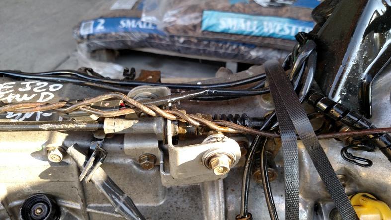

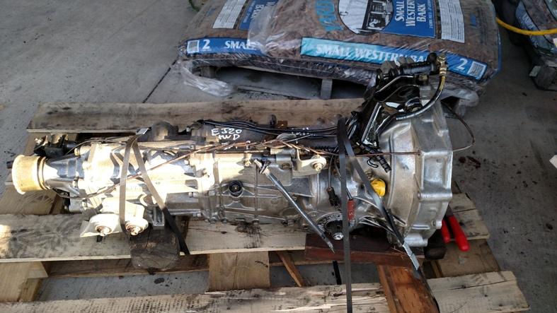

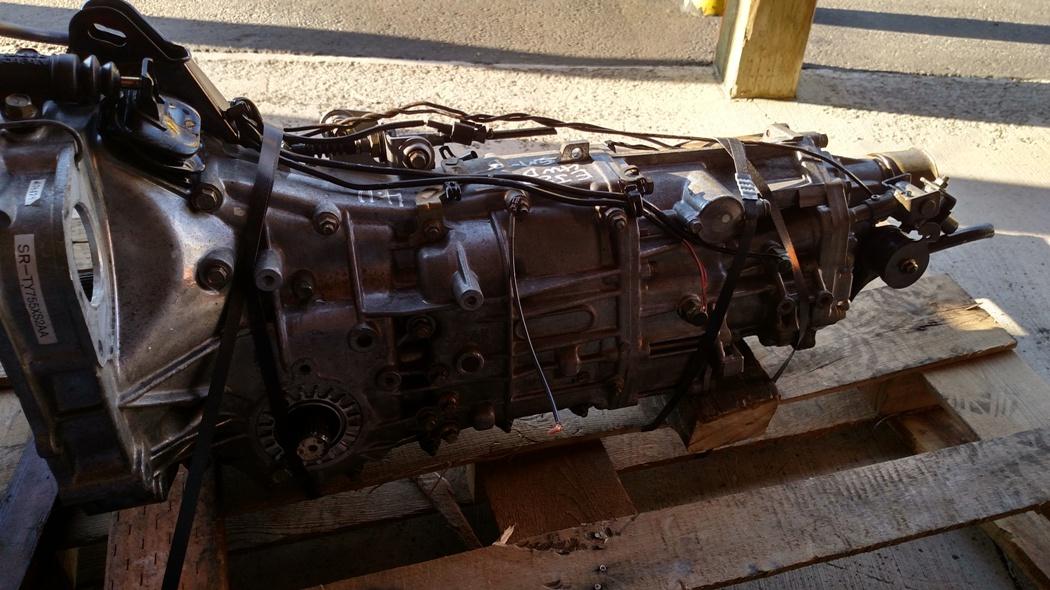

wirelessenabled Posted May 7, 2015 Author Share Posted May 7, 2015 (edited) Pics of the transmission. The heavy black wire is holding the transmission to the pallet for shipping. Closeup of the dual range shifter. Edited May 8, 2015 by wirelessenabled Link to comment Share on other sites More sharing options...
wirelessenabled Posted May 11, 2015 Author Share Posted May 11, 2015 (edited) I figured out the hi range / lo range. Counted turns on the input shaft to turns on the front drive stubs. Hi range is with the dual range lever in the aft position. Lo range the lever is forward. If I am figuring it correctly it also seems that the gear change is 1.44:1 when in lo range. Everything I read seemed to indicate that the ratio was 1.19:1. Here is how I checked. Put the transmission in gear. 1st I think. Turned the input shaft with the old clutch disk. In hi range I counted 14.25 rotations of the clutch disk to 1 rotation of the front drive stub. In lo range it was 20.5 to 1 rotation. 20.5/14.25=1.44 or so. Edited May 11, 2015 by wirelessenabled Link to comment Share on other sites More sharing options...

Caboobaroo Posted May 12, 2015 Share Posted May 12, 2015 (edited) I've left them in high and run it without and linkage before without any issues. Just remove the bracket and what's left of the cable from the transmission and hold onto it for later. Edited May 12, 2015 by Caboobaroo Link to comment Share on other sites More sharing options...
wirelessenabled Posted May 18, 2015 Author Share Posted May 18, 2015 I installed the dual range transmission today in my 2000 OBW. Fit in fine with no problems. I ended up just leaving the dual range linkage, or what was left of it, bolted on the tranny. It made a convenient place to zip tie the lever in high range. Now just need to find the time to make a shifter for it Link to comment Share on other sites More sharing options...
