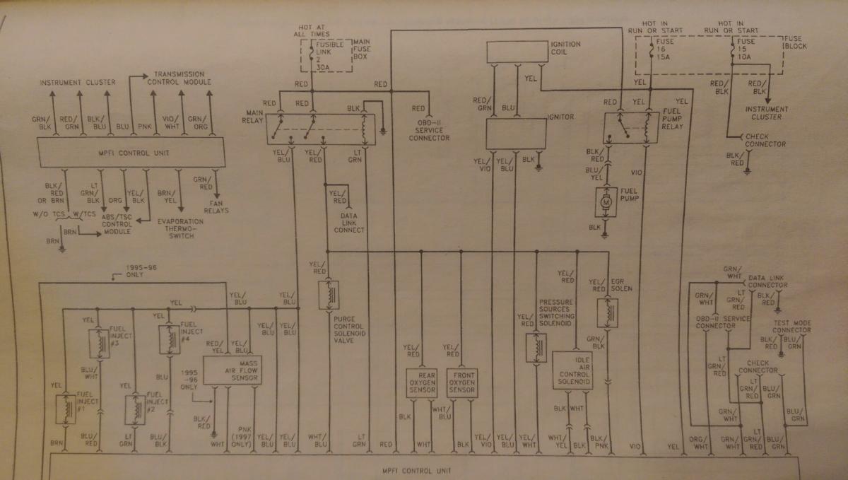

Cougar Posted May 26, 2015 Share Posted May 26, 2015 You're welcome for the help. I didn't look at things carefully before. The fuse I was referring to earlier is SBF-2 and is located in the panel under the hood. That fuse ties to a black/white wire out of the fuse panel and goes on to the fuel pump circuit along with some other things. Make sure power is at least good there. If so, then check it at the relay and see if that it is okay there. This where having a meter and knowing how to use it helps pin down problems. Link to comment Share on other sites More sharing options...
Nickjon Posted May 26, 2015 Author Share Posted May 26, 2015 Here is the electrical schematic from my Haynes repair manual. Apparently there is a different colored wire that exits they relay from the wire that enters the terminal at the fuel pump. Blk/Red and Blu/Yel respectively. And the fuse is #16 saying it a 15A? I am going to go check SBF-2 Right now as well as test the volts at the terminal as I try to start it. We will see how it goes. I hope I can fix this. I love my little subaru and if I don't get it I am afraid my wife will make me get rid of it. YIKES! Link to comment Share on other sites More sharing options...

Cougar Posted May 27, 2015 Share Posted May 27, 2015 Fuse SBF-2 does supply power to the main relay also and there is a suspect connector between the fuse panel and those areas. The main relay does (correction, does NOT) provide power to the pump. My info shows a black wire with a red stripe ties to the pump motor. If that isn't what you have then what color do you have for that connection? The return wire should be black. When making voltage tests and especially when you are looking for a bad connection it is best to leave things connected so the voltage will drop across the bad connection due to the current draw through the resistance. Probe the back side of a connector to take a reading or use a pin to pierce the insulation and probe the voltage that way. I would only do that if necessary as it leaves a hole unless you put something like silicone adhesive on it. To check for power place the common meter probe on a known good ground point and measure the voltage using the other probe. Link to comment Share on other sites More sharing options...
