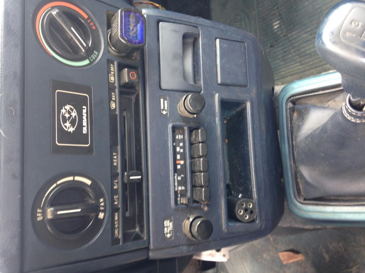

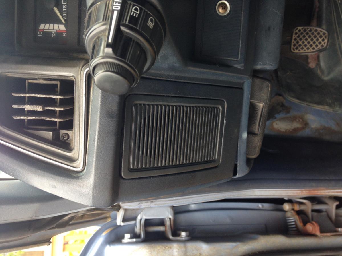

For the moment I have the stock one, and I want to put a speaker in the left hand side, as well as rumor has it to replace the one under or around the glove box.
Really all I want to do is listen to me AM radio, maybe a little FM now and then, but I don't stray too far away from news, podcasts, or NPR when I'm driving.
I'm super boring.
Good idea on the shallow head unit. I never listen to CDs and I'm willing to bet there are shallow head units that will have a usb or aux input for media on my iphone.
