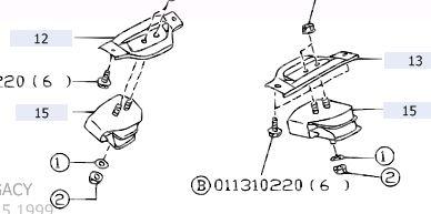

Are turbo motor mounts different then a n/a motor? parts store says no but the right side motor mount did NOT want to go into its slot. Not at all. I got i eventually but it stretched the mount pretty good and i only barely got it threaded, see pic string.

I would believe that i put the mount on wrong, as that kind of things happens all the time, does anybody feel like going out to their Touring Wagon and maybe snapping a pic of the right motor mount? Im sure i will just replace it again down the road as i dont like how it went together anyway, i was just out of time and patience at that point.

>>Google EJ22 engine mounts and you'll see how they look. (my work blocks most pics so  no links.)<<

Both mounts are the same part number, made by Anchor, i don't remember the number, just that they were the same. I even called O'Reillys to double check that the same part number was both sides and they said yes. Not that i really believed them i just had no other source of info at the time so i went for it.
The 'cushions' (rubber part)   - as Subaru calls them, are the same. The brackets they mount to are not.
Mounts -see attached.
Part numbers:
Bracket complete-front, right         1
41031FA000
alternate: 41031FA080
