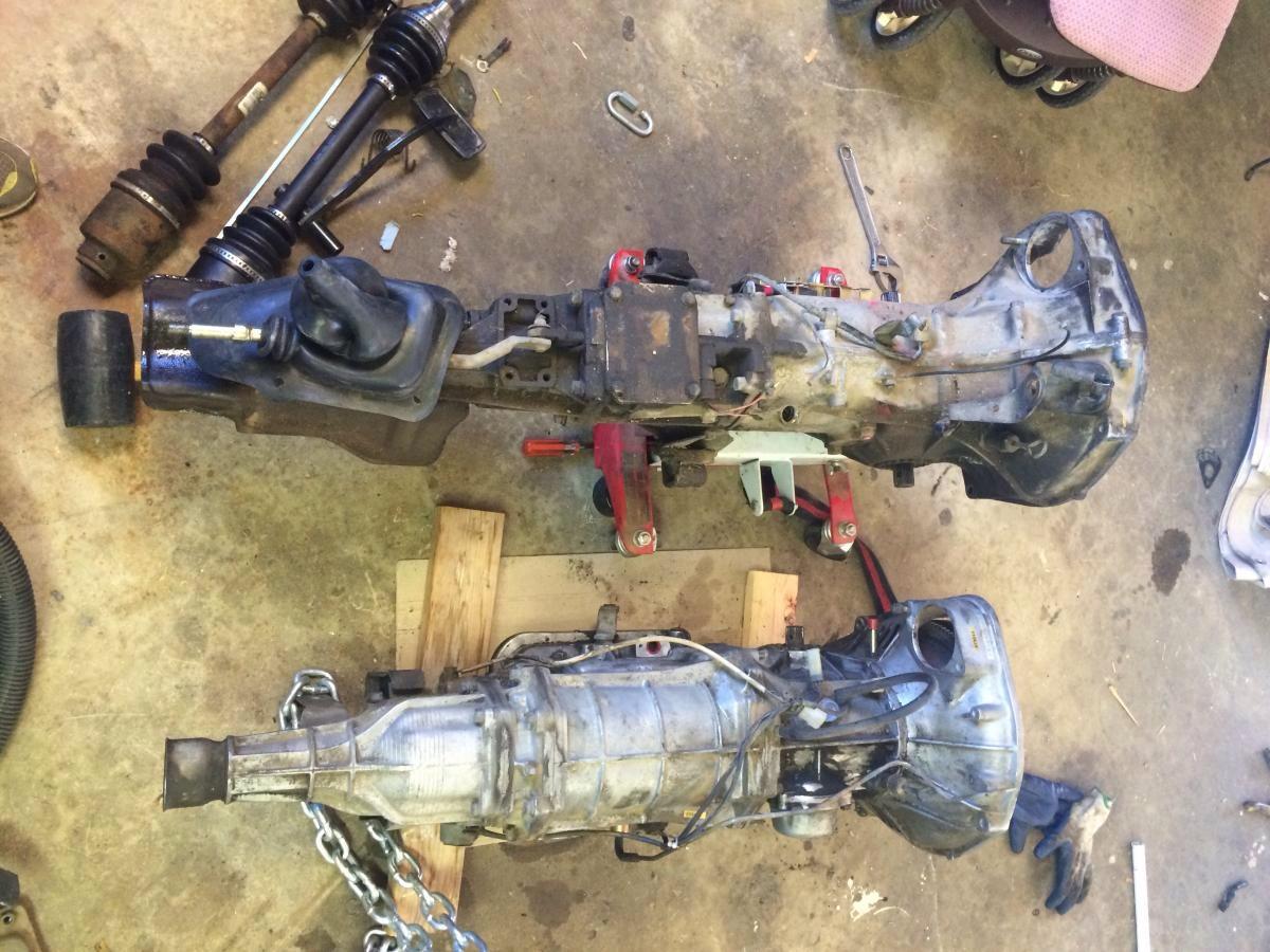

ihscout54 Posted June 12, 2015 Share Posted June 12, 2015 (edited) You have asked similar questions 3 or 4 times now over several months. Is this car at a shop? These cars dont have a seperate xfercase like your brothers blazer, its all one tranny. I can only guess that you have a 3at 3speed automatic and the fluid is leaking into (or between) the front part of the trans which is the final drive or vise versa. On this transmission the 4wd portion that one might call a transfercase uses the same atf that the tranny uses. The final drive which is in the front of the trans takes gear oil. Finding another tranny is physically easier than replacing that seal. They are getting scarce tho. Look at this pic, the auto trans is on the bottom. You can see 3 divisions in the body of the tranny, from left to right (back to front) : 4wd> trans> final drive. . Edited June 12, 2015 by ihscout54 Link to comment Share on other sites More sharing options...
