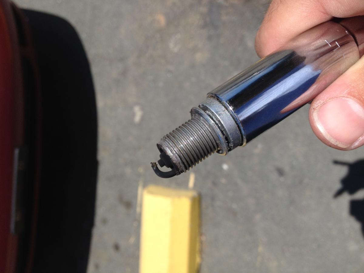

subakev Posted June 13, 2015 Author Share Posted June 13, 2015 I picked up new wires a and regapped my plugs (they were way off!), next time I will gap them myself. The idle is still rough, running up and down, but no where near as bad as before. And now the check engine light is back on. But the car runs much better now, I was able to drive it around the block without and knocking, hesitation or stalling. It was also suggested that I clean my throttle body and that the injectors needed cleaning. I've got some lucas oil additive to help with the injectors. I've been told that cleaning the throttle body is typically easy enough, but it seems intimidating to me. I know that subarus are tricky to adjust the idle on, and I dont know if taking the the throttle body off to clean it will mess with that. what do you guys think? When i took out a plug there was some kind of crud on it. These plugs hadnt even run for 20 minutes before this Link to comment Share on other sites More sharing options...
desertsubaru Posted June 13, 2015 Share Posted June 13, 2015 Were all the plugs like that or just one? That is not good. Either buy or rent a compression checker to check compression,Should be up around 170 psi. Link to comment Share on other sites More sharing options...
xdeadeye1 Posted June 13, 2015 Share Posted June 13, 2015 what the heck is that stuff? did you drop it before taking picture? Link to comment Share on other sites More sharing options...
subakev Posted June 13, 2015 Author Share Posted June 13, 2015 Just one plug, cylinder 4. It came right off, wasn't very sticky. I didn't drop it or anything. Maybe I it rubbed against something when I put it in or pulled it out and I didn't notice. I will check into the compression, I will have to look up how to do that. Also I should probably pull the plug in a few days and check it out too huh? Link to comment Share on other sites More sharing options...
desertsubaru Posted June 13, 2015 Share Posted June 13, 2015 (edited) Yes I would definitely keep an eye on that cylinder. Compression check is easy. Buy a compression gauge, then take all 4 plugs out and disconnect the coil power wire. Screw gauge into spark plug hole then crank it over three times with starter and look at reading on gauge dial. Repeat for each cylinder. Should be up near 150psi at the least and at 170 to be in manufacturers specifications. Edited June 13, 2015 by desertsubaru 1 Link to comment Share on other sites More sharing options...
Fairtax4me Posted June 13, 2015 Share Posted June 13, 2015 Ehhh kinda looks like you may have a compression issue on number 4. Burned valve, or broken ring land possibly. How long has it been running rough? Link to comment Share on other sites More sharing options...

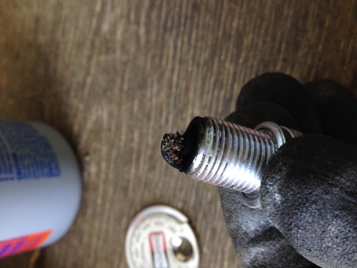

subakev Posted June 15, 2015 Author Share Posted June 15, 2015 My plugs are fried again already, in a matter of a few days. They are blackened and have a 'burnt smell' to them. one had a bit of crud on it, but not as much as in the previous picture. Here is a new picture, they all had the same blackened look to them, but only one had the crud on it Link to comment Share on other sites More sharing options...
