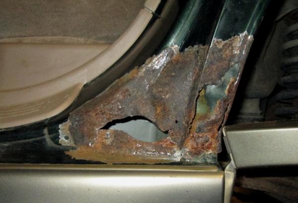

bratman18 Posted June 18, 2015 Share Posted June 18, 2015 The early 2000 Legacys around here are all rusted out. You can open the rear doors and see rust holes in the top of the rocker, and in the wheel arch. And they still rust in the normal rear quarter area as well. So I'd say the ones you're seeing are just clean. Link to comment Share on other sites More sharing options...

WoodsWagon Posted June 18, 2015 Share Posted June 18, 2015 The 00-04's are all rustbuckets around here. As bratman said, the rear dogleg and the triangle inside the rear side door openings where the rubber door stop hits are a major trouble spot. It's caused by a lack of seam sealer on the pinch weld at the front of the wheel arch. So are lots of the rear subframes, where the lower links attach. And the usual spot on the rear quarters at the back of the wheel well. 95-99's the rear strut towers go bad from inside the wheel well. Door bottoms rot out. Rear of the rockers rot out. Gas tanks rot out right around where the filler tube nipple goes in, as well as the filler necks rotting out. Rear quarters of course, and rear subframes occasionally. 1 Link to comment Share on other sites More sharing options...
