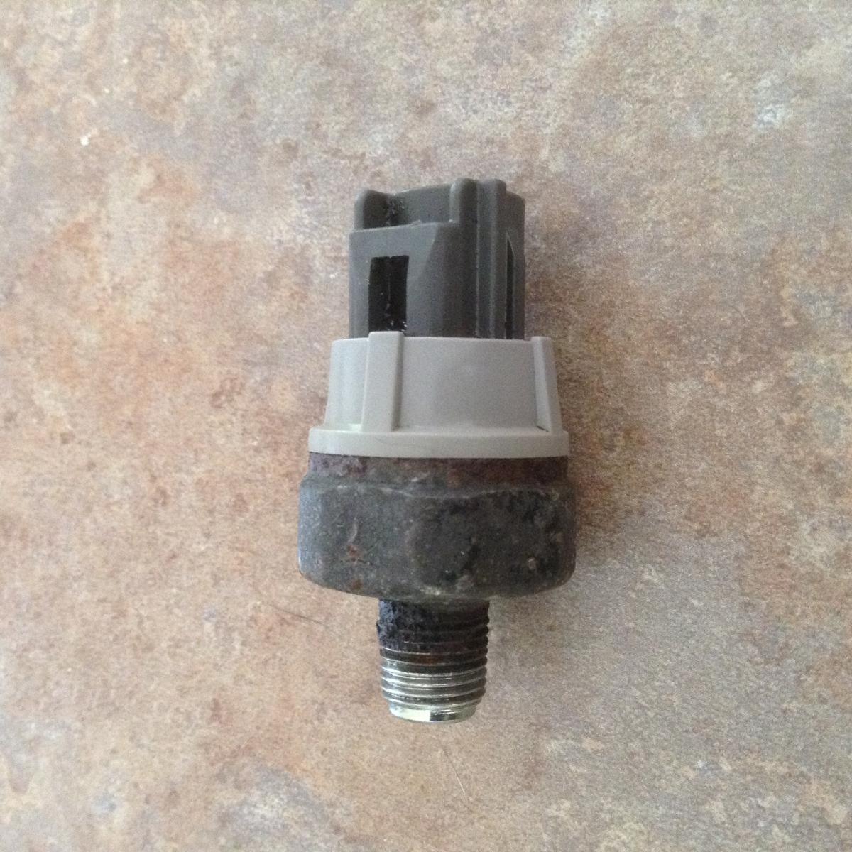

scottsheppard@videotron.ca Posted June 24, 2015 Share Posted June 24, 2015 Hey folks Per my last post on another thread, I thought my recent head gasket job with all the various seals and gaskets got messed up as I have a good leak dribbling away...I thought rear main was botched...when I took the intake manifold off I saw this...could it be that simple? If so, what is that sensor....looks like it even leaking up thru plastic electrical connection....similar to the oil sensor issue common on these ...anyone with any ideas or experience? Link to comment Share on other sites More sharing options...
scottsheppard@videotron.ca Posted June 24, 2015 Author Share Posted June 24, 2015 Well, confirmed. I took the sensor off and tried to bow a bit of air thru it with the air knozzle....oil came out of there likes Texas well...off to buy two so I can replace both... Link to comment Share on other sites More sharing options...
Fairtax4me Posted June 24, 2015 Share Posted June 24, 2015 I think that's the VVT pressure sensor. I've read of several occasions of those leaking. Happens with any pressure sensor after a while. They don't last forever. Link to comment Share on other sites More sharing options...
CNY_Dave Posted June 25, 2015 Share Posted June 25, 2015 Are those the ones some people thread in too tight and crack the head? Link to comment Share on other sites More sharing options...
