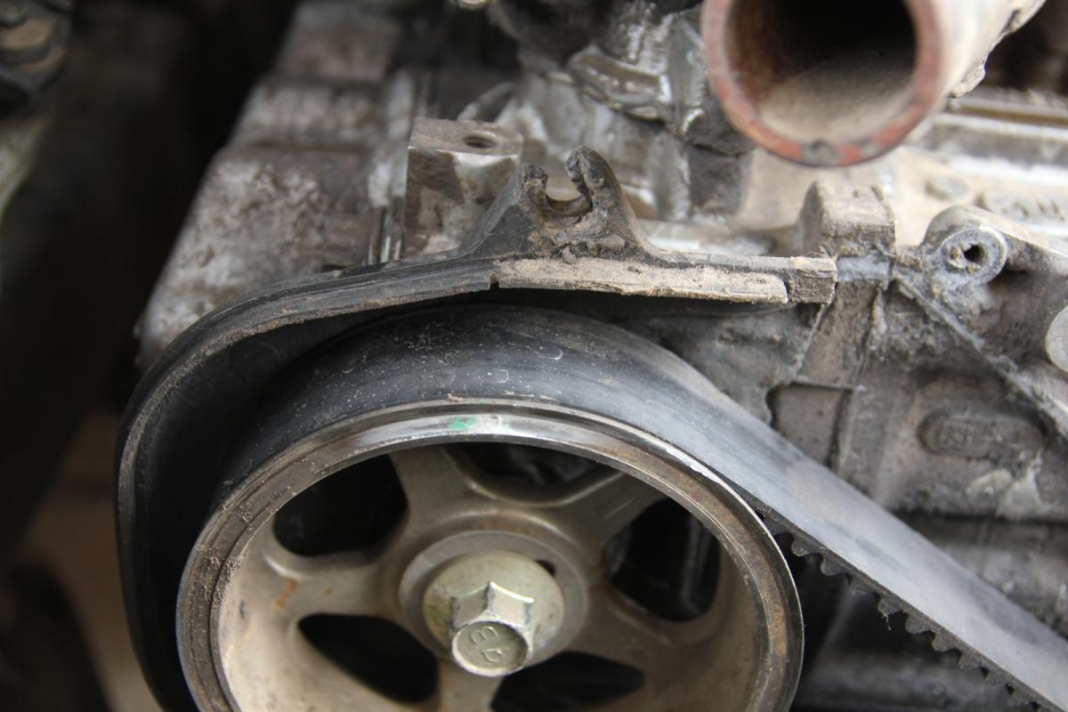

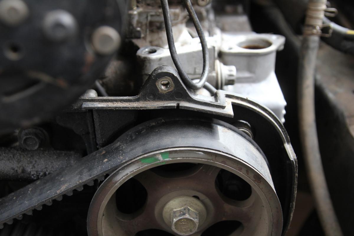

edek Posted June 28, 2015 Share Posted June 28, 2015 Hi, i`m writting from patagonia....i own a 1994 gx legacy, and want to ask for help.....i changed a bad head gasket and replaced the timing belt......the matter is....i put the crank and camshaft marks right up ...all in coincidence...but the number of teeth on the belt did not mach ....i have 40,5 teeth on the drivers side but not 44 on the other.....the engine is running in this condition for the last 10000km ....Is this normal ?? or what ould be the problem....I repeat all three marks on the wheels are ok aligned with the block and covers ones....but if i respect the belt teeth count i need to advance in two teeth the non-driver side cam pulley...... Some idea ?? Thanks in advance !! Link to comment Share on other sites More sharing options...
Fairtax4me Posted June 28, 2015 Share Posted June 28, 2015 If all of the timing marks line up, and the engine runs smooth, then it's properly in time and you don't need to worry about the tooth count. Link to comment Share on other sites More sharing options...
edek Posted June 28, 2015 Author Share Posted June 28, 2015 Thanks fairtax4me !! there is a little knock comming and going away interitently....i think is hidraulic lasher problem...but equally tha engine runs nnot as smooth like i want....it seems to misfire on one cilinder.....i changed plugs and wires...but idle speed is not smooth as this boxer engines uses to run.......when i first opened the timing "box" i saw that left cam pulley and crank gear where in position....the right cam pulley was two teeth to the left....i have some photos.. Link to comment Share on other sites More sharing options...
Fairtax4me Posted June 28, 2015 Share Posted June 28, 2015 Yes, that is out of time. Those pics were taken before you put the new belt on? Can you take pics of the marks as they are now? Link to comment Share on other sites More sharing options...
