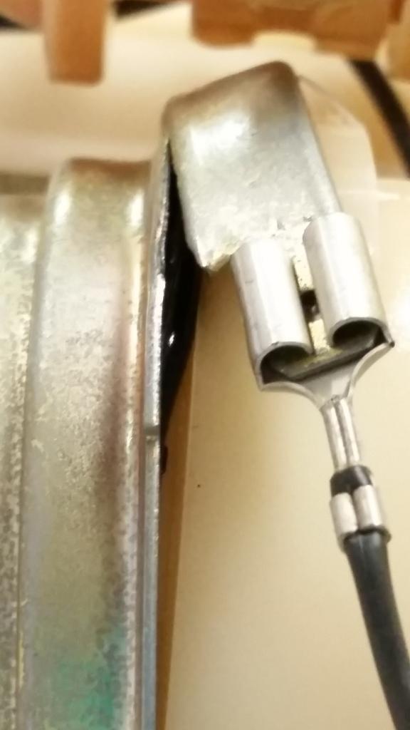

wrsub101 Posted July 23, 2015 Author Share Posted July 23, 2015 Thanks all for your help. It was the metal cap/oring. When I pulled the pump, the cap was cracked at one of the tangs and the o-ring was protruding. the ring looked like it was swollen to a larger size, and didn't fit well into the cap. Found a used but broken assembly with an intact cap at a junkyard for $22 and a new pack of viton o-rings at Amazon for $10 and I was all set. It runs perfectly now. I attached a picture. You guys are great... you saved me hundreds of dollars, plus it was fun going to the junkyard and getting this fixed. I didn't know this could still be done! Link to comment Share on other sites More sharing options...
