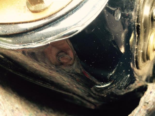

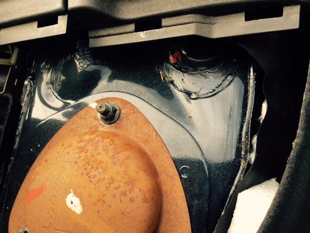

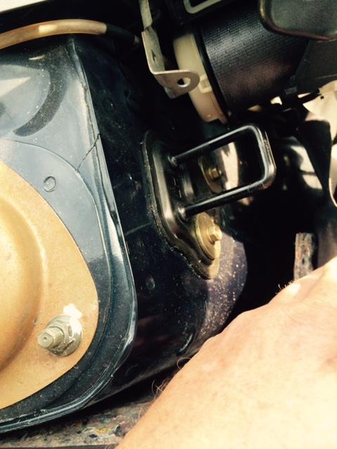

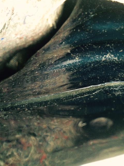

desertsubaru Posted July 12, 2015 Share Posted July 12, 2015 Look on the inside of the car. You may have to take the carpet up to see the strut towers. Look to see how much rust is in there. Take pics if you can. Link to comment Share on other sites More sharing options...

mikeamondo Posted July 13, 2015 Author Share Posted July 13, 2015 Strut towers are rock solid on the inside :...! Shiny like new! So can I assume the old boy's got at least a couple years left in him? Link to comment Share on other sites More sharing options...
mikeamondo Posted July 13, 2015 Author Share Posted July 13, 2015 hmmm.. tried attaching a pic to that last one from my phone, but no go... I'll try to post some pics of the towers later this eve.... Link to comment Share on other sites More sharing options...
mikeamondo Posted July 13, 2015 Author Share Posted July 13, 2015 Here we go.... 4 pics attached of the interior side of the strut towers... thanks Link to comment Share on other sites More sharing options...
