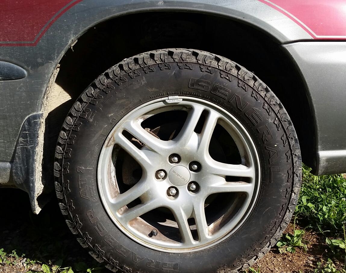

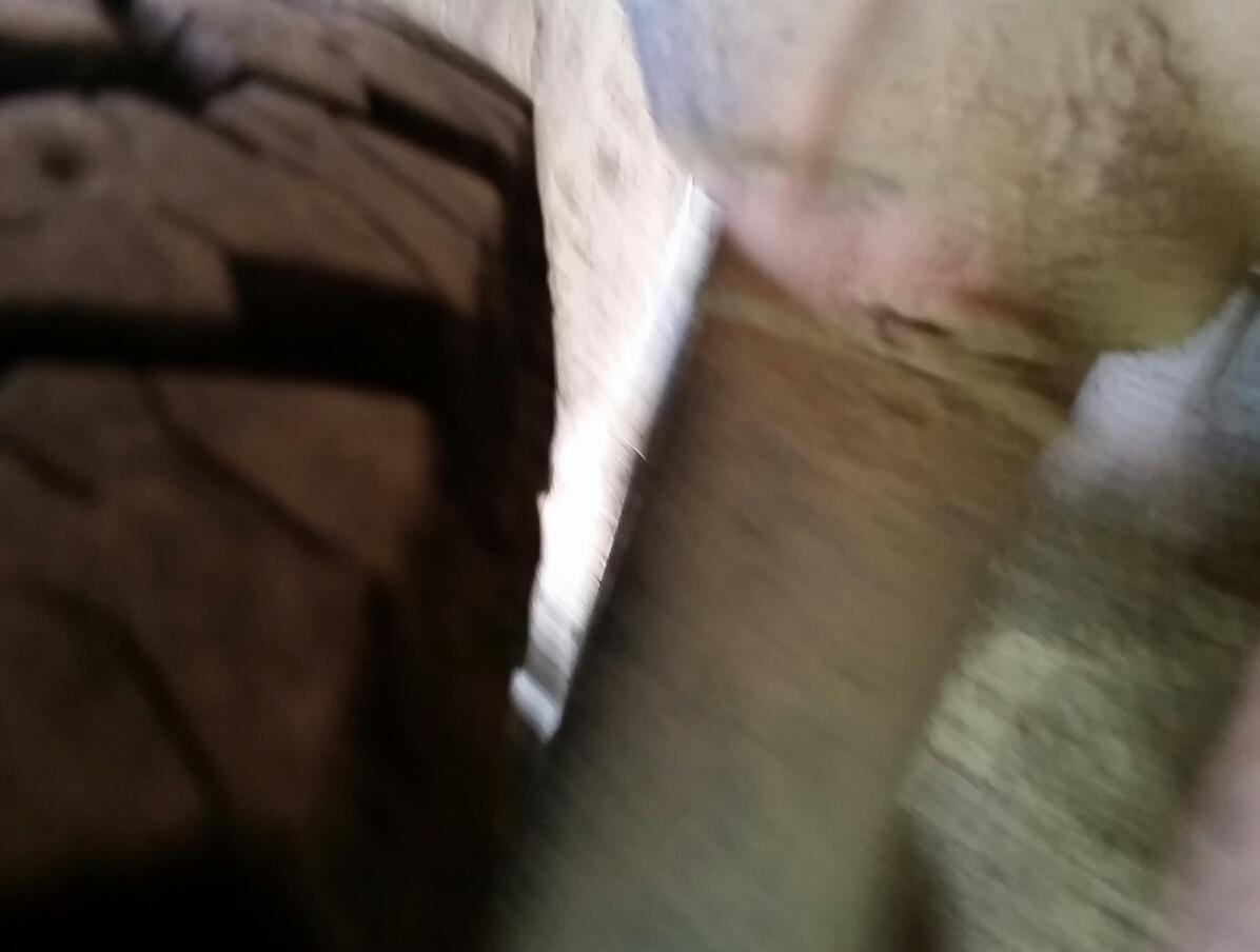

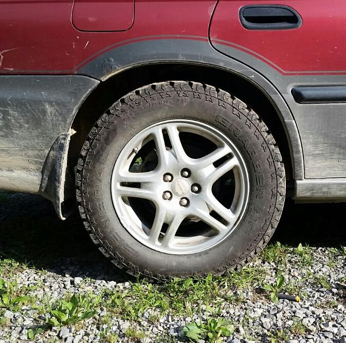

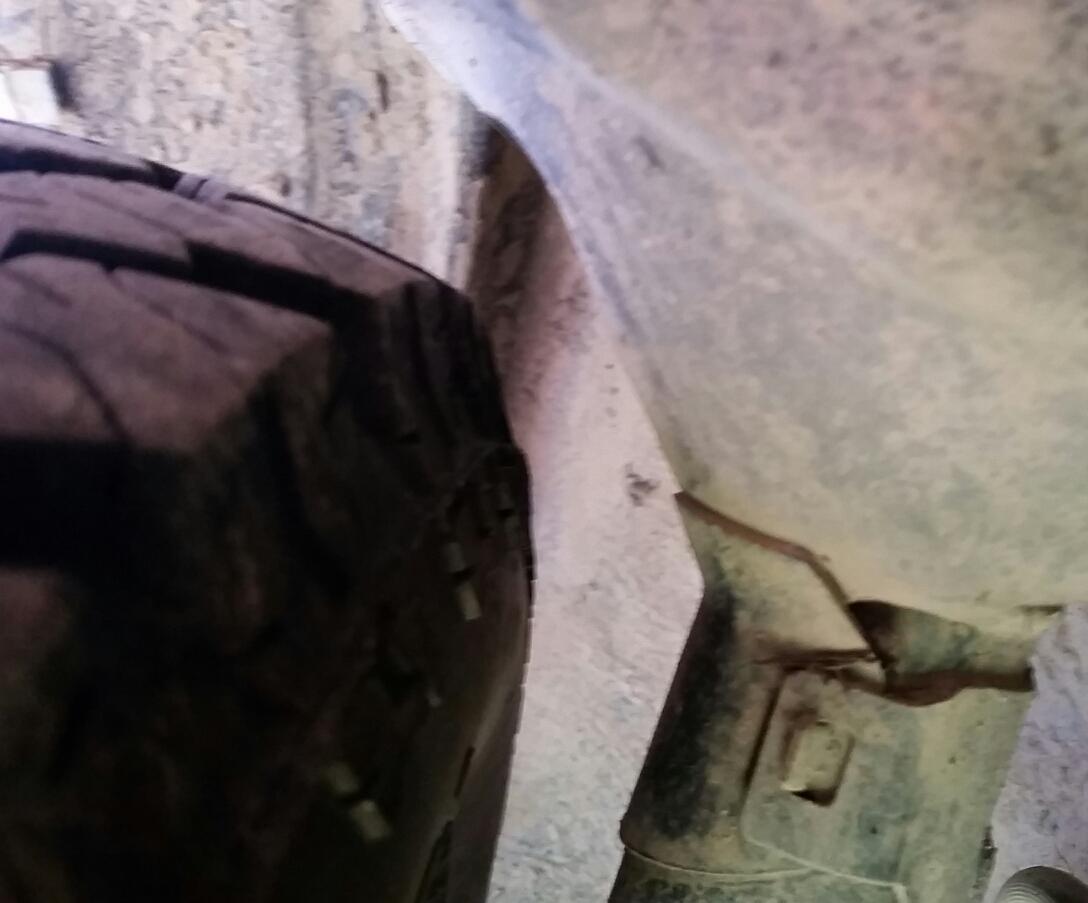

raleigh800 Posted July 15, 2015 Share Posted July 15, 2015 I needed new tires and given I live on a pretty rough dirt road and have a secondary road with 7 stream crossing I can use to get to work I decided a decent off road tire would be nice. I found a lot of good info on this site and others regarding different tire sizes that would fit but never saw anything with the exact combo I was looking for. so I thought I would share the setup I ended up with. I have a 1996 Legacy Outback Wagon that a previous owner put 16" rims on. I ordered 235/65R16 General Grabber AT2's for that online tire rack place for 525.00 shipped. Attached are a couple pictures showing the front and back of the car, as well as the strut to tire clearance. It's tight but I haven't had any rubbing. A 1" lift kit is on my to do list "just because" ;-) Link to comment Share on other sites More sharing options...
Fairtax4me Posted July 15, 2015 Share Posted July 15, 2015 Yes! That's the size I was thinking of getting for mine. Awesome to see how that wheel and tire combo looks! Link to comment Share on other sites More sharing options...
ccrinc Posted July 15, 2015 Share Posted July 15, 2015 Those are the same tires I put on my old 2001 Forester. (Size may have been different.) I like them, a lot. Link to comment Share on other sites More sharing options...
