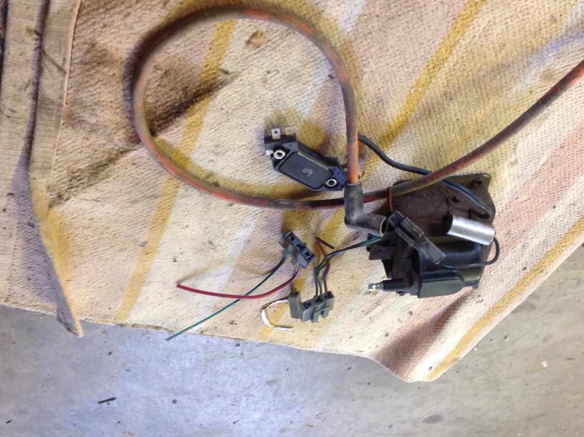

  On 7/18/2015 at 12:53 PM, tweety said:
ferp420,   what ignition upgrades did you do please?
The best "upgrade" your gunna find is something like this. Ive used it a few times on other vehicles and may be doing this to my hatch soon. It would require a Nippondenso disty or an older style hitachi with external module. This kinda rules out alot of us. Ive not tried it on one of our cars yet as the stock systems had been fine. Weve discussed this befor. If someone boasts a power increase on a stock setup from upgrading or swapping ign systems (electronic for electronic) they most likely had a problem resolved by the swap, or decided to advance their timing a bit more during the upgrade.
If you guys are interested in more info we should start another thread. This one is going so well.
