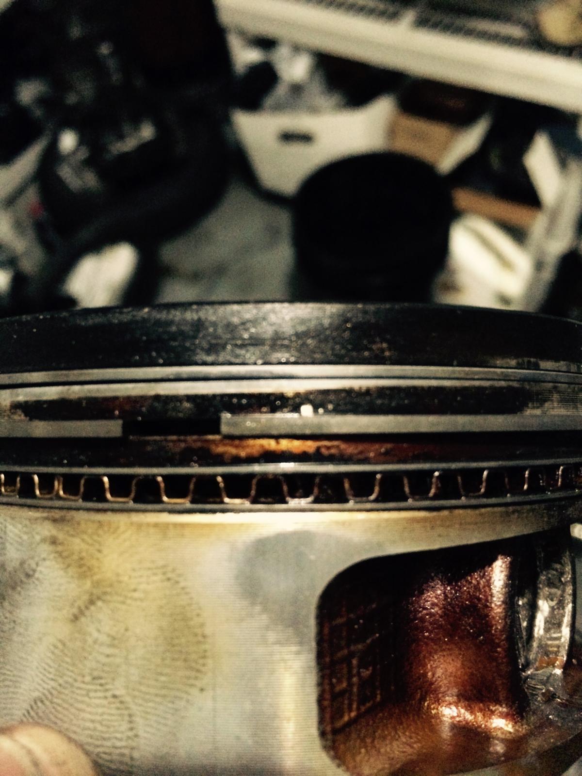

superpoo93 Posted October 8, 2015 Author Share Posted October 8, 2015 (edited) On 7/28/2015 at 4:40 PM, Loyale 2.7 Turbo said: Also, a Quart of Marvel Mystery Oil had worked great in similar cases. Kind Regards. Edit added correct quote: On 7/28/2015 at 3:43 PM, ccrinc said: Dude...please. If you have low compression in one cylinder (as you have already stated), it is NOT a "simple" external fix. It is NOT the timing, the plugs, the wires, an intake gasket or any other magically easy thing to remedy. Do the leak down test: it will point to where the problem is. To get to the rings, you have to split the block. At 200,000+ miles, you would definitely have to replace the rod and main bearings and everything else. Once you split the block, you are looking at a complete rebuild. Or a used engine. There is a small (very small) chance that your oil and compression rings in that cylinder are simply gunked up with crud. I've seen it more times than I can count. They get positively baked into the ring grooves to where they simply won't come out even during engine tear down. You can try (and I do mean "TRY") this to degunk them: do an oil change, but replace one quart of oil with one quart of Rislone (old time engine cleaner, but the stuff just works). Drive the car about 50 miles, then change the oil again. You might get lucky: at least it's a fairly cheap fix to try. This won't be a permanent fix, but could buy you some improvement. Emily Both of you called it!!!! #1 middle compression/wiper ring is totally stuck.edit** correction Edit*. It was #3 middle compression/wiper ring is totally stuck, not #1 I removed and cleaned it but there seemed to be a rough spot near the gap where it was stuck. Also even with out a feeler guage, there seems to be a tolerance issue. Very tight still... Maybe using a piston ring cleaner would really clean iout. Edited October 8, 2015 by superpoo93 Link to comment Share on other sites More sharing options...
superpoo93 Posted October 8, 2015 Author Share Posted October 8, 2015 Well now you know what I know. Sorry, it took so long to update. Oh, and by the way engine transplant was a success. Thanks to I75eya!! Magpie's heart lives on!! 2 Link to comment Share on other sites More sharing options...

superpoo93 Posted October 8, 2015 Author Share Posted October 8, 2015 As you can see tge ring is flush with piston. Link to comment Share on other sites More sharing options...
