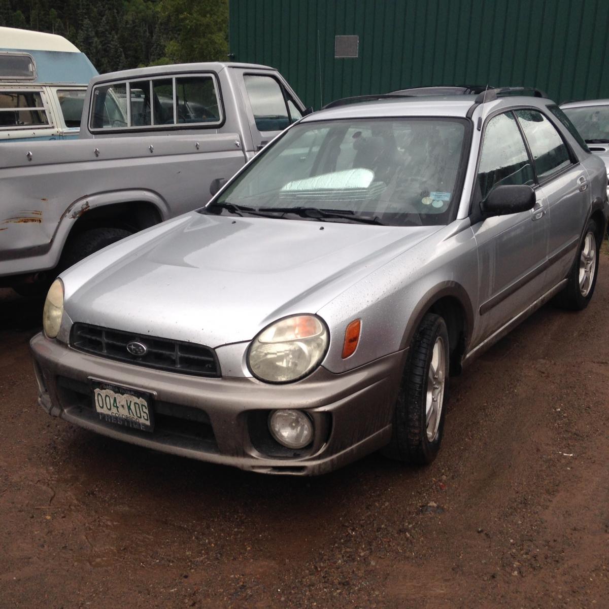

Yotanut Posted July 28, 2015 Share Posted July 28, 2015 I am new to the forum, but not subaru's. I was given a 2002 impreza sport outback that is a really well maintained 2 owner car. The lady owner keep up with all the maintenance. It has 340,xxx miles on the chassis, 150,000 on its second motor before it had a rod start knocking.i was thinking of putting a remanufactured engine from Colorado components rebuilders. Motor is about $3600. Am I wasting my time and money? Should I find a junkyard motor, or a JDM low mile motor, or scrap the car? Other than the stated the car is clean and everything else works. Any real advice is welcome. Thanks. Link to comment Share on other sites More sharing options...
Yotanut Posted July 28, 2015 Author Share Posted July 28, 2015 Here she is. Link to comment Share on other sites More sharing options...
