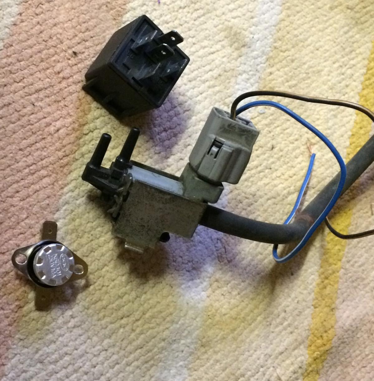

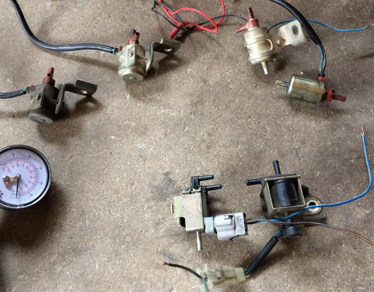

ihscout54 Posted August 27, 2015 Share Posted August 27, 2015 The problem with hunting for them is figuring out what you need. Normally open/closed etc. i have a bunch of these types of solenoids I use for various operations. I am a believer in having them operational, but you can simply bypass them with a piece of hose and see if you notice any issues. If it works out then get some resistors. You dont even have to remove the solenoid. Or get some hitachis or toyota solenoids from the boneyard. Link to comment Share on other sites More sharing options...
ihscout54 Posted August 27, 2015 Share Posted August 27, 2015 Link to comment Share on other sites More sharing options...
