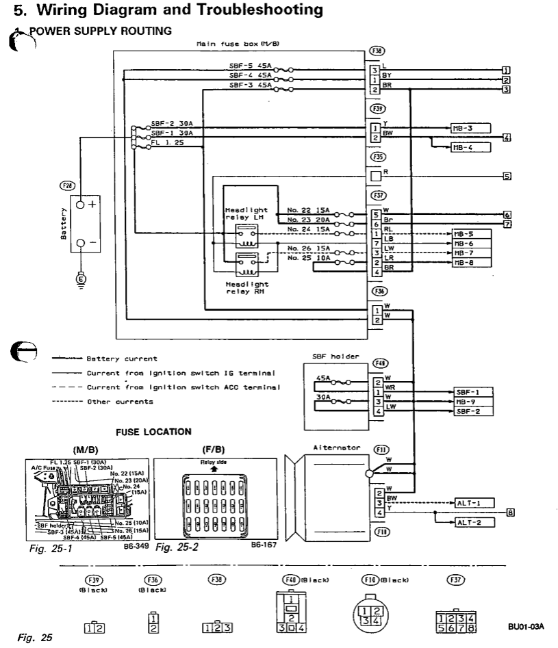

Tye Posted September 21, 2015 Author Share Posted September 21, 2015 Does anyone know how to decipher this, what does alt 1 and alt 2 mean Quote Link to comment Share on other sites More sharing options...
Tye Posted September 23, 2015 Author Share Posted September 23, 2015 I am mostly wondering what alt 1 and alt 2 mean I think the B is ground Quote Link to comment Share on other sites More sharing options...
DaveT Posted September 23, 2015 Share Posted September 23, 2015 Is that image from a FSM? I'd need to see the entire schematic for the engine electrical system to try to interpret what's what. There's too much missing in that small image. Quote Link to comment Share on other sites More sharing options...
Tye Posted September 23, 2015 Author Share Posted September 23, 2015 Is that image from a FSM? I'd need to see the entire schematic for the engine electrical system to try to interpret what's what. There's too much missing in that small image. yes it is from a 1992 Subaru legacy fsm Quote Link to comment Share on other sites More sharing options...
ford'ssubaru's Posted September 23, 2015 Share Posted September 23, 2015 Judging by the schematic and the legend. W is constant battery voltage. Y is your ignition battery voltage or excite wire. BW sais other current....... Try leaving that disconnected. Quote Link to comment Share on other sites More sharing options...
Tye Posted September 26, 2015 Author Share Posted September 26, 2015 Judging by the schematic and the legend. W is constant battery voltage. Y is your ignition battery voltage or excite wire. BW sais other current....... Try leaving that disconnected. so i did have it right the alternator from Napa, was another bad one this time i got one from Oreilly it was good and fixed the 18 volts problem thanks everyone for all the help 1 Quote Link to comment Share on other sites More sharing options...

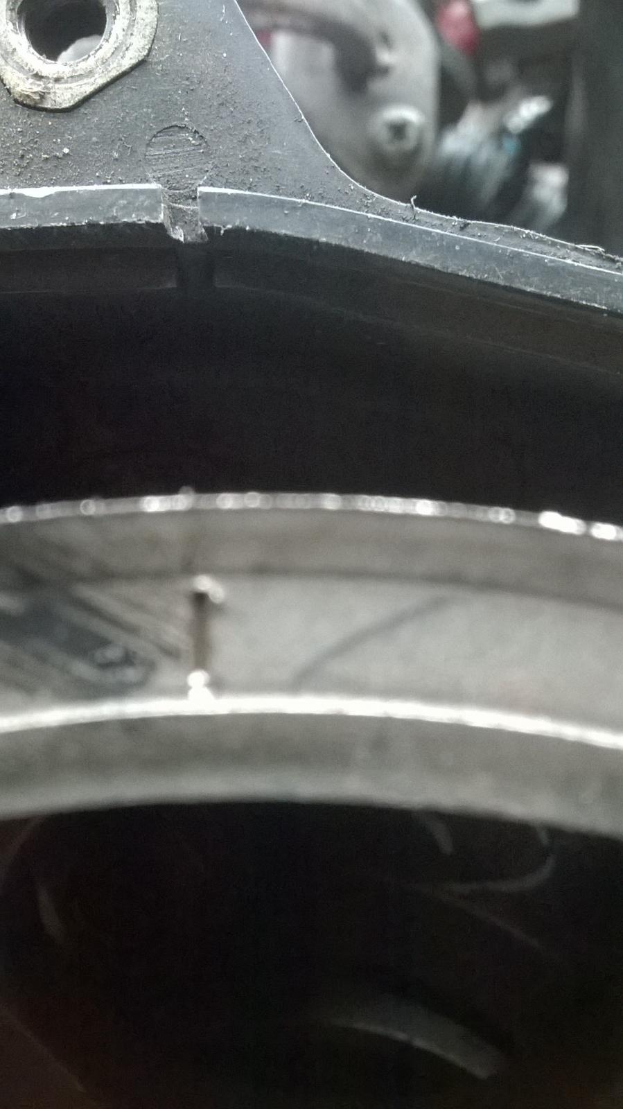

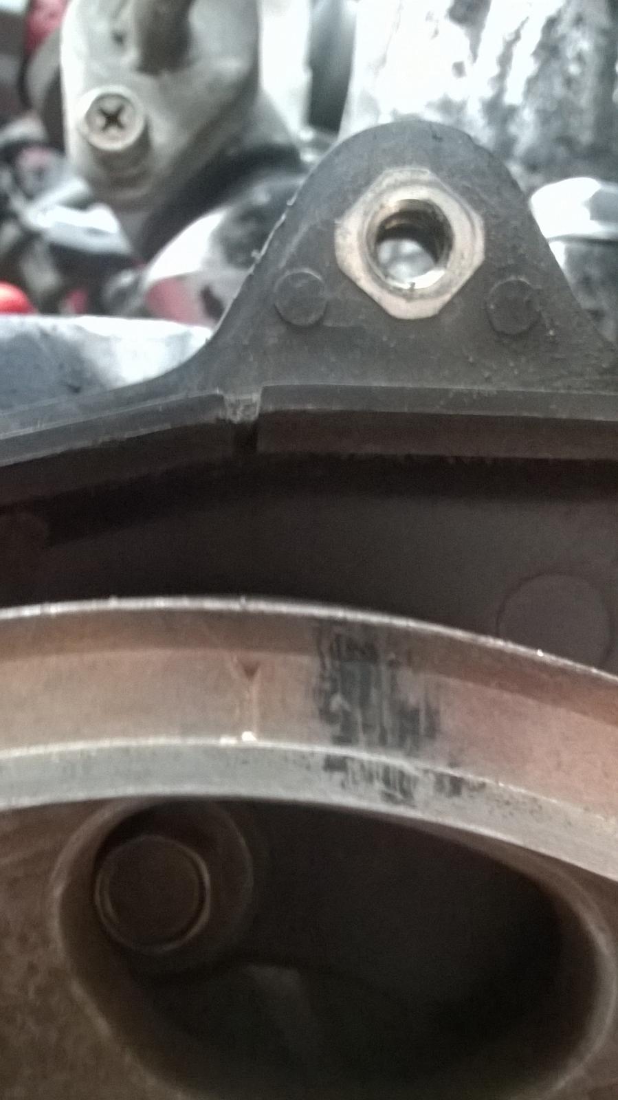

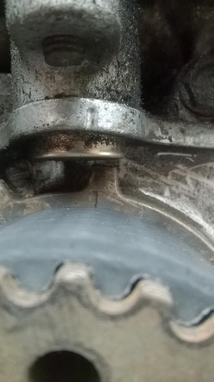

Tye Posted October 10, 2015 Author Share Posted October 10, 2015 (edited) OK this is where I am at right now. I replaced the knock sensor and had the fuel injectors rebuilt, although their is still a lack of power.its indeed most likely the timing belt From looking at it, the timing belt doesn't seem off. here are some pictures of the timing marks, They all seem to line up Edited October 10, 2015 by Tye Quote Link to comment Share on other sites More sharing options...
