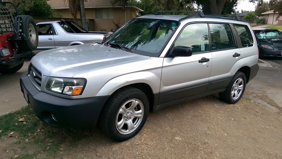

Sonicfrog Posted September 29, 2015 Share Posted September 29, 2015 (edited) Hey everyone. Sorry i haven't been around for so long. I FINALLY got a teaching job, and I'm busier than heck!!!!I just bought a 2005 Forester with 141K miles to commute back and forth to work, and I have a few questions / problems.First... The problem. The original key fob doesn't work. There is a second fob that does sort of work. It will make the lights blink, but it won't lock or unlock the doors. The doors do lock / unlock using the button on the inside. Note that I discovered the previous owner removed the relay that controls the horn.Any ideas?Next, I would like to change out the instrument cluster back-lights to white LED type. What kind of bulbs does the dash use? .I'll have more later, but I'm starting with this. Edited September 29, 2015 by Sonicfrog Quote Link to comment Share on other sites More sharing options...
