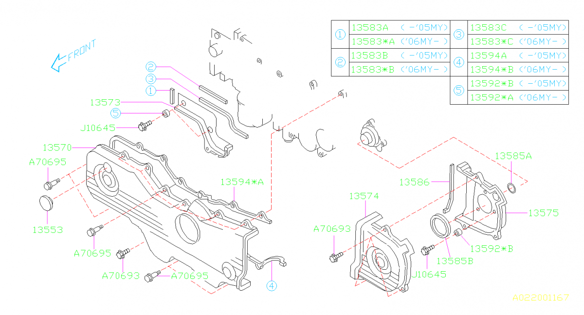

LD111 Posted October 5, 2015 Share Posted October 5, 2015 I see on the Subaru parts website there is seal inside the DS cover that goes behind the cam sprocket. I have the oils seal 806732150 in the head and there was a small foam/tape gasket on the outer backside of the timing cover where it sits against the head. I don't have any other seals. The FSM doesn't reference it. Somebody else took the timing belt and covers off. There are no pictures, just drawings of this mystery part. Does anyone know about it or what it is? Link to comment Share on other sites More sharing options...

LD111 Posted October 6, 2015 Author Share Posted October 6, 2015 I don't see anyplace on the inside of the back cover for another seal to go. I guess I'll run without it. Link to comment Share on other sites More sharing options...
logic23 Posted October 7, 2015 Share Posted October 7, 2015 The foam seals go around the Cam sensor and the cam protrustion on the head are dust seals and not super important in the bigger scheme of things. Link to comment Share on other sites More sharing options...
