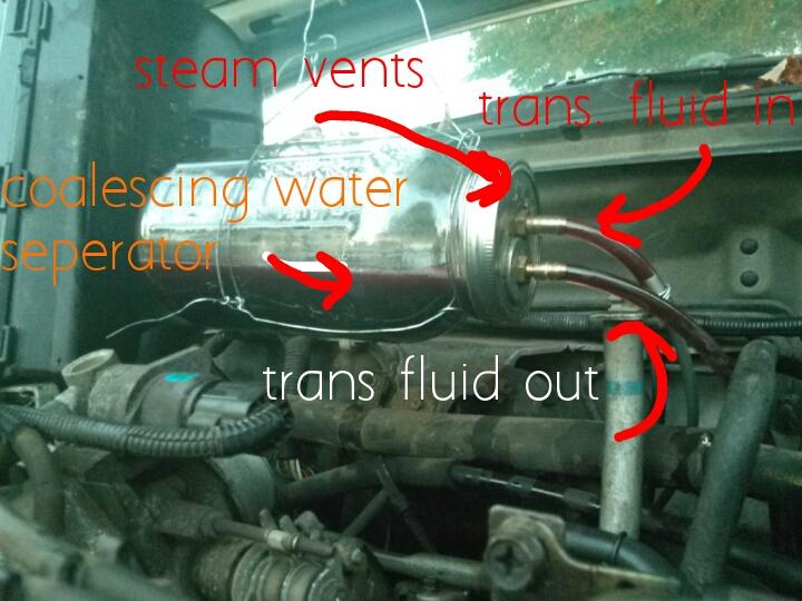

bjjohns Posted October 14, 2015 Share Posted October 14, 2015 2001 Subaru Forester. I changed the engine. Because I was a stubborn idiot, I screwed up and pulled the torque converter with the engine (Yea, don't do that). I do not have a garage, and I left the converter outside uncovered for a couple of weeks. Got new to me $150.00 junkyard engine with 62K on it installed no problems. New oil, new plugs boom running. 100 miles in and my car start smoking heavily and catches on fire. I pull over, pop the hood, put out the fire. Oil is pouring out of the vent tube coming from the top of the tranny. I tow it home, change tranny oil & filters. Fill it back up. Warm it - all is fine. Drive off and within 3 miles smoke starts pouring out again. I've completely changed oil twice (thinking there is water trapped in the torque converter) and still this is happening. I created a air/oil/water separator that lets me run it kinda ok, but I till have oil coming out that vent. Anybody have any thoughts? Bill J. Ohio Link to comment Share on other sites More sharing options...

bjjohns Posted October 14, 2015 Author Share Posted October 14, 2015 that would be a welcome idea(easy to fix) - but it's actually easier to underfill - that's why you have to check that fluid with the engine idling or it will show a level 2" higher than required. It IS important to remember - you can only drain about 1/2 the total volume. Might need to check the radiator - maybe coolant pressure pushing coolant backwards thru a hole in the trans cooling coil? It's theoretically possible I guess, just never read a confirmed failure like that. Or, is it possible trans fluid is being put into the front diff and it is puking? Doesn't seem likely - maybe the trans pump got cracked - easy to do pulling the engine in that last 1/4" from what I have read. It must slide together - if you pull it together with the bolts, something will break inside....? I Don't think it is going into front diff, no overflow from it's vent. I did check flow through tranny cooler, but not pressure. I don't believe the radiator and the tranny cooly physically connect, I think the tranny cooler is just a air cooled fin assembly, but I will check - I haven't looked at it that close. All that being said, I have popped the front diff dipstick while running down the road since this happened - That tells me I am over pressuring it some how. Are you finding water in the fluid? If you're still finding water in the trans fluid there could be a crack in the ATF cooler in the radiator as Texan suggested. All the fluid in the converter gets flushed through within a few minutes, so it will fill within about 30 seconds after starting. Then the fluid level in the trans has to be checked again after moving through all gears. I am still getting a little water - very little water in the oil. I am thinking that because the torque converter spins, and the oil sits on top of the water, I have a permanently trapped bit of water in there that is not coming out till he heats up. Then it boils, foams the oil, and makes it go out the vent. The trans vent, or the front diff vent? All of the oil is coming from the trans vent. The front diff vent is clear, breathes fine, and shows no oil. Attached pic is how I am separating oil, water, and steam when parked. Pretty hillbilly, but is working. Link to comment Share on other sites More sharing options...

bjjohns Posted October 14, 2015 Author Share Posted October 14, 2015 (edited) so, no loss of coolant? the trans is cooled by a coil in the radiator bottom 'cap'. (unless someone has modded the car) if you let the car sit and pull the trans drain plug - is there water/coolant coming out first? I've not noticed any water on the second or third oil changes I did, I din't think to look on the first one. There really isn't much to "Change", At this point, if I don't run my "separator" (which puts the overflow back into the transmission oil dipstick tube) I will lose 1 gallon of oil in less than 2.5 miles, nearly emptying the transmission pan. When I pull the cooling lines from the bottom of the cooler, I get foamy oil with a discoloration that indicates the presence of water (which is what started me down the water path). I'm going to pressure test the tranny cooler tonight. Edited October 14, 2015 by bjjohns Link to comment Share on other sites More sharing options...
