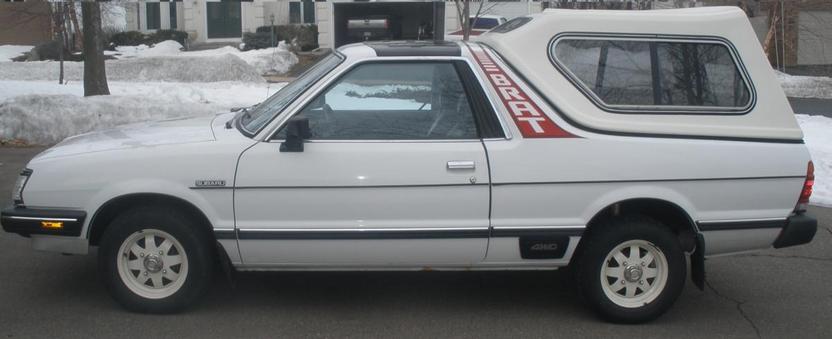

franbev Posted October 29, 2015 Share Posted October 29, 2015 I have a 1985 BRAT with the stock wagon wheels. The bolt pattern looks like 4 x 100 with a FWD offset. Is that right? I want to get some wheels to replace mine while I mount new tires. It's winter here now (Minnesota)and this car has never seen snow so just driving it in isn't an option. Link to comment Share on other sites More sharing options...
Rust Posted October 29, 2015 Share Posted October 29, 2015 http://www.indysworld.com/80s/general/wheels/wheels.html Link to comment Share on other sites More sharing options...
musubk Posted October 29, 2015 Share Posted October 29, 2015 They are 4x140mm, which are almost impossible to find in anything but 80s Subarus. For that reason, a lot of people either swap to 5x100mm hubs, or redrill to 6x139.7mm and use truck wheels. Link to comment Share on other sites More sharing options...
