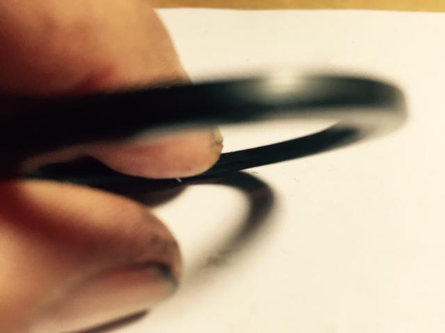

steve56 Posted November 16, 2015 Share Posted November 16, 2015 I'm resealing a 1997 ej22. The coolant crossover pipe o rings are flat. Are the supposed to be like that or are should they have a curved mating surface and these should be replaced. Link to comment Share on other sites More sharing options...
Mikevan10 Posted November 16, 2015 Share Posted November 16, 2015 I had to service that pipe on my '92 this year and I replaced those O-rings while I was at it. I am pretty sure they were round in cross section (like an O-Ring should be!) but to be brutally honest, my memory is shot and I don't clearly remember! But the bottom line is, they are not expensive and my opinion is that this is one of those cases where you really should replace them "as long as you are in there". You will kick yourself if they leak after you reassemble all that stuff. Link to comment Share on other sites More sharing options...
Fairtax4me Posted November 16, 2015 Share Posted November 16, 2015 They're supposed to be round. Definitely want to replace those because its alot of work to have to remove the manifold again just to fix a leak around one of those o-rings. Link to comment Share on other sites More sharing options...
